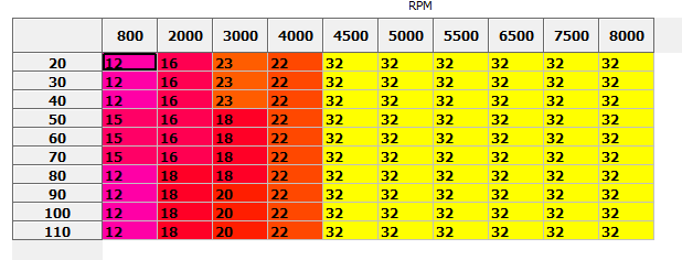

had the mini set up the last month on the RR but dont understand why the map has been blocked out at 32 degrees on vacuum, when all the other maps i have seen dont.
My Map:
mini runs really well and produced 106 bhp on a n/a

Does look a bit odd. I don't know why the RR would fix the advance to 32 above 4500 RPM? Who's rolling road did you use and could you give them a call and see what they say?
Saying that 106 is a good power output, Is that's definitely the map currently flashed to the MJ?
theres a simple reason for this,
they either don't have a clue what they're doing, or cant be arsed to do a proper map!
basically they have run it up to peak, played with the timing there to get peak power and though fuck it that'll do, exactly the same as if it had a dizzy.....
what they should do is hold the speed at each load point and adjust the timing to suit.

thats is the map out of the MJ, the map was playied around with at lower revs as there was a lot of chocking around the 2000 to 3000 mark.
it was set up at minisport, the mini does run fine and produced good power and torque for a n/a 1330.
new to MJ so was unsure on what was really going on, only really noticed when i got home and compared to other maps.
may look in to getting it fettled but where is a good RR as from bolton (Lancashire *smiley* ) go on i've let myself in for it now (whippets and flat caps posts)
It seems that the RR guy has done probably what he was paid to do. Get maximum power and a car that runs well.
As you say he messed around with the lower end, which will make the biggest differance to driveability. If it drives well he has done a good job.
What he hasn't done is whack in a load of advance for the cruise section of the map (part throttle, vacuum mid rpm).
To be fair, most of the 32s are in a bit of the map that will never be used. I'd be tempted to go for a drive and see what bins you are in at cruise and stick in a load of advance.
I would expect to see a heap more advance at cruise,
at 3-4000k and 60-80kpa I'd expect more like 30 degrees advance or more,

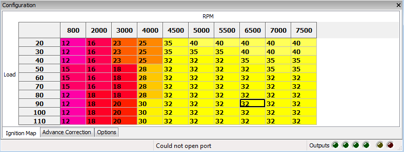

going to give the mini a run with a slightly revised map.
added some advance on over run as per all maps i have seen and added a little on the 4k mark across the board.

been for a run with revised map and i'm glad to say no real issues *smiley* sat on the motorway at 3800 rpm around the 60-70 kpa make with about 28 ish degress advance. seems to run smoother than with 22 as before.
as for performance no real change as still set at 32 and altering the 10-40 kpa range at high revs to 35-40 degree no issue.
lol
yes, extra fuel and a late spark is basically the idea of antilag.
cool, that extra mid range advance should get you a few more MPG's, you might be able to get a few more degree's in there, but it's dependant on engine spec, I think Ive run about 37-38 deg in that range before, but thats on a turbo motor with lower compression ratio.

was thinking of stepping it 30 but lappy went flat (school boy error) motor has quite high compression as pistons are 10:1 but benross has built the head with different chamber size so may be a little less.
seems to run fine though with no keys jangling :) thanks for the advice joe / brett
may add another degree on the 90-100 kpa from 5.5k to 7.5k and see how its feels

dont go mad with it at 90-100k as thats were the det can get you, and to be honest you probably wont feel the
difference if there is one.

thats probably what happened on first outing as had about 35 in up there *surprised* so on your advice i'll leave it at 32.
tbh i'll prob leave map as it is now, as mini seems to run sweet, and checked all plugs and all is looking good.
