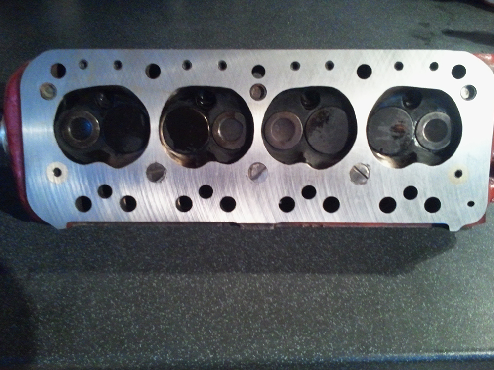

one option is to use set screws ( grub screws)
it takes 20 size M8 ( 10 in head 10 in block)
and you may need to make the centre 3 you need 3x M16 for the block and 3x M18 for the head
i loctite them in place with 270 grade ( no idea what that is its ex mod stuff)
i have done this on 2 separate engines and a total of 5 heads with no issues
this method you dont need to have the head or block skimmed and can be done with the engine in place with just the head off, you just need to make sure everything sits just below the block/head face

you can of course just do one side, i think this is what TurboPhil has done, and my head is only partially blocked up the block is however fully blocked
ignoring the plenum you can see some bungs in my block and also the side with the take off in the core plug
plen_restring by lilpinkiy, on Flickr
and here
drydeck_mount by lilpinkiy, on Flickr
get your head done
head mk2 by lilpinkiy, on Flickr
tada..... cut hose down so dont look to much like a crazy sex toy sticking out your engine.
dry_decktest by lilpinkiy, on Flickr
