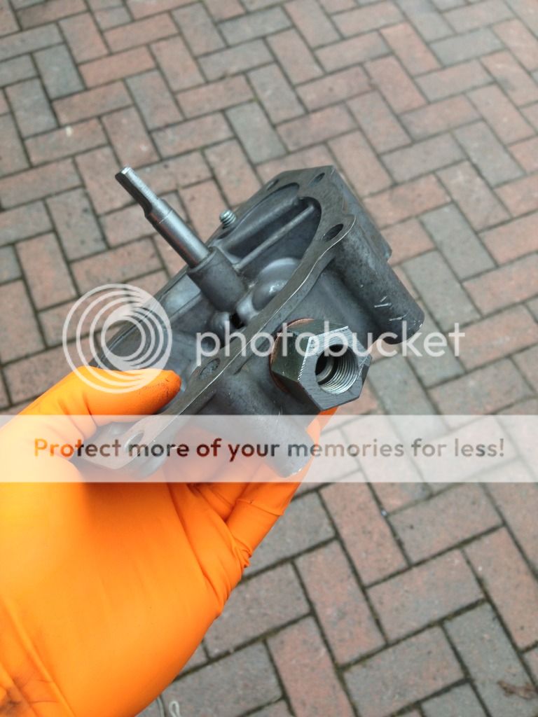

The link for the adapter i used is below. It shares the sump plug thread size, so 5/8 UNC. I had to grind it down a little to get a decent seal on the sealing face. I plan to put this on the edge of the speedo housing, as if inserted from the front of the vehicle, where there is a flat face. I'll post a pic when it's done later this week hopefully.

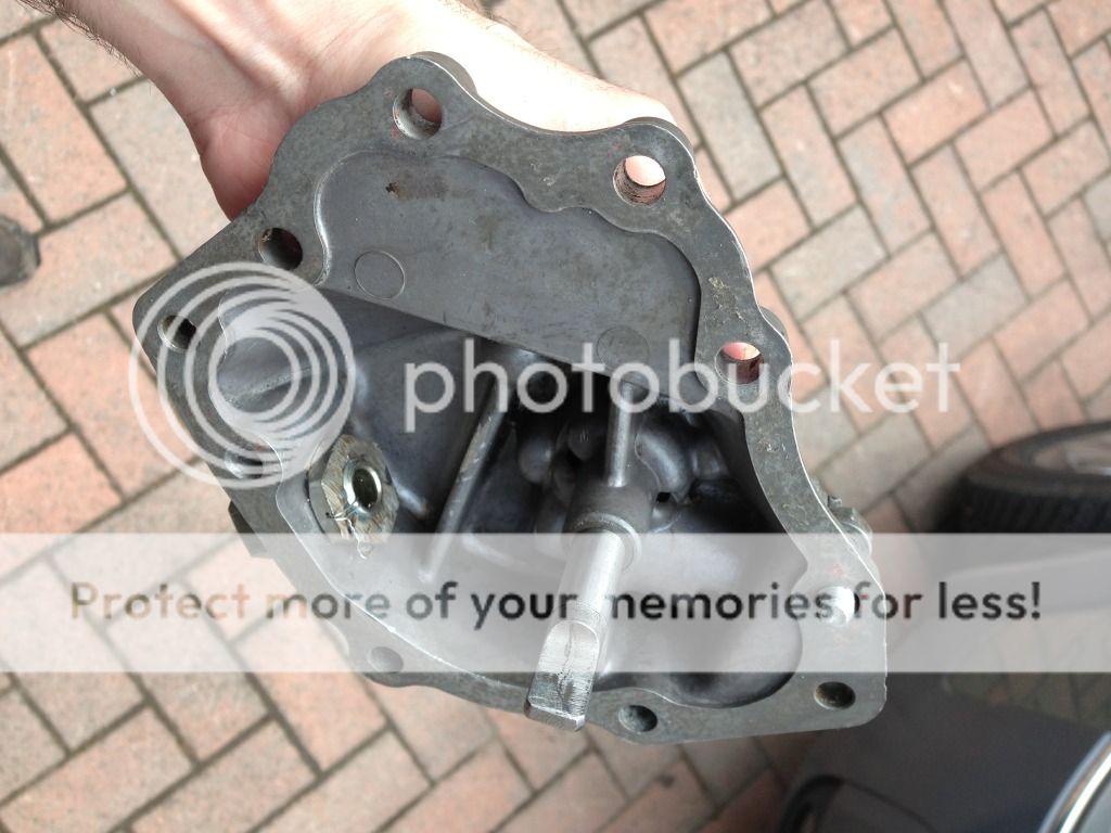

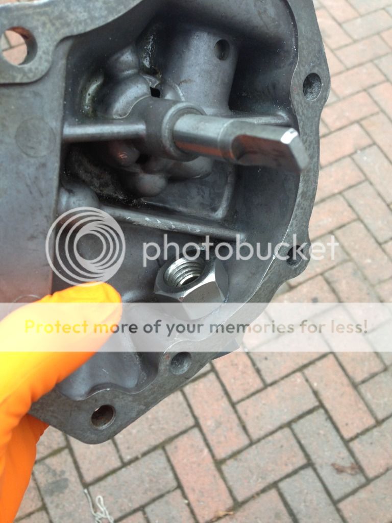

Here is mine. Used a nut on the back face because the speedo housing is only 4mm thick. Also some silicone sealant in the gap and thread lock and a big spanner! Hopefully will do the trick.
My build thread: http://www.turbominis.co.uk/forums/index.php?p=vt&tid=440970
i would hate for that nut to come out :(
Just what I was thinking!
You'd be better off machining some of the hex off so the threaded section pokes through further, and make sure the nut sits flatter on the inner surface so you get a true measure of when the nut is tight. As it is now, with that nut not sitting flat and only on by a couple of threads, relying on locktite could end it tears.*oh well*
In an ideal world, welding a lug on would be the best bet, but the way you have would be fine if you have more thread poking through and a nyloc nut or wired nut.

The nut is flat, it's the chamfered edges causing an illusion. Points noted though. Perhaps I will disassemble and try again.

Second attempt. Shortened the nut and wire locked. Thanks for the advice guys.
