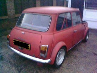

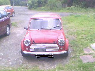

After 7 years of not being bothered to fix the gearbox...:)
sc box,sc transfers,Xpin diff. - 2.9 ratio.
light steel flywheel,race clutch,gray plate.
homemade head - MG valves,guide bosses removed-ported-chanbers opened slightly etc etc.
genuine leyland 649 cam - was found unused in the original bog roll (blue+white striped) tube from the early 70's in my mates shed a few years back *happy*
std turbo + rover diesel intercooler + cheapo aftermarket dump valve.
spax coil overs,vented disks, blah blah blah.....
So out with the paint thinners and ill be racing the bikes down the cat and fiddle again? havnt they put up speed traps now :( ???

a pre-restoration pic from last year *happy*

duuno my current power...never seen a set of rollers!!! shes a 1275, 649 cam, locked off dizzy and 0.8bar *std* boost setting at the mo. A pig to get off the line with the 2.9 diff but f**k me backwards with a chainsaw when the cam and turbo decide its time to start to play you better hold on very tightly !!!!!
the 649 cam is similar to the STR930 cam if I'm not mistaken and this was the regulation cam in the turbo challenge cars I think.
don't recall the general output of these engines but I know jon flan was getting 150bhp ish out his very well sorted unit
