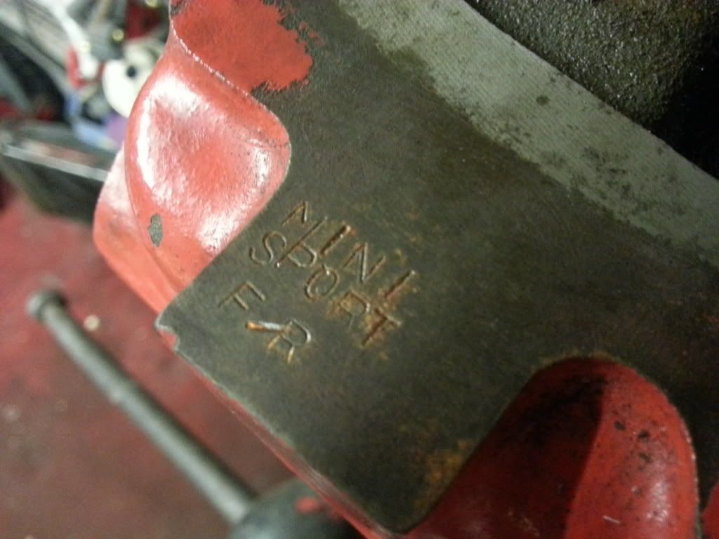

As Andy said, if the head's been skimmed a lot it may not be possible to get the chamber volume you require. Usually the heads are stamped with the chamber volume after the work, so have a look & see.

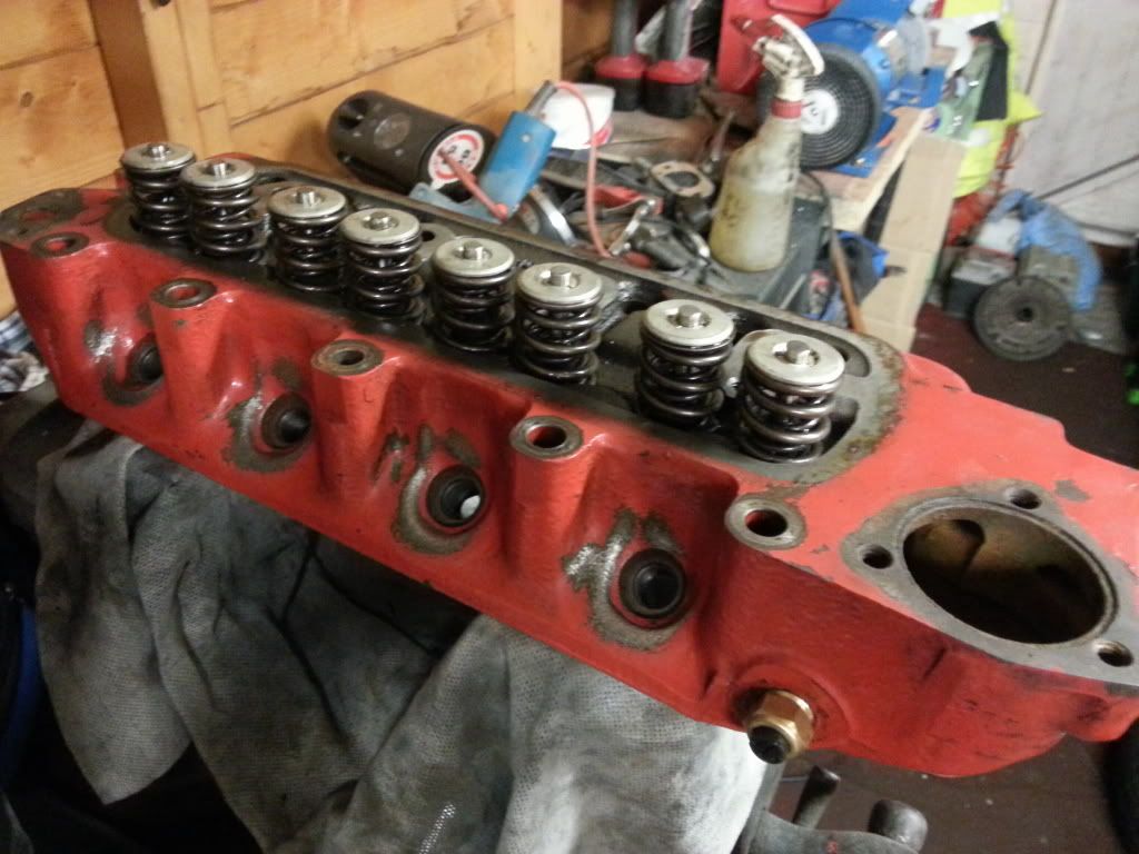

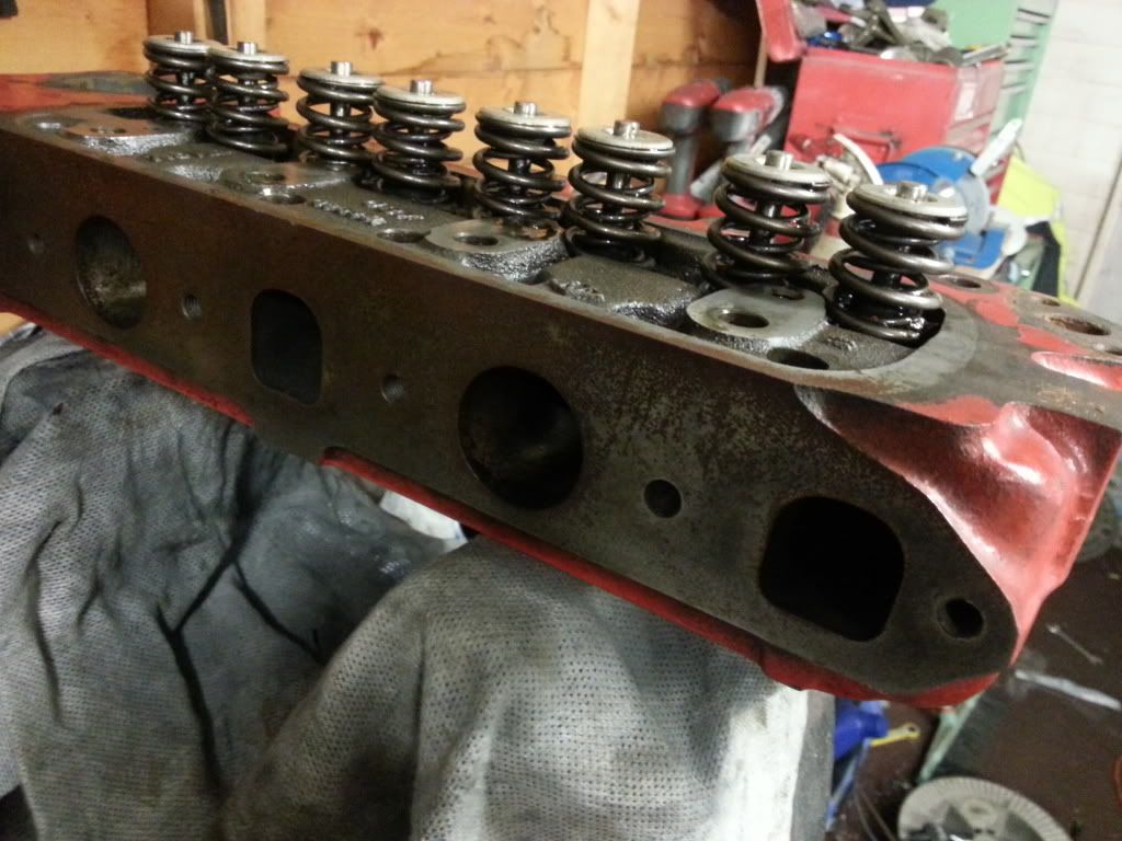

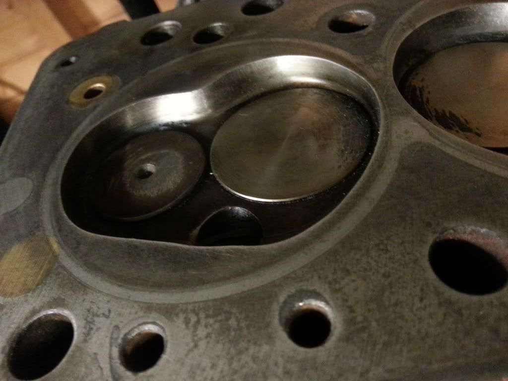

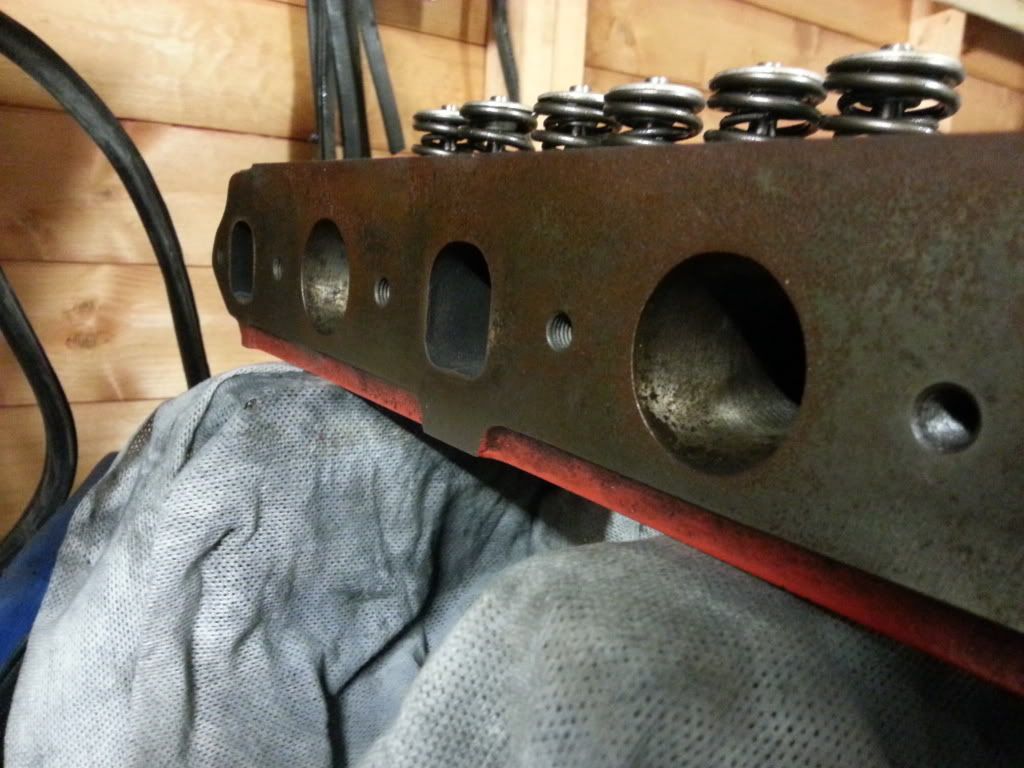

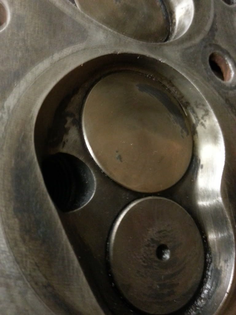

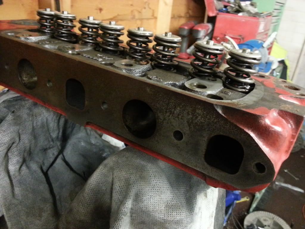

Ended up buying this chaps, paid less than 3 figures so i wasnt too fussed if its not suitable anyway!
heres some pics anyway, just wants a good clean..
welshdan
2096 Posts
Member #: 1111
s wales
Sounds like a good buy for the price. I would work out the chamber cc and think about some +20 18cc pistons to get the cr down for turbo use...
