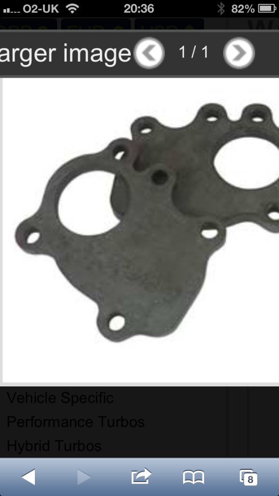

Can somebody please help me find or let me have the Cad drawing for the Renault 5 Turbo exhaust flange. It's the 5 bolt flange same as mirage. but different to most T25's.
I've been waiting 4 weeks for my local laser cutters, to draw up and cut me a batch of flanges in stainless for my 7 port project. I was told today they still havnt been done and they can now only do mild steel.
Can't find any where that's sells the flange In stainless. Paul S as no stock and Isn't willing to share the file.
Anybody got a spare flange kicking about?
Please help, this is really holding me up.

It's this exhaust flange am after

How soon do you need it? I have one in the shed I can measure and draw up (I've got a student copy of CATIA V5) and put on the forum?

By end of week would be good. I'm on holiday soon, and would like to get downpipe, tacked and Tig weldered by mid July, ready for Mini in the Park.

does this help
http://www.turbobygarrett.com/turbobygarre...541_1_4_new.pdf

Unfortunely not, this is the T25 flange, with different stud placement.

Here's what I've come up with, I'd print it on some card first and check all the stud holes line up first. It looked fine on my T2 though.
The picture is a jpg of the file, I've attached the proper drawing file, and if you need the actual model then I can send that as well.
EDIT: The attachment doesn't seem to have worked, but if you pm me your email address I can send you the files. If you need any modifications making (like a different shaped internal hole let me know, it'll take 5 mins to change.

Thank you, you are a lifev saver. I owe you a beer or two. Pm on way
