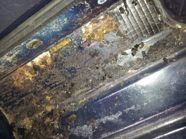

This is the passengers foot well. I chipped off the sound deading to reveal this after i prodded it loads with a screw driver and had a good poke. You can see the orange sticker from the new panel thats been put on. From the looks of it they have cut the outer sill over and slapped a pair of over sills on i think.

A close up of passenger foot well.

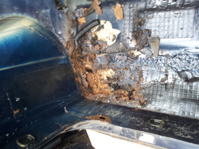

This is on the passenger side behind the cross member, same sketch as the other pic. Oversill put on or new outer put on, but the inner hasnt been done.

Pic from inside the rear bin, can see the sticker here.

Take the over sills off and fit those 1/4 floor pans with the sill already attached.

I was reading up last night, and it confirmed they were over sills because they dont have the vents. I thought they looked suspicious. Best order myself a grinder so we can start hacking the shell to bits.

Good plan, saves messing round. Just make sure you brace the door opening and floor before you lop it all out.
Looking at the photos, i'd anticipate you'll need the step sills as well
