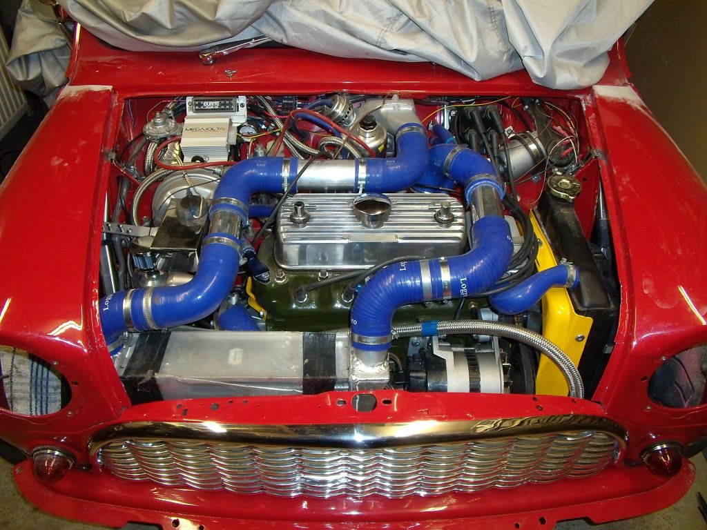

This was my sons setup, before he took it to bits again. The intercooler was rapped up because he was working on the front end of the car.
