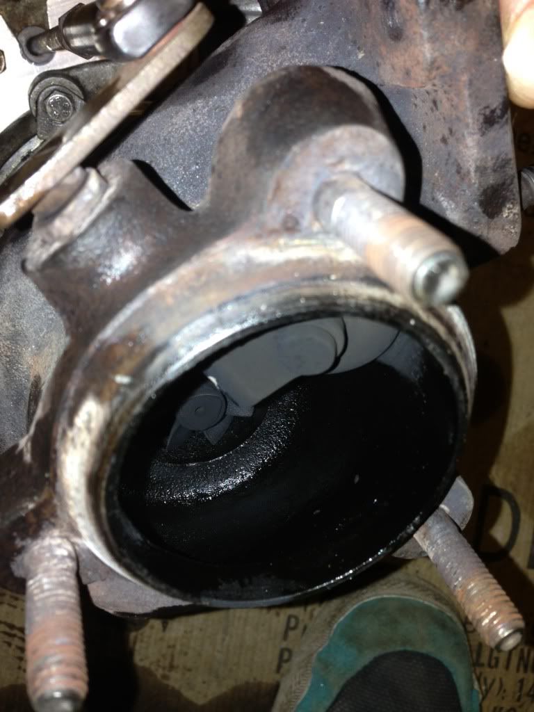

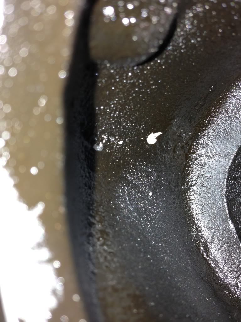

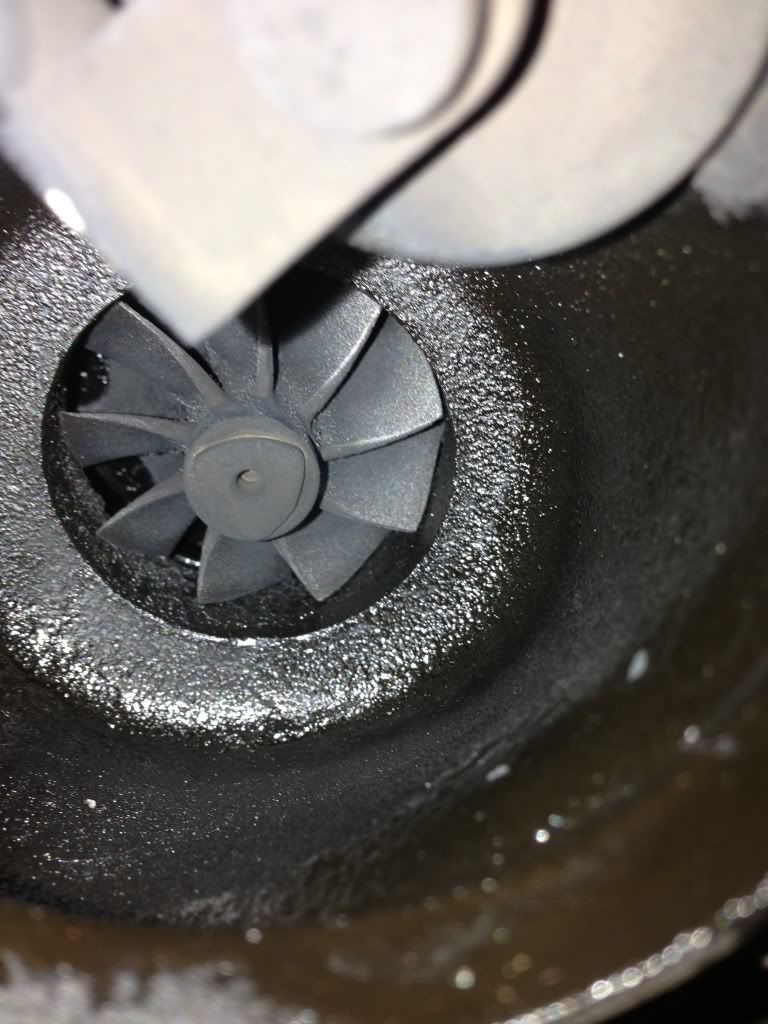

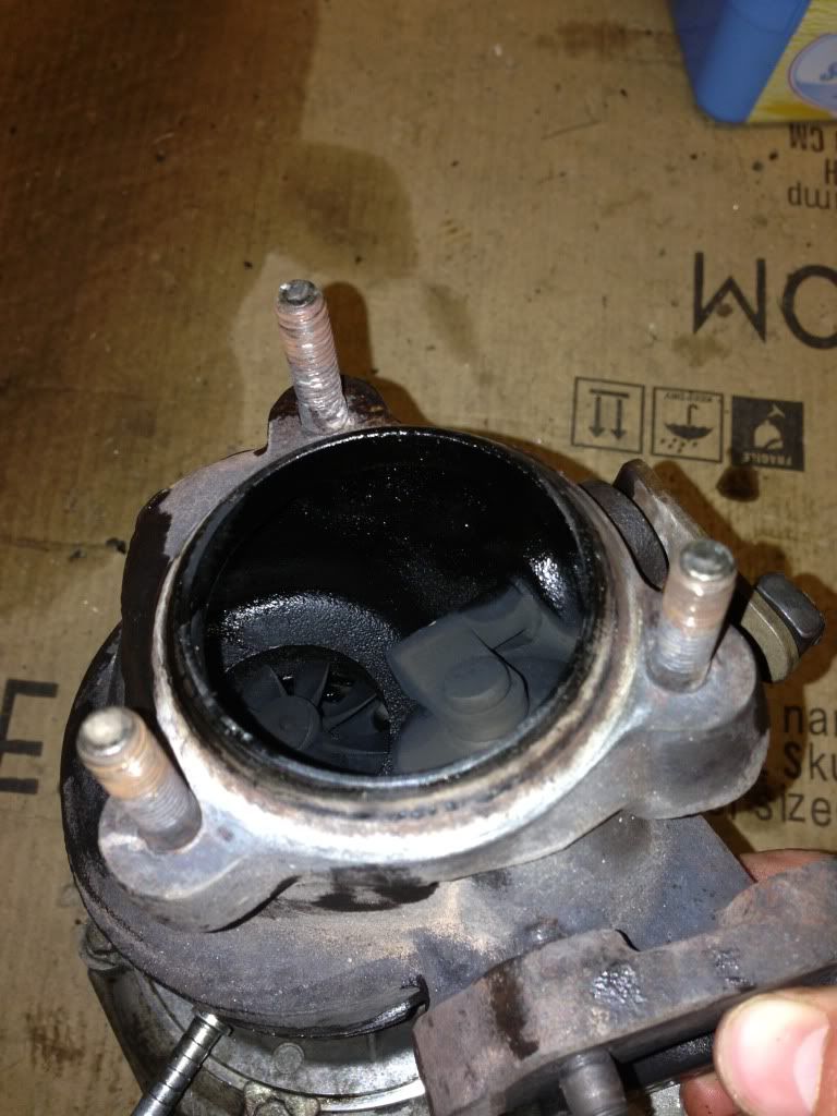

So I took the turbo off it felt oily in the inlet and looked black and wet in the exhaust housing. These are the best pics I could get.
So we still think its turbo oil seals?
I have been quite by midland turbos in Nottingham for a quick rebuild they could do tomorrow in a day so could hopefully have it back quickly.
Any oil upstream in the ports of the head? If not then it's almost certainly the turbo.
that much wet oil in the turbo housing almost must be turbo seals, if that was coming from the engine you would feel / hear something wrong and almost certainly be down a cylinder

Nothing in the pipework or inlet ports. The inlet ports are a little greasy but clean. The oil in the exhaust was running and black.
what about exhaust ports in the head, turbo manifold?
still bet it the turbo..
on the first & second to the last pic you can see oil in the turbine "inside" where the oil seal sits, thats the give away, andy give us a pic of the ar exhaust housing inlet from the manifold
ask the guy at the turbo rebuild shop to give you the prognosis of the problem/problems with the seal & bearing, shaft etc ............ andy
