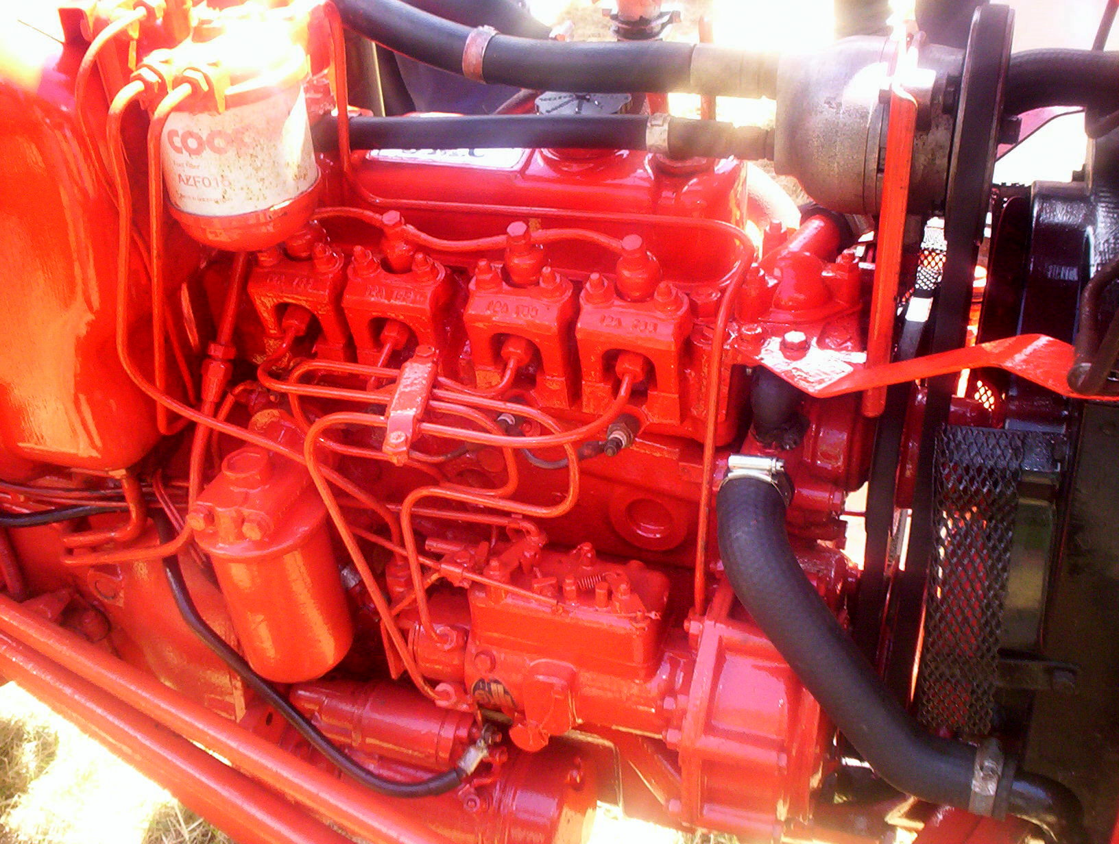

was thinking about doing a turbo diesel mini using an old a series diesel tractor engine (BMC?)
but didnt suit the mini cabrio lol

Plus they dont exactly grow on tree's.
I reckon a std 998 bottom end should hold up okay ish, its the head thats the tricky bit.
Joe, I think it's the diesel bit that's harder than the head.
Common rail injection (with a VNT turbo) if you want performance and the only person on the forum to understand diesel injection is JK and he doesn't vist much more.
Well I did mean basic old school diesel, timed pump ect.

eBay search ; 171066852364
That's a 1100 a series diesel set up
From the marine range which would be good for the head etc.
£150
Reading up on RTS Clutches
that looks petrol to me? the diesel A series i have seen inject through where the spark plugs would be
was on here a while back
