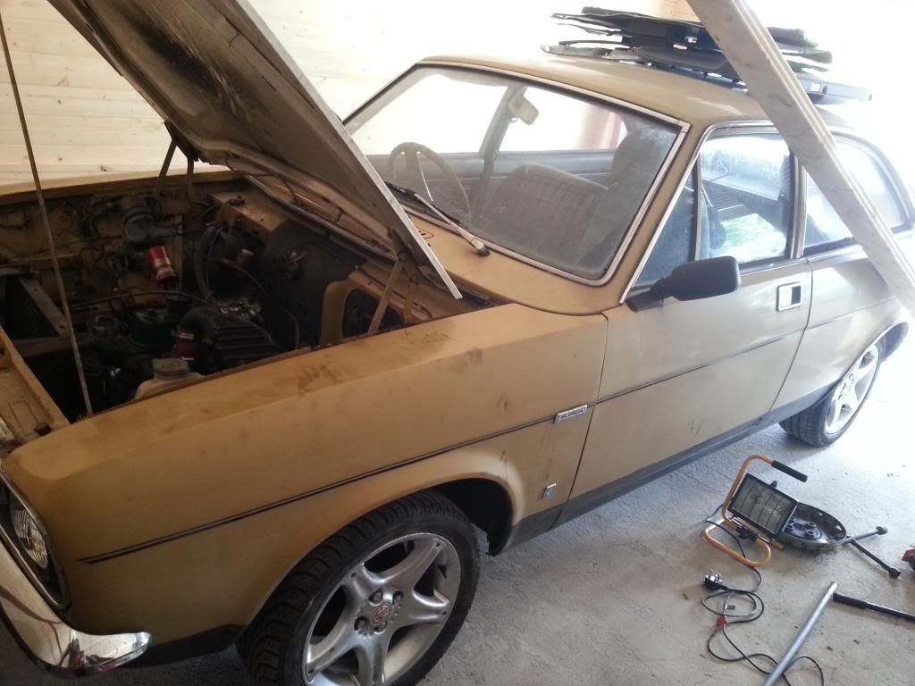

I have built a turbo marina using van pistons, etc etc etc and I am currently using an xr3i brand new fuel pump and a brand new malpassi fuel regulator, I have connected all up and the carb is flooding the engine straight away, so I snapped the tyre valve out of an A35 wheel, stripped the rubber off the brass middle, carrot style, chucked it in my tyre pump, put a jubilee and a pipe on the end, t pieced it into the pipe from regulator to the carb and jesuuuss, 25psi, no wonder my sparkplugless engine is jetwashing the bonnet with petrol!!!
Am I doing something wrong? I have wound the screw all the way in and out and it makes little difference, it sort of does nothing and then for about 180 degrees of turning it fine tunes the pressure between like 20 and 25psi, I ran the pump directly into the tyre pump and it still says about 25psi. Have I got a dodgy fuel pressure regulator??

Pictures, pictures! I've dreamt of building a high powered turboed Marina...

MGF Alloys, MK3 Disc brakes up front, Ital A+ Block, low compression van pistons, metro turbo head and valves and HIF44 carb and t2 Turbo.
