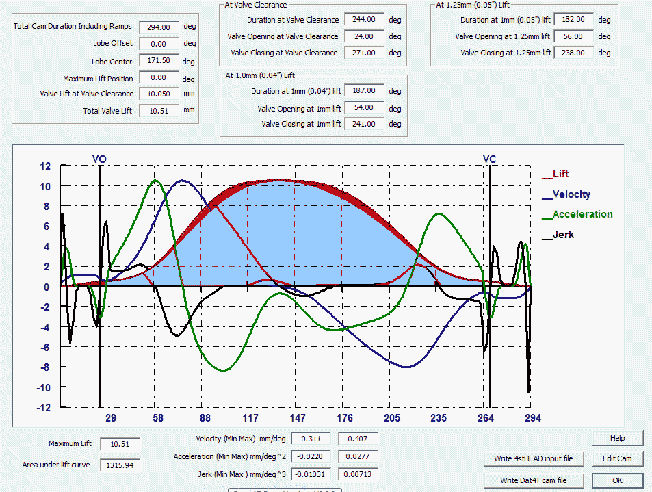

Why do you reckon the 276 is better than the 266 ?
It is very hard to compare camshafts just by looking at the numbers to be honest
you can have a cam that is 100% identical on paper that is totally different in actual lift profile (the 276 was apparently just a numerical mid way point between the 266 and 286 and not really developed like the other two )
just to illustrate . same numbers two different profiles. difference is that one of the cams has 30 degrees of dwell
My limited experience (NA) with the 276 was tepid at best.
Edited by Sir Yun on 9th Jul, 2013.

The 286 will be utter shit. Stick with what is proven to work, forget everything you know about what works well on N/A because this doesn't apply to boosted engines for cam selection. Sw5, Mg metro, 266, avonbarphase 2. Take your pick from those, those are the most used cams on here for a reason!
I'd easily take the one with the least jerk.
Goes without saying really...
