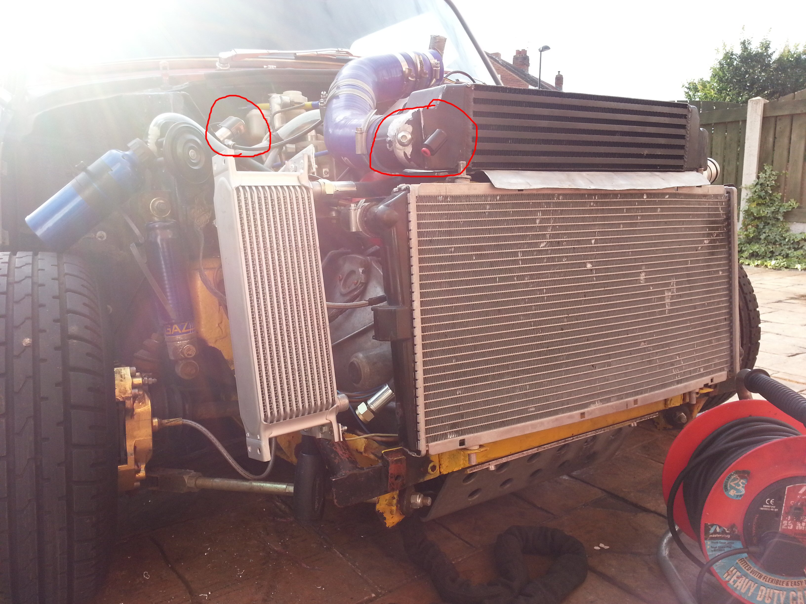

here is a pic, you can see one of the the injectors and the control valve, i had this wired up to my ecu and had it running on a map like a fuel injector good results imo
Hp boost = non
a cleaner and slower burn yes
its a tool you can use to gain power, it will only give you power straight off if your intercooler is useless or your fuel is crap
using it as a tuning aid brings lots of gains BUT you when your water is used up your engine wont be far behind it
i would suggest having a good read up about it
good starting point

it cant cool the intake unless its already too high, and it is like running a higher octane fuel but here we are talking about 50 year old engines running carbs and clockwork dizzys, they need to be settup to run at the best, they cannot react to the real world never mind anything else, to get the most out of WI you need to run the engine beyond its limits for that you need technology and knowledge you also need to accept the fact that if anything happens to the delivery of the water the engine will be damaged

I'm using it, but haven't had much of a chance to fiddle with it.
As Brett says. You will not make any more power unless you change other stuff. Turning the boost up, adding ignition advance, etc.

i have it as a bit of a det preventor for running abit more boost than normal
