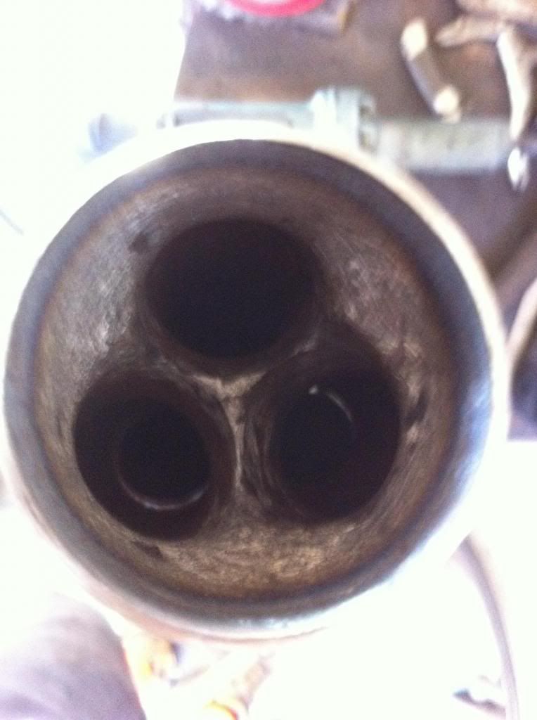

im mid way with making my side mount turbo atm just following what others have done and also trying new things

Got to admit the first thing i thought was trombone lol. Could those runners be shortened by a bit? Would help improve turbo response by a lot!
Nooooo! keep them long and wrap them!
Is there something i haven't read about? Lol

as far a have found along the way long is better for low end torque and slightly small pipe size is good for gas speed to help spool
soon find out how it goes when its done if its crap ill do something else..

also as joe said ill be wrapping them also have heat coated them to prevent rust which some people say is caused by wrapping

Holly hell that's a fair fannymold! That's alot more fancy than what I was thinking. Lol
