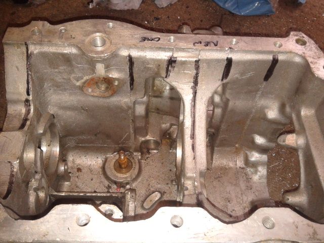

Ok I have found one that looks the best from my stash, so am I just cleaning it up where I marked?
Thats the idea, but once I started I couldnt stop and went nuts on mine

Well I have been pissing about with it, am I going right down so the centre web is flush both sides? as there is a lot of meat to come off it then lol.
Also is the out side fair game? or should I look out for any thing?
Just anything that is not smooth really mate. If it has a rough edge it can crack
How come it cracks from a rough edge? just wondering

from the casting, basically two bits of metal pressed together
as appose to forging which is a single complete piece

Chalkie, a good analagy is - when you polish your car and have a roll of mutton cloth it is difficult to tear a bit off but if you put a small cut in it you can tear it easier, its the same with a casting - if it has a rough edge it can crack from there but if you smooth it off there is nowhere for a crack to start

with a smooth edge you spread the stresses in lots of other places making it harder to crack instead of in one perticular place if it is sharp
