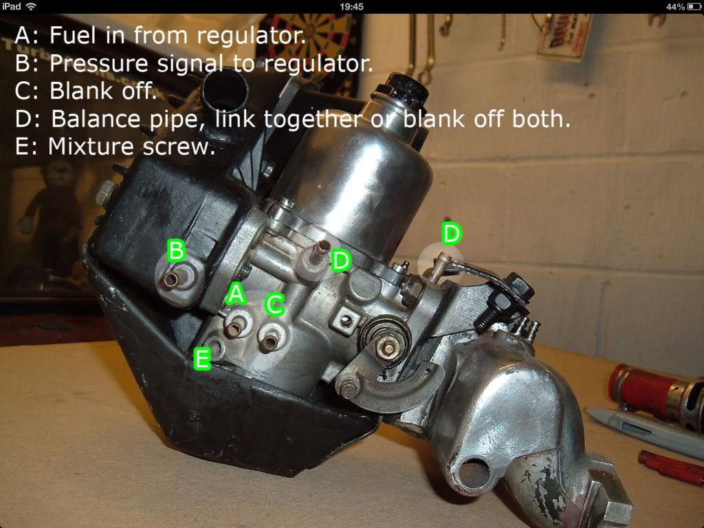

Hello everyone!! As a newbie to the A+ Metro Turbo engine I'm struggling with the pipe connections to the carburetor. I'd greatly appreciate any close up pics or diagrams to explain which pipes go where. If any one could help I'd greatly appreciate. Thanks.

There's some pics on here, but I'm not sure where, so have a look here:

This should help you mate.
