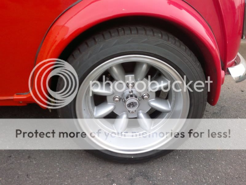

I made the mistake of fitting rear discs and wilwood calipers on my Toyota 16v powered mk1. First track day ended up swapping ends a few times. Eventually using an adjustable bias adjuster to reduce the braking force at the rear the car became more manageable under braking. This is the only picture I can find of the conversion
