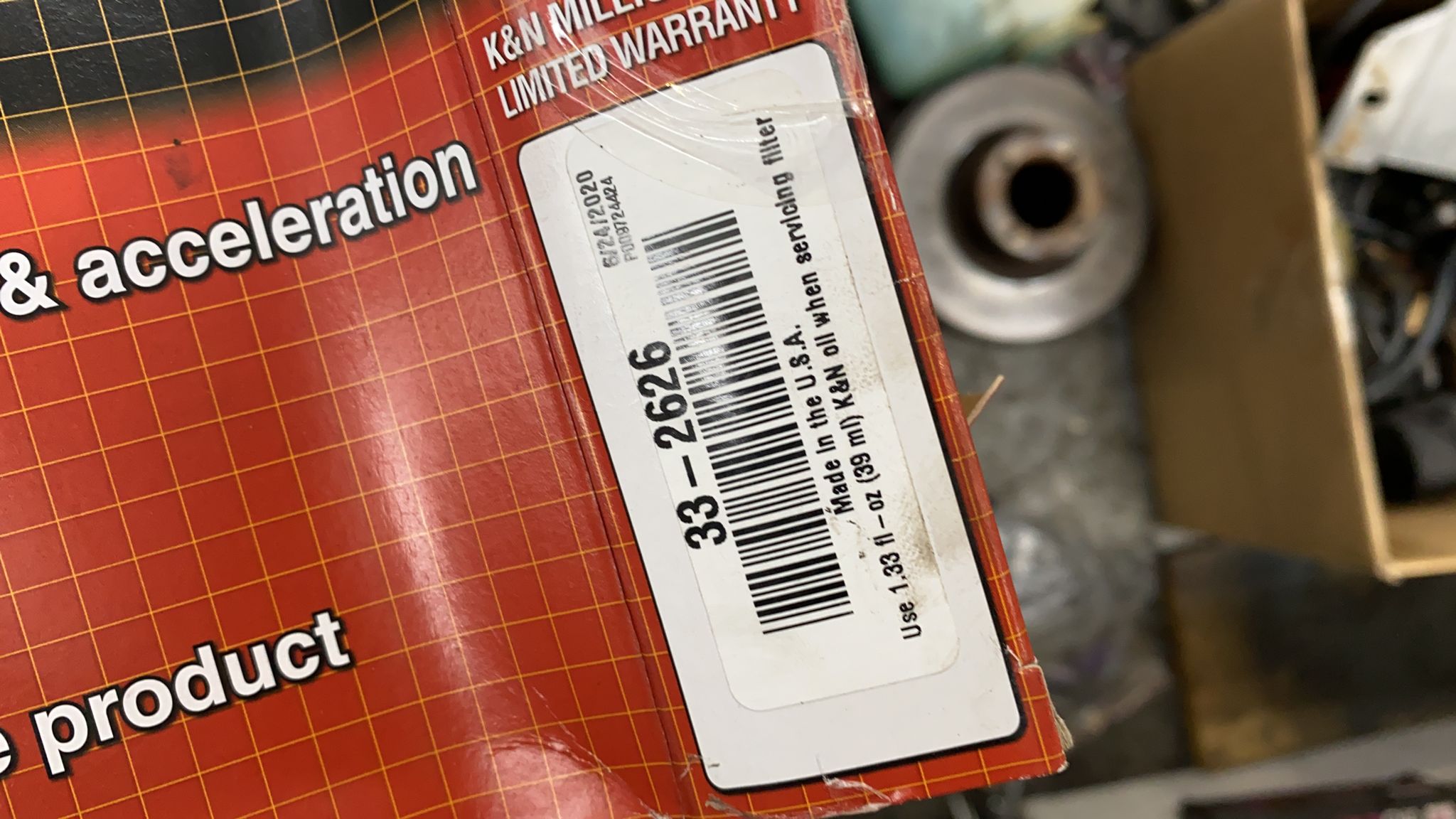

Just resurrecting a very old thread. Following substantial research in attempting to find the correct fitting filter, we found that the K&N part number: 33-2626 filter fits best with sufficient "lip" to be caught between the halves of the case. K&N 33-2001 and others do not have sufficient lip to offer up resistance to afford the clips to clamp properly.

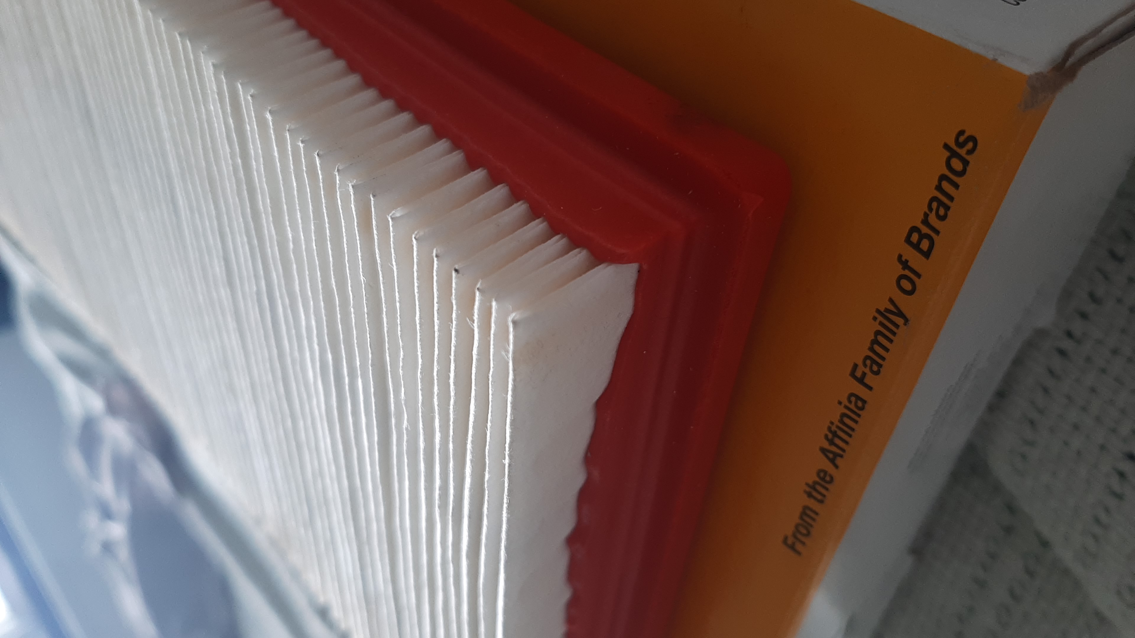

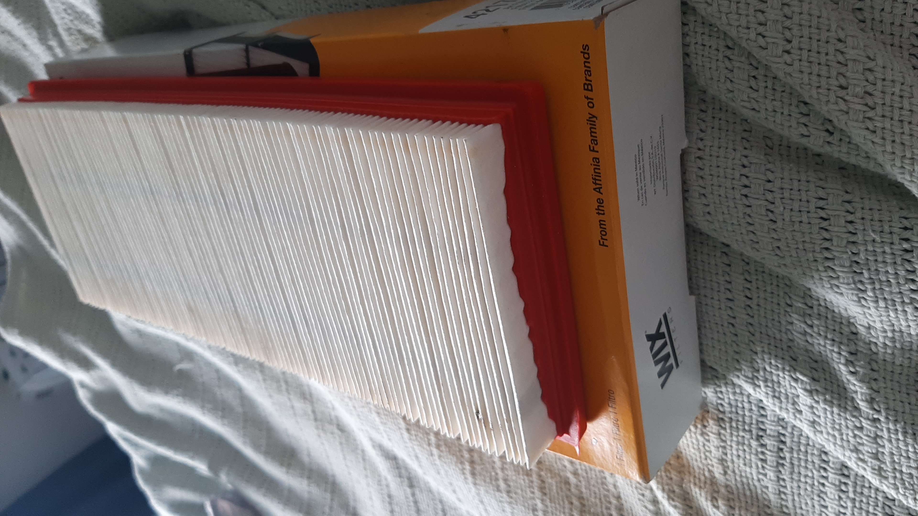

We also found that WIX part number: 42170 is an excellent fit for a disposable paper filter.
