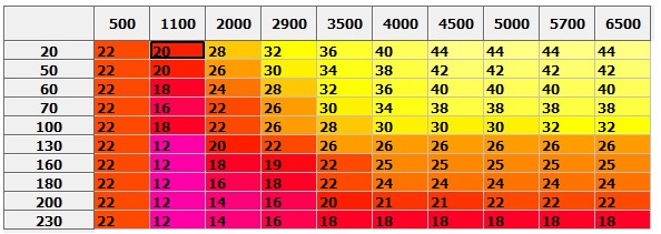

while your on was this the base map (john's) you where running in the van. believe you may have had a little more advance on boost over 3K.
