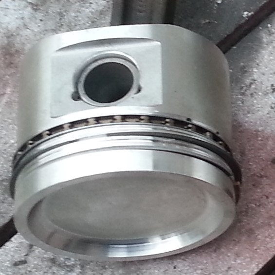

I have bought a metro turbo engine in almost complete but stripped form and I am trying to work out the good from the bad to allow me to do a good rebuild.
My question is does any one recognise these pistons there new, never fitted look and feel like there alloy, rods have been filed for weight so someone seems to have known what they were doing I HOPE lol.
any help thanks tony
Amp
432 Posts
Member #: 7856
Is there any marking on the crown or on the underside of the piston?
look like Omega's to me
At a guess 15cc forged omega's. But yes look under the crown.
id go with them being omegas gas too, and id bet there modified 10cc ones

Thanks all I will check on the numbers tomorrow.
I know there's isn't any numbers on the top of the piston but i do remember there being 3 numbers on the inside but off the top of my head unsure what they were will check.
do all omegas have omega stamped on them
cheers

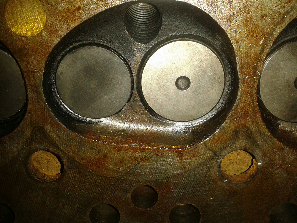

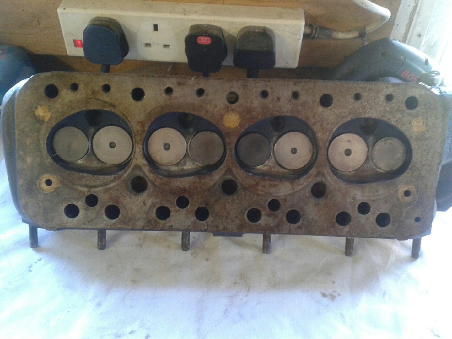

Anyway I have pic's on my phone of the head I got which has had work done also.
As I said I know nothing about what's been done as the fella I got it off didn't have any of the work done
himself just think he passed it on making a bit of cash.
It looks on the pic's like it got a crack but its just a stain on the steel from what I can see.
The valves look new and I thing its been ground out around them do you agree
thanks again
Edited by tony 69 on 2nd Oct, 2013.
Someone has definitely been at the head and taken material out, worth measuring the CC's so you know where you stand.

I thought so to but I cant quite get my head round how to work the cc out
can you help and explain it to me please *smiley**smiley*
Easiest way to do it is using a CD and a syringe, grease the head face around the chamber thinly to stop fluid leaking out, place the cd over the chamber with the hole in the middle, and squirt thin oil/water/spirits/thinners etc in until it reaches the top and record what you put in, Id also take it out recording what is removed, and then take an average of the two if they're very close. Do this for all of the chambers, And it's also a good way of finding out how well the valves seal in the head, if there's anything in the ports after, try relapping the valves, failing that it may need the seat recutting or something, following an inspection from an expert. If you find it hard to see the clear liquid you can add food colouring or something, make sure there are no bubbles in the chamber when full too.

hi all ok so ive taken a good look at the inside of the pistons and see the numbers 304.
I also spotted the word omega hiding under the conrod well done gentlemen you were correct *Clapping**Clapping*
cheers tony
4642 Posts
The chambers look like they've just had the beak removed but are otherwise standard. If the head's unskimmed, I'd guess they're about 23cc, but as said above it's best to check.

I thought the head had just had the nose removed but also thought the valves looked unusual or
is that just me.
