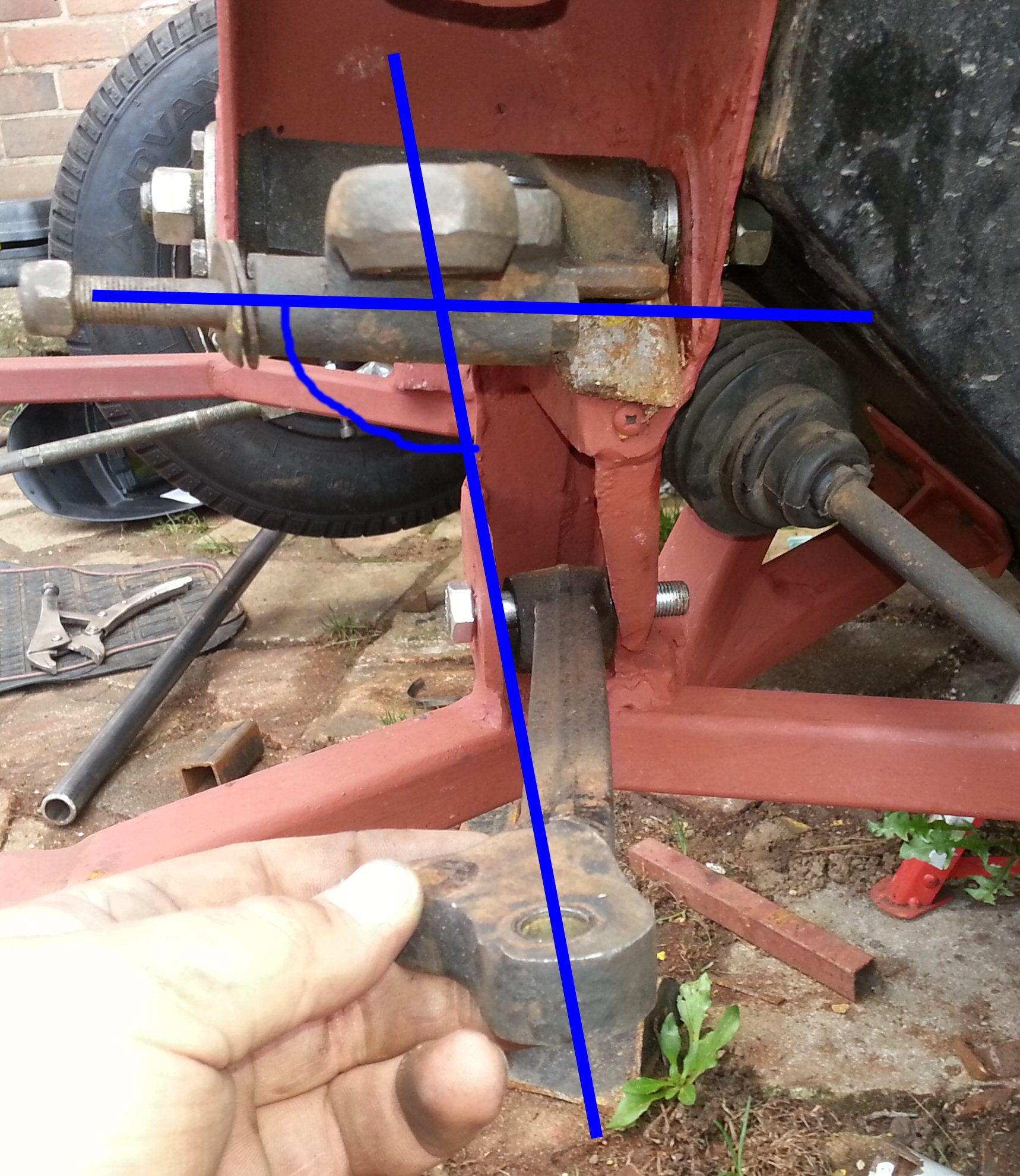

anyone know off hand what this angle this is as standard?
i appreciate the pic is way off *happy*
i was thinking about setting the caster to zero ( 90 in the pic)
new tie bars are adjustable but would like to set them so the adjustment is in the middle whilst the geo is approximately correct
95 degree on the other side of the line for 5 degr castor.bottom ball forward of the top?
Yes the top trails the bottom for positive caster. Standard is around 3.5 degrees. I stick with 3.5 with the plate diff, but you could run more with an open one.

Wil, I found 4 - 5 degrees helps keep the plate diff in a straighter line
That a good point. I was thinking of settings for circuit use. Also, my weedy arms mean I have to go for the softer option!
Lol, I know what you mean - it does make my arms ache on a spirited drive especially with the diff set at 200lbs
