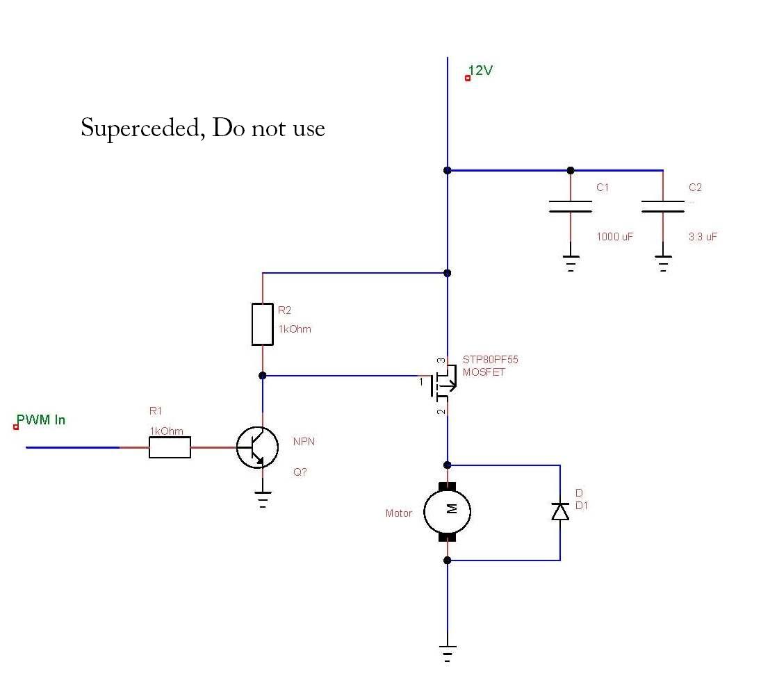

How about this for starters:

This would be how I would modify what you posted:
EDIT: You might also want to consider using a few of those FETs in parallel to lower the heat dissipation (both overall and per FET). And R2 should probably be something like 100R or maybe even lower.
Jean

Paul/Jean,
I agree with Jean's version except for one thing I don't understand - moving the flyback diode to across the FET. According to the datasheet the package has an internal diode ???
Re. the R2, yes, 100ohm or less - from what I've read these high power Mosfets have a high gate capacitance so the initial gate current has to be high for them to switch cleanly. To that end, also make sure the resistor has a reasonable power rating (without doing the maths I would guess at 1/2 or 1 W) and the drive transistor is good for 1 - 2 A (ie a ZTX450 or better).
EDIT - and I agree with Jean about using a couple or more of them. You would exceed the rating of a single one if you approached 100% PWM and their power dissipation isn't as good as the N-channel equivilants plus you will most likely have to mount them on micas (or the more modern silicon) insulators - the datasheet isn't clear what terminal the heat sink tab is common with (it might be isolated but normally there is an additional letter after the TO-220 if it is) but most likely common with pin 2.
Edited by Rod S on 10th Nov, 2013.
Thanks guys.
I'll update the schematic. I think I understand what's going on although electronics is not my bag.
I like the idea of two MOSFETs to help with the current and heat. Just need to work out how to mount and wire them up with 10 mm^2 cable.
Is there any thing special about the capacitors. I don't understand why I need two of them.
Any thing special about the diode? Just general purpose or something else?
Mounting - ideally on a purpose made PCB (we can think about that later) but the main thing is to support the legs relative to the bolt/heatsink hole so, for a test, what I would suggest is a bit of veroboard with a nice slab of 1/8" (3mm) aluminium down one side - visualise the standard MS3 board and its simple heatsink but make it larger. And remove the copper from the veroboard where the bolts go through.
Then drill the adjacent holes (next to where you solder the Mosfet pins) out to a suitable size for your wires and feed them through and run them along the tracks and solder to the Mosfet pins (ie, do not rely on the copper tracks, they are far too small for the current).
But you don't need anywhere near 10mm^2 for 40A especially if shared between two Mosfets (look at the size of their pins). 6mm^2 should be fine for the short lengths involved. I would probably use 4mm^2 to the individual Mosfets and only use 6mm^2 once they are doubled up, at least for the test, maybe larger later.
The different capacitor values are for different frequencies. I assume you just took the values from the datasheet ? Bear in mind those values were for a test circuit with a specified impedance, the real motor may not be exactly the same but it's a good starting point.
The diode, I'd rather wait for Jean's reply - I assumed it was flyback protection (in which case I would put it across the motor and use a good high current general purpose one) but I think Jean has another reason for his location which I can't immediately figure out.

jbelanger
1267 Posts
Member #: 831
Montreal, Canada
Rod, Paul,
I'm not sure what I was thinking about with the diode but you're right that it is not needed across the FET. And my copying and pasting on the original diagram made the one across the motor disappear and I did not noticed for some reason.
So the diode should be as per the original diagram. As for it's size, I'm not sure a standard 1N4001 would be sufficient. You might want to go with an FR301.
As for the base resistor, if you use one of the injectors output to drive this, you will want to omit R1 and the NPN since this will be done by the injector circuit and you can use a 10 Ohm for R2 which should be good to drive the FET. The injector driver will have no problem driving the two FETs and two 10R resistors (of a suitably high rating as mentioned). The MS3X spare outputs are also able to drive this.
Jean
