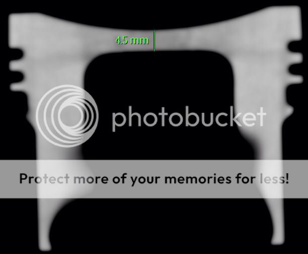

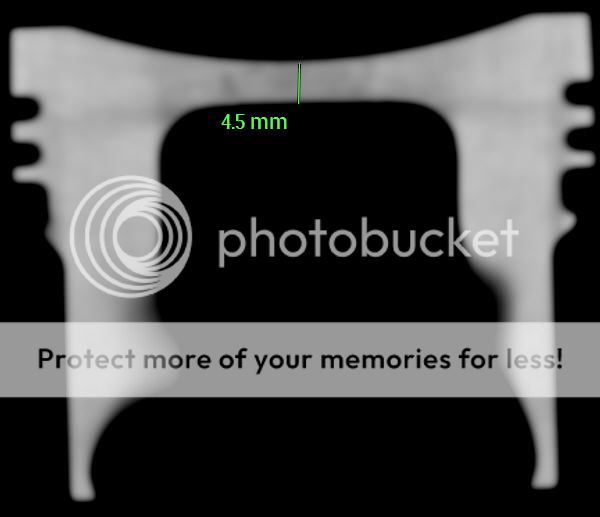

After melting one of my cast omega pistons I decided for now I'm going to build a 1380 NA engine. Then later I will rebuild the turbo motor. I've just received the hypatec pistons, so i thought I would do a search on here to find if anyone were using them or had trouble with them. I found a thread about possibly using them for turbo use and what the crown thickness was. Someone mentioned using a CT scanner to scan piston to measure.... I just happened to have the pistons in my car and have access to a CT today.
I should have removed the gudgoen pin before scanning so the centre slice image is not great
Cut through the first third
Centre
Bad image caused by the gudgoen pin, but the crown thickness can be measured
These pistons are really well priced and maybe they will work for low boost engines?
Any thoughts?

But the design may have changed, your CT scan shows less crown thickness than I physically measured (in the centre).
