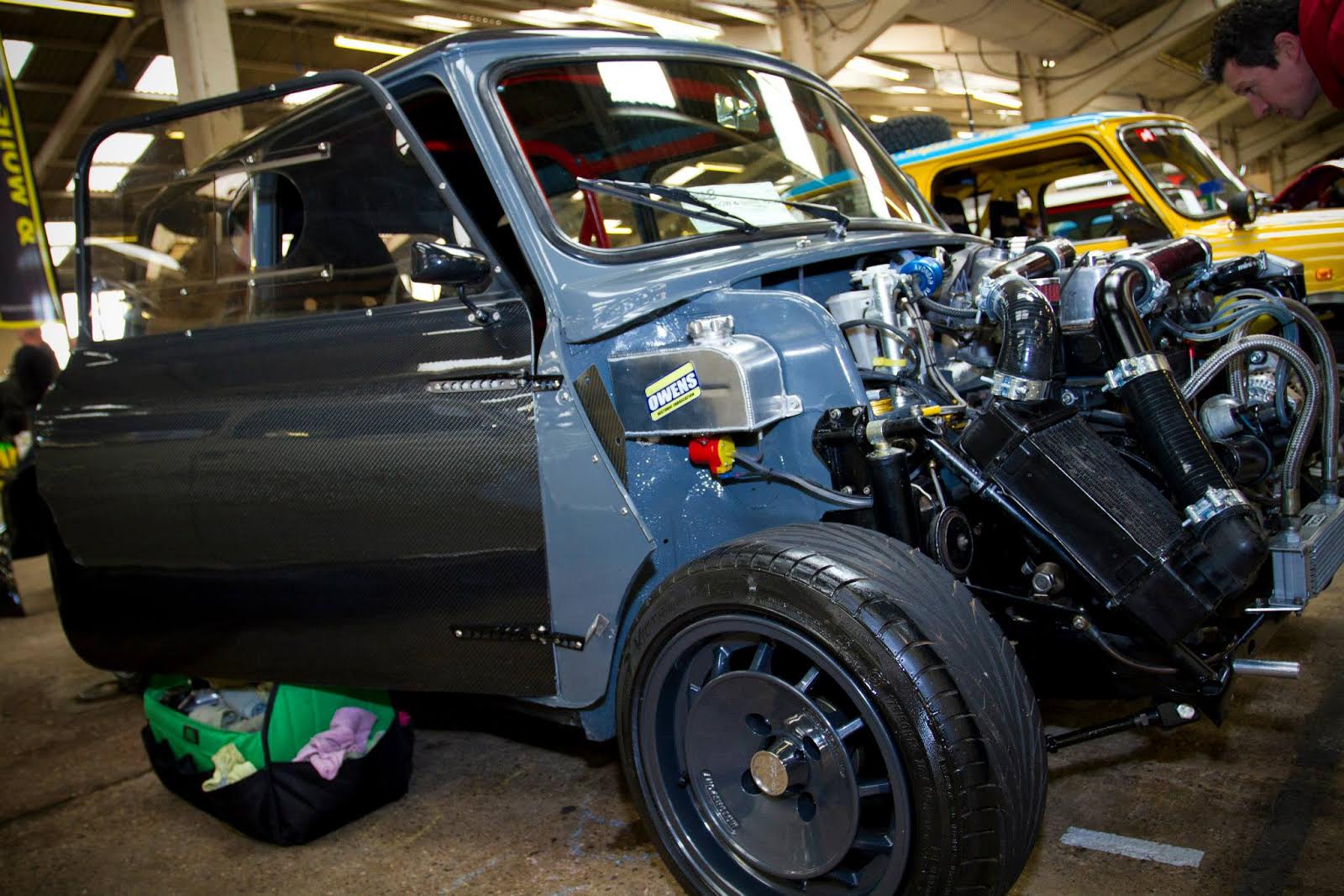

Hi guys, still quite new too the forum, just a few pictures of my turbo mini
Cheers lee.

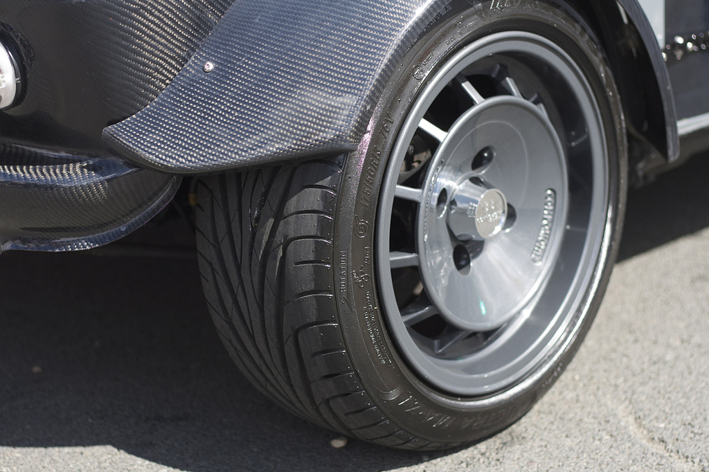

Love the wheels
How did you make the inner wings like that? Bent tube?
Does the air filter not take a beating there?
I like it :)
Dave the Cake
F415dda
202 Posts
Member #: 10595
Pembrokeshire,Wales.
thanks mate! yeah bent a tube, haven't had any problems so far, cheers lee

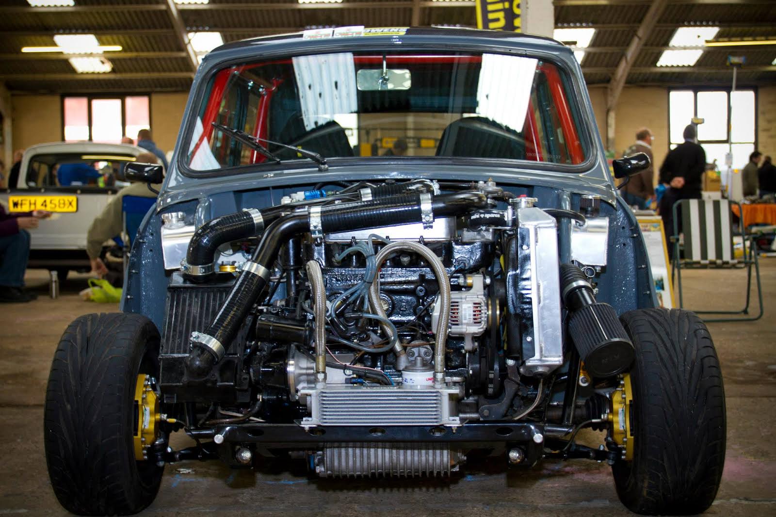

nice looking setup. any chance of a few photos showing how you route'd the air intake from the rad area to the turbo?
9407 Posts
nice custom wiring loom *wink*

nice, whats the engine spec?
F415dda
202 Posts
Member #: 10595
1293 morepseed engine, omega pistons,modified t3 turbo,hardened and balanced crankshaft, avon bar actuator,med 4 core radiator,stage 5 super squish head, fiesta rs turbo intercooler,quaife straight cut dog box probably forgot a lot, cheers lee.

Nice wheels

Love the wheels!

nice doors and hinges whats their weight?
F415dda
202 Posts
Member #: 10595
Thanks ladz! Unsure on exact weight but way lighter than steel ones.

look like force racing items :)
nice looking mini as many have alreay said, do like the OZ motorsport wheels.

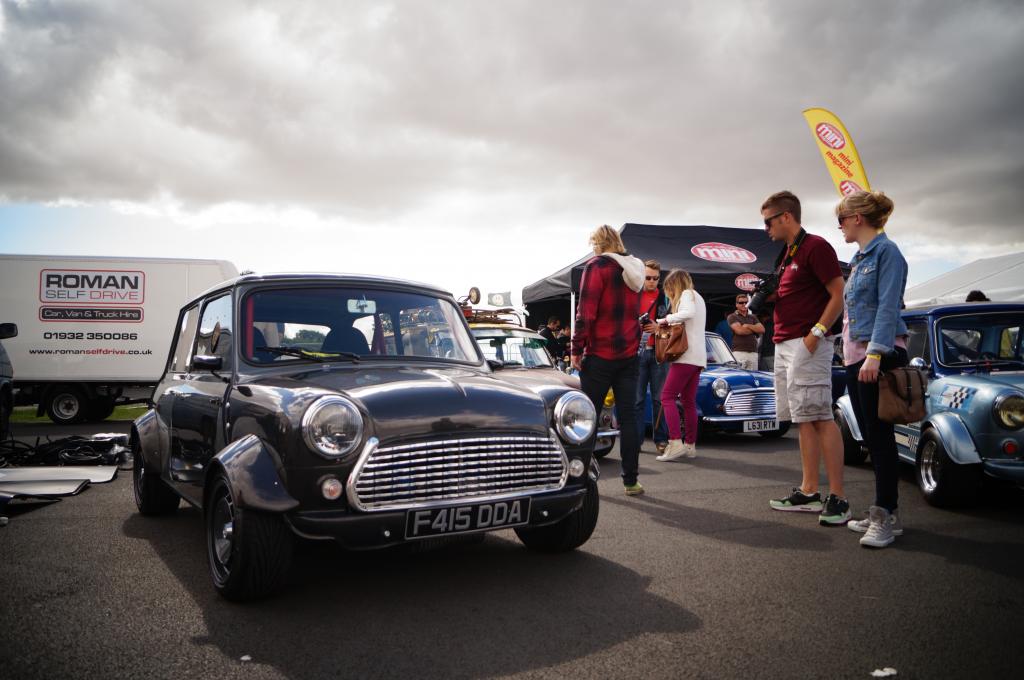

got my mini magazine today and was so chuffed to have a picture in the mini fair 2 report! thanks too matt woods for picture.
