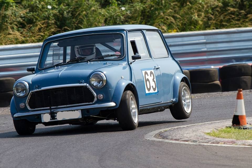

Currently I am running 12 inch wheels and Yokohama A048 Tyres. The suspension set up has standard donuts on the front, negative camber bottom arms and spax shocks. The rear is protech rear coilovers 125lb spings and alloy rear arms.
the set up I am focusing on will be for hillclimbs and sprints but also 3000 road miles, so cannot be totally competition focused. Ride quality is already on the edge of tolerable!
I would like to reduce body roll by fitting minispares red dot suspension cones as it does roll when provoked hard. I am also considering fitting some force racing 7x10's with yokohama A032's. Will this actually equate to faster cornering compared to the current set up, as I believe the 12 inch A048 Is a superior tyre, as it deflects much less in the sidewall and the tread block seem more stable.
The other option is to fit 13's and 175 50 13 A048's and leave the suspension as it is, but one consideration, is that people say 13's break away quicker then 10's. Is this also the case with 12's compared to 13's or is there not much difference between 12's and 13's.
Or finally fit 13's, red dot cones and invest in a cushion.
