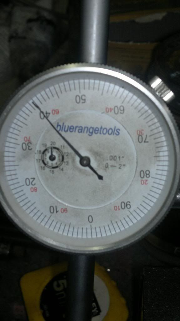

I borrowed a dti gauge yesterday and forgot how he told me to convert into mm. On the front it has 001" & 0-2".
I worked it out to half a turn is 1mm, but I maybe wrong.
Thanks

philc
1394 Posts
Member #: 1346
bromsgrove
pic uploaded
lee.pb
1425 Posts
Member #: 9199
Lancashire
As per my previous comments.
The 0-2" is the total travel of the gauge.
If the gauge was set at Zero before any movement / measurement was taken the reading on the gauge would be either......
0.04" = 1.02mm
0.06" = 1.52mm
Depending on the direction of the needle.
Hope this helps.

Mike-998
883 Posts
Member #: 9774
Buckinghamshire
I have a metric one you're welcome to borrow as well, in Coventry
I always work on the figures.
40 Thou to the mm.
4thou is 0.1mm
10thou 0.25mm
1thou is 0.02mm
But like Carl says they are not exact, but if you need to work to tighter tolerances than the above stated you are best off working in the the same units as your measuring equipment as it saves any errors in converting figure.
