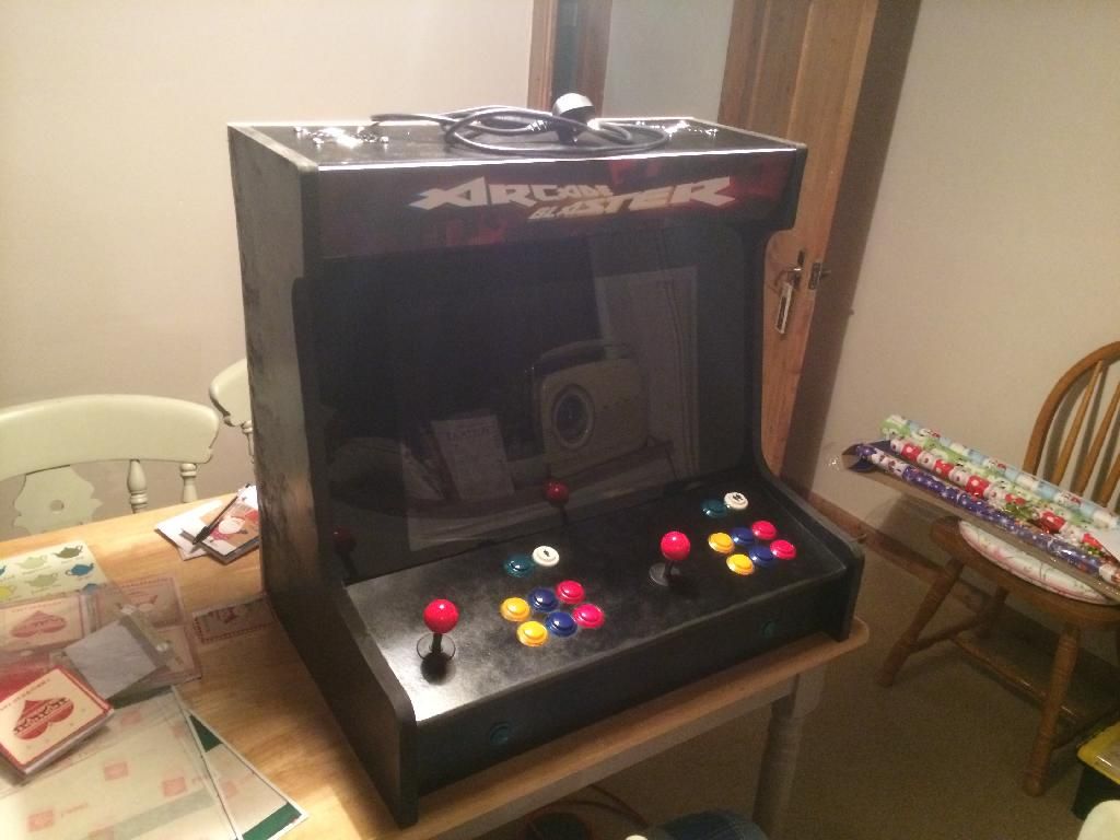

I'm putting together a homemade arcade cabinet for which I've bought a T moulding to run along the edges of both side panels. These panels are 18mm thick and have some tricky corners etc, so I wouldn't like to attempt it freehand with a Dremal for instance.
Now, does anyone have a slot cutting bit for a router? Size needs to be around 1mm ish.
I believe that I t's like the image below. But I'd also need the piece which connects this to the router.
I'm looking to borrow this as the tool is expensive, especially as this will be the only time I use it.
Thanks for any help in advance.

I've looked at the biscuit cutters but as you say, these aren't available this small.
It seems this is one of those tools that isn't needed for much other than what I'm doing, so isn't easy to get hold of.
I might make/modify something, or just freehand it.
1mm cutting disk? And a bit of free style cutting action ?
I reckon so.

Thanks for the ideas. I've bought a slitting saw for £3. I think I'll lash something together so it fits to the edge of my bench.
