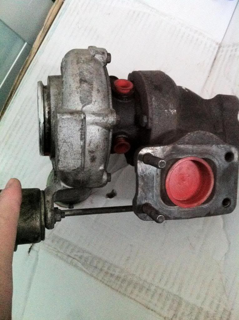

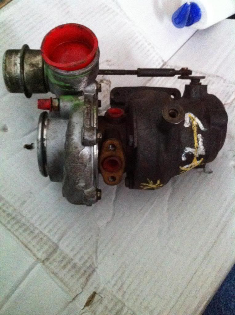

is it necessary to run the water feed for the gt17? if so, I know it sounds a billy silly but i know which one is the feed in but where the exit? If I'm think correctly the water feed is in-between the oil in and out? Also has anyone got the thread which shows how to move the turbine housing round can't seen to find it.
Many thanks, sorry I'm new to turbos.

Is it a gt1752 ?
Picture would help.

yeah its a gt1752, pictures coming soon

The ones at 3 o'clock and 9 o'clock are water and it is best to run them if they are fitted.
To clock the housing undo the bolts holding the U shaped clamps to their respective housings.
On too of what Andy says, after rotating the housing, you will need to sort a new mount for the actuator.
I'd definitely use the water cooling.

Im going to have to look at space but it think i can get away with making the tab which the actuator attaches longer hopefully. but with the water lines i'll just use some banjo's etc??
