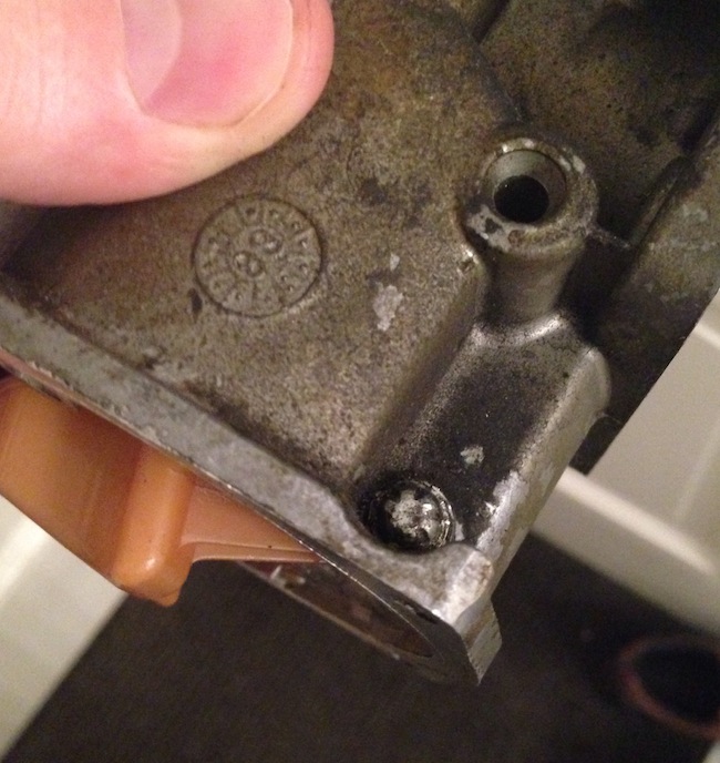

I've got a rebuild kit for a Metro turbo HIF44 which I'm currently stripping down. Can any of you guys tell me how the hell I get the tamper proof bolt out thats holding the float spindle?
cut a slot in it with a dremel type tool or drift it round with a small chisel.

Pretty sure I was able to undo mine with a small socket of some sort. Cant remember what though.
Change to normal screws when rebuilding.

I struggled with this when doing mine, I found the easiest way was to clamp the carb and drift the bolt undone. Then with it off I cut a groove in the top with a hacksaw so a screwdriver can be used in future.

Screwfix actually sell a tamper proof screw kit that comes with a screwdriver for these, you can also buy posi-drive bits with the correct fitting aswell
4642 Posts
I always cut a slot in them with a small cutting disc in the dremel. Then you can use a screwdriver to undo it.

drifted mine then cut a slot to reinstall worked out well

Thanks guys. Tapped it round with a small chisel - worked a treat.
