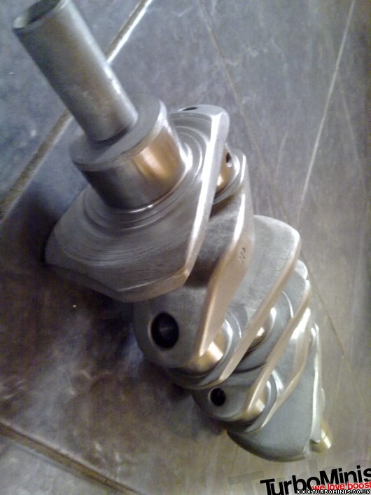

I've had the majority of the force racing list done to my crank. Removed 1kg from it. I would recommend Carl above the other suppliers.
Don't see the point in machining a hardened crank as you are removing a substantial amount of the hardened material.
wow 1kg really? hopefully carl will pop in hear and work his magic words on me :p

Think mine was nearly 2kg off!
i also recommend Carl i have every thing except blading
i did not weigh before the work but it was awesome ( now sold)

My 84MM wedged and cross drilled MED crank is lovely.
I went wedged balanced and heat treated. The engine is much smoother
How baggy are the bearing clearances? and I would also recommend polishing the tail of the crank where the primary gear journals are
