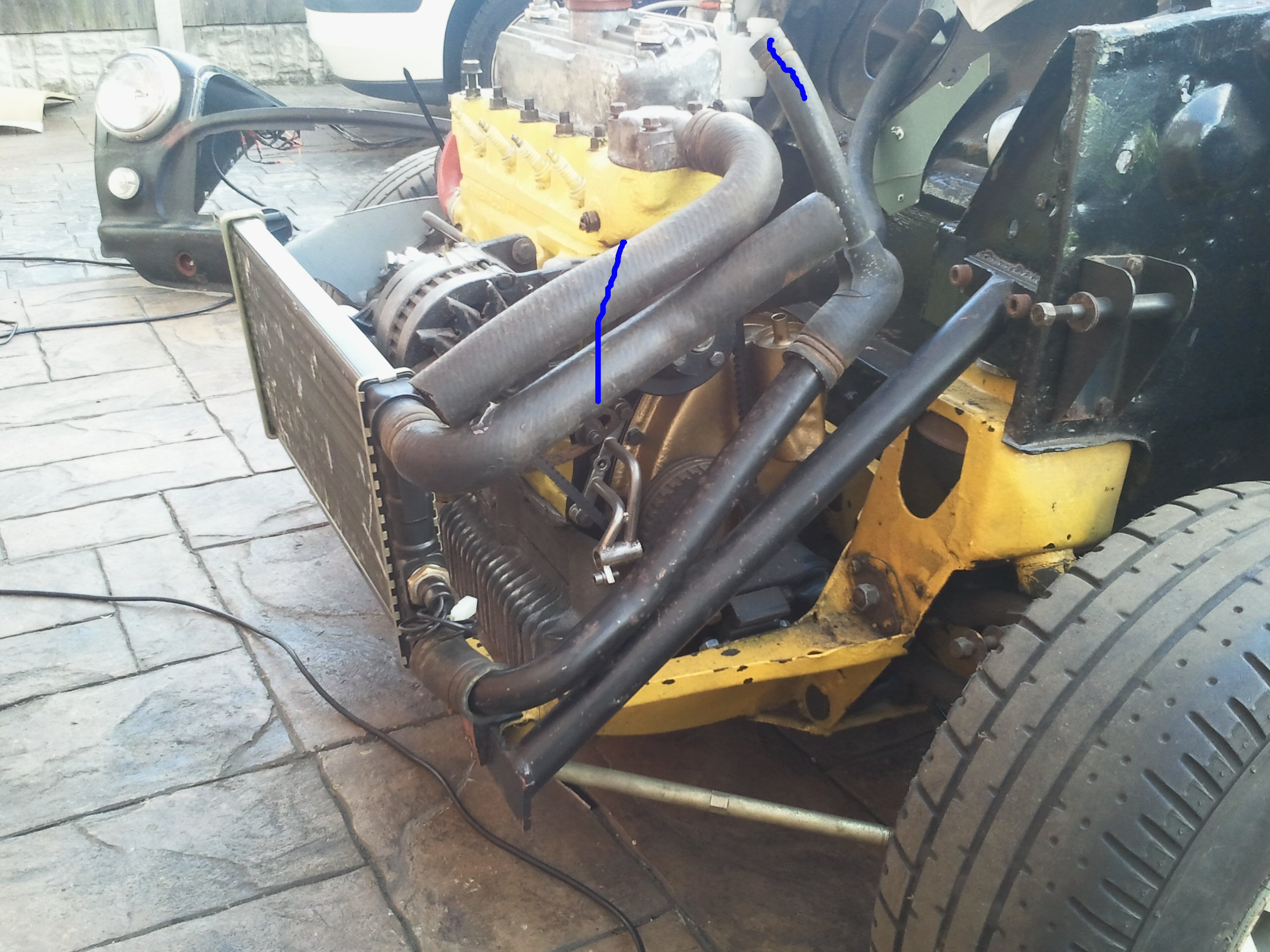

this is the best pic i have, i did not keep the cinc rad long as mine was crap ( really cheap ebay one)
the top hose was cut and connected, the header tank connected to the long one sticking up ( marked with blue line)

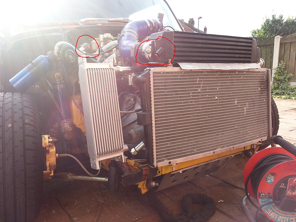

like so

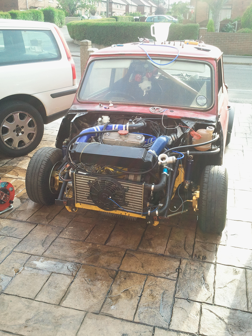

and ditched for this, with a revised coolant piping ( ignore the red circles )
