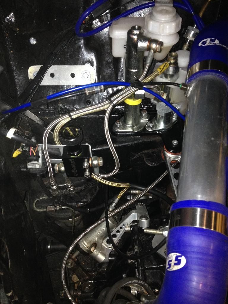

Can you run an adjustable bias valve. They weigh alot less than the controller. Im running a small bias valve on the rear system on mine
miniracer
25 Posts
Member #: 10295
Sorry I should have worded that better. I have a stock one that's been modified to be adjustable, and is mounted in the original place, it just could be a little lighter.

So swap it for an adjustable bias valve.

The previous question regarding bias valves was is there a lighter alternative to what I already have. I don't have to be able to reach it from the seated position.
Thanks again.
Iirc paul w rating the minisport hubs quite highly.
The bias valve can be placed where your current boat anchor is.

One of note is that heavy cast slave cylinder. ( only mention because of the photo posted above ) He actually made his own from aluminium !
http://www.metropower.org.uk/forum/forums/...?tid=42039&mid=
