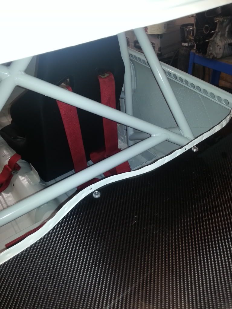

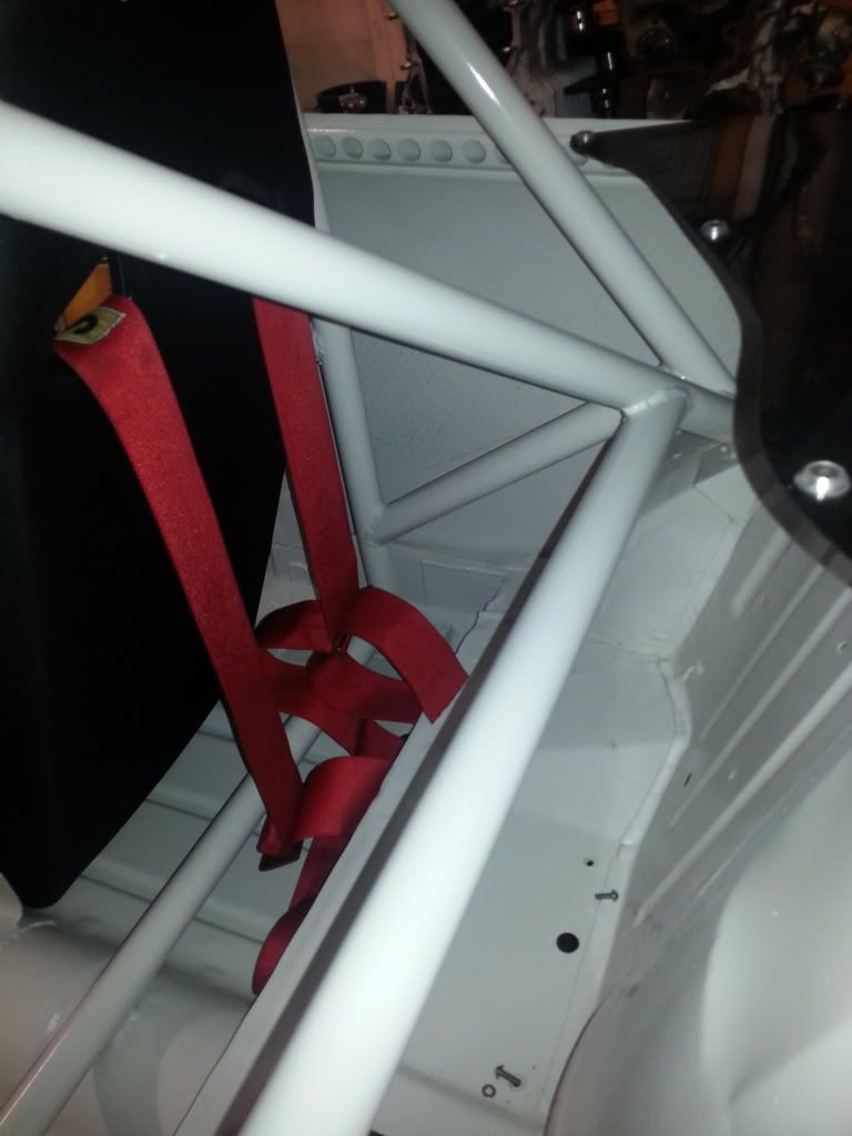

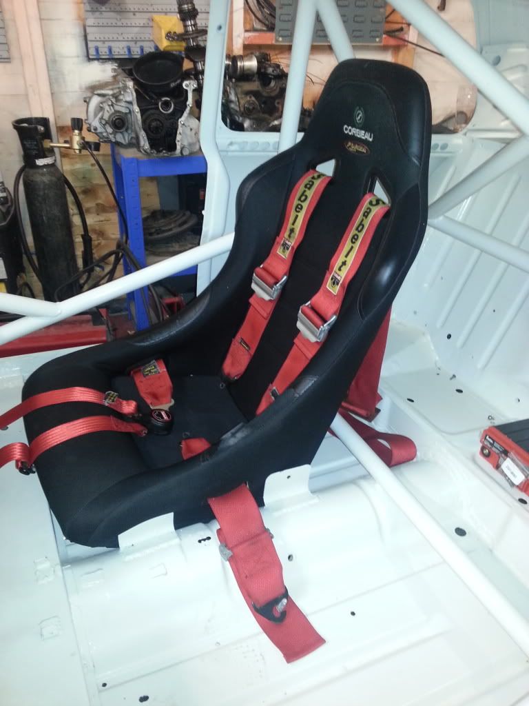

Alright chaps, after your advice on where to mount my harness's and hows best.
I'm going to use a 6 point for the drivers seat and 4 point for passenger,
i do have the rear harness bar fitted and think if i looped the harness round i think that would suffice?
but where the floor mounts go whats the best way to fix these to the deck, i dont want to do any welding if i can!
some pics
any ideas or pics welcome chaps!
Cheers Dev

I only have 3 point harnesses and put eye bolts into the original seat belt mounts. Unsure about the front straps though.
Eye bolts in the old holes, as for the dick strap I have just drilled the floor and fitted a eye bolt with the proper nut / spreader.

sweet wasn't sure if that would be frowned upon but sounds best idea!
