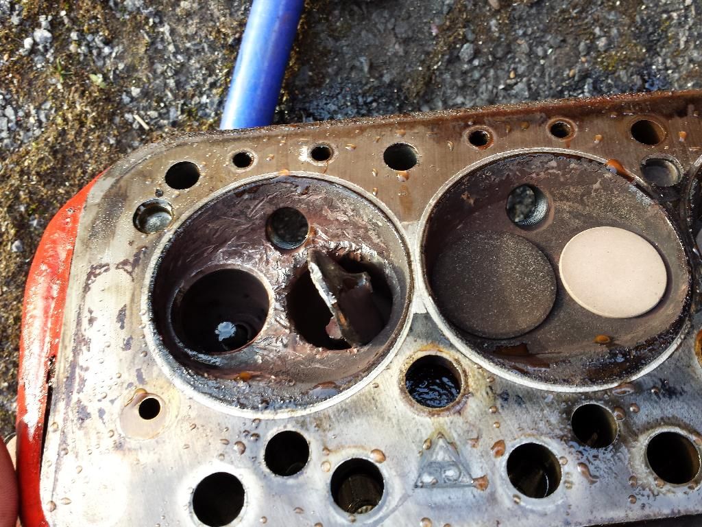

After the flywheel decided to depart from the crank a couple of weeks ago, I thought it was back running ok.... until today. Gave it a bit of throttle, started missing, so lifted, it cut out and I rolled to a stop. I knew there was nothing I could do at the side of the road, so called the aa who did a few checks. Removed number 4 plug, and it was smashed to bits. He recovered me home, so I removed the head, where I found this....

Shit dude! no way of machining the head back up? |

Hopefully, I've messaged turbo phil some pics to see if it's repairable. It's going to need valves, guides, seats and a good clean up at least I think. Bore looks ok, so hopefully get away with new pistons. On 25th Sep, 2009 mini13 said:

Shit the bed!! Bad luck mate, what sort of boost was you running at the time?

Only 10 psi. It's my own fault, it's not been rolling roaded yet. Although the carb came off another turbo mini running descent power. Ran well, but still needed a tune. I think it's been running lean. On 25th Sep, 2009 mini13 said:

Lean hasn't done that. Snapped valve has done that. On 11th Feb, 2015 robert said:

What do you think has caused it? On 25th Sep, 2009 mini13 said:

Reving too hard maybe. It's no 4 piston so cooling could be a factor. On 11th Feb, 2015 robert said:

It doesn't rev high at all, runs out of puff at about 5k probably due to poor fuel mixture, and runs really cool at 80 degrees. On 25th Sep, 2009 mini13 said:

Like Andy says, snapped valve , probably not helped by local overheating due to weak mixture,

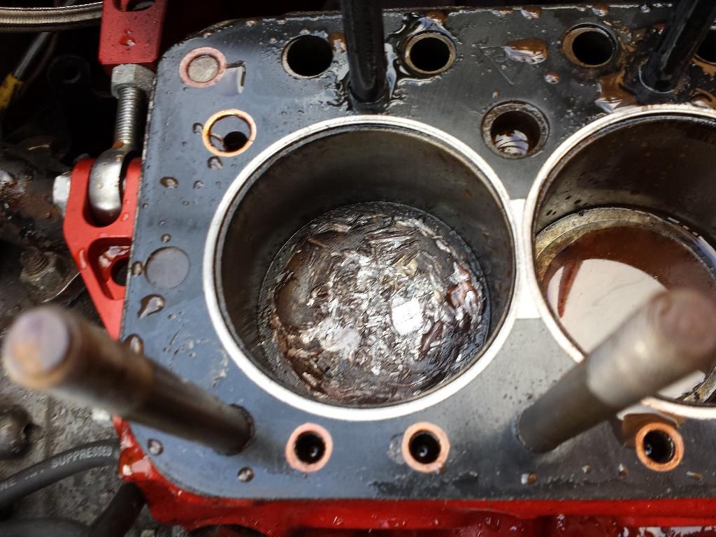

Got a head sitting on the shelf with the same damage. Is the bore ok? |

In all honesty it doesn't get abused. I'm just trying to get some miles on it before the rolling road. Just the occasional foot down. Bore looks fine, new pistons and maybe a light hone. On 25th Sep, 2009 mini13 said:

Were they old valves? Also, did you get new guides? Just wondering if they got a bit tight and held valve open to allow contact?

sadley! that head is total scrap, local temps on number 4 would have contributed to this failure, i suspect the guides nipped the valves up and the piston smashed into them.

that does sound like guide nipping On 28th Aug, 2011 Kean said:

Definitely guides, I had that problem.

Exactly that Eden, 100% On 25th Sep, 2009 mini13 said:

I thought it was running out of fuel. I've got an Spi pump fitted at the moment for running in purposes, but I've got a big external pump waiting to be fitted. I know Spi pumps are only good for low power outputs, so thought it was that. The pump change was the last job before the rolling road tune :( On 25th Sep, 2009 mini13 said:
