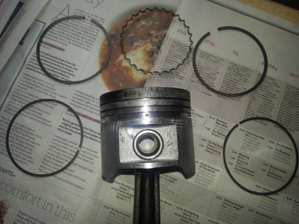

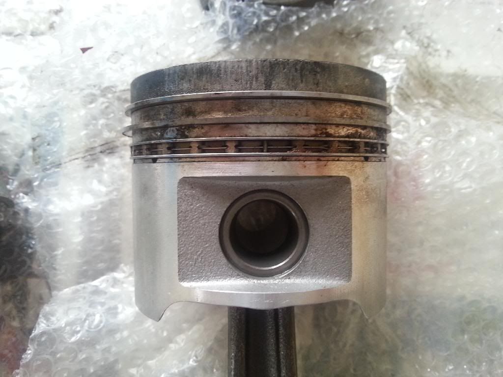

madonminis
644 Posts
Member #: 9371
East Yorkshire
Pics with and without rings.
madonminis
644 Posts
Member #: 9371
East Yorkshire
If anybody wants to be a superstar and point me in the right direction as to what I need that would be awesome.
Matt
tadge44
3006 Posts
Member #: 2500
Buckinghamshire
They look like the wider oil control rings, but as there is inly 0.5 mm difference measure them. From memory the wider ones are 3.5mm.
Yep they look like the the ones I have now. The oil control ring has tangs on the spring. The newer oil control rings are about 2mm wide and have a different looking oil control ring.
It looks like all cast omegas run the same rings from what I can see on MEDs website,it's only the forged that have different types.
