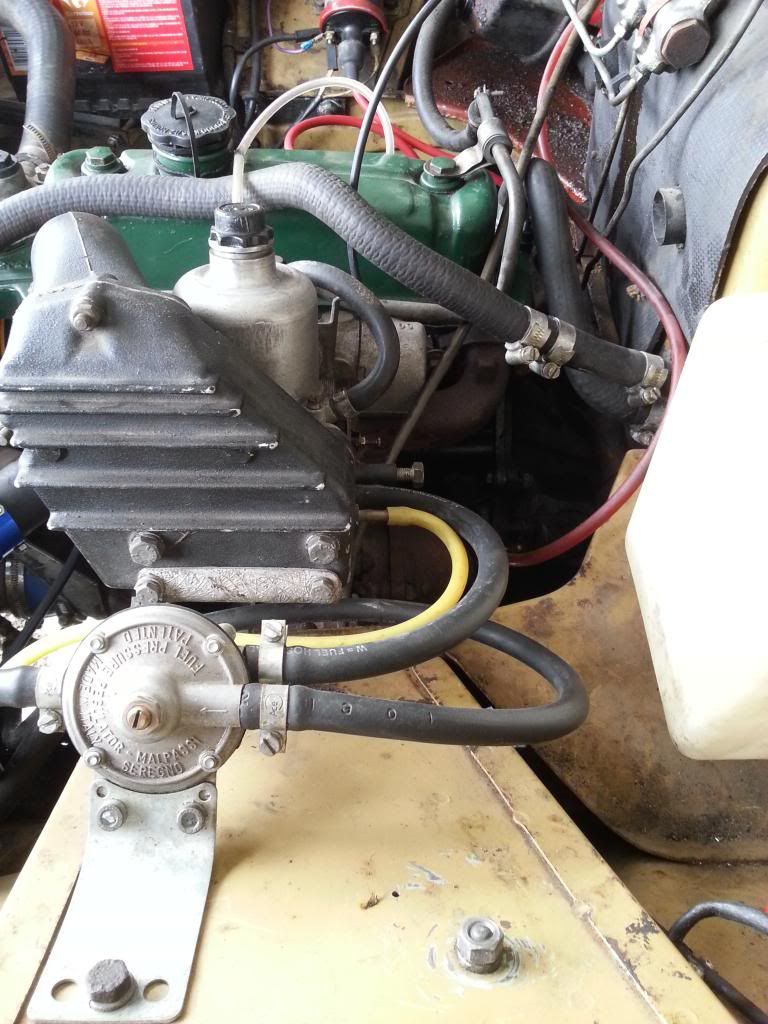

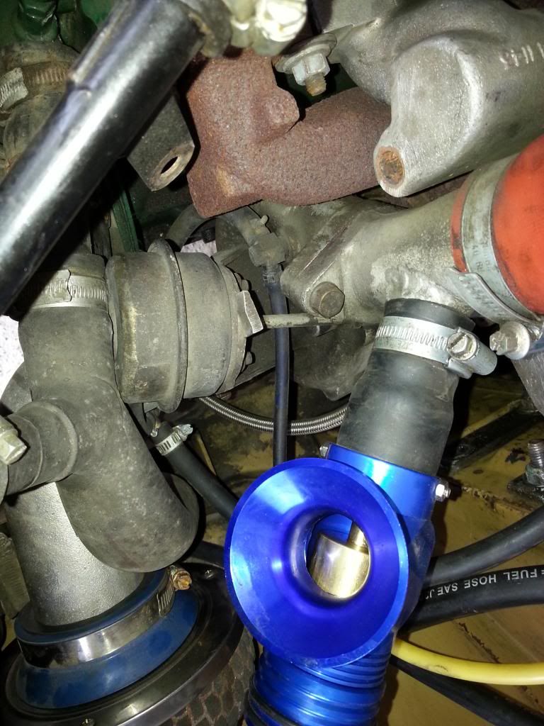

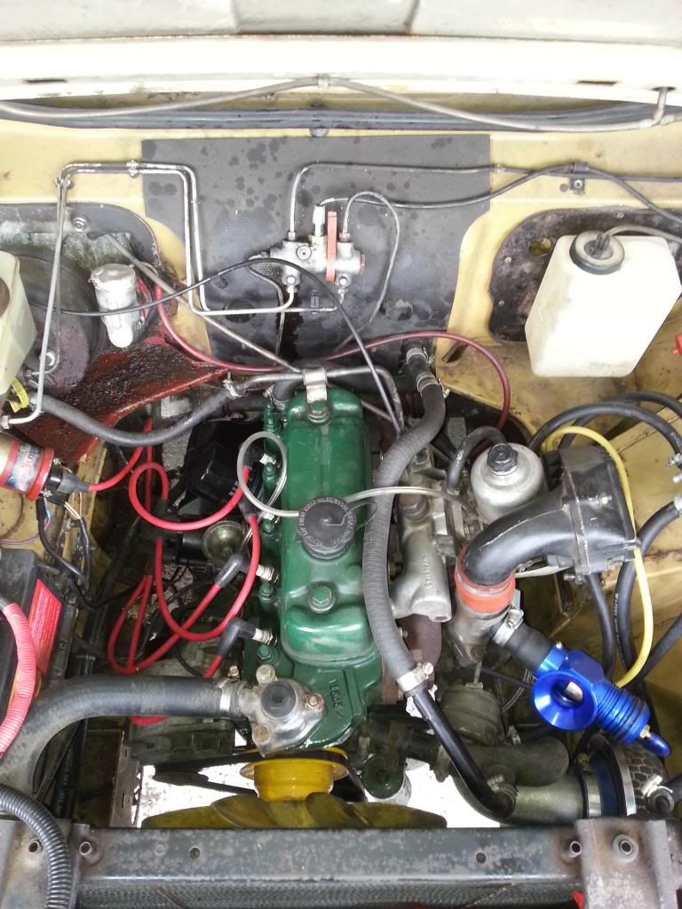

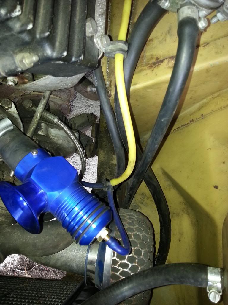

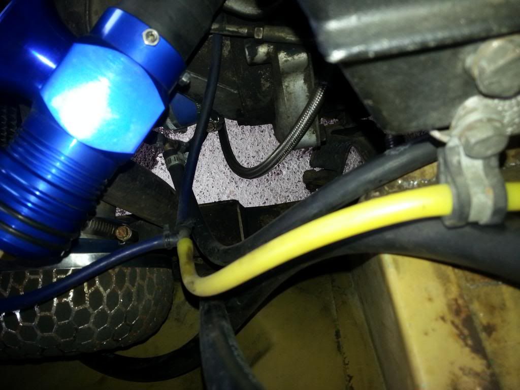

Here are the pictures of the build
I would like to say thank you very much in advance for all help and for suggestion of using a boost gauge to see what is there. I will install one tomorrow.
What is the best place to tee one in?
Your plumbing is all jacked up... This is how it should be:
http://turbo-mini.com/59247/index.html
http://turbo-mini.com/59247/33248.html
And is it my imagination or is that "duck call" dump valve not showing as wide open in that picture???
The dump valve pilot, as with the boost gauge, need to be connected to the inlet manifold. Not the plenum, the carb connection, or anywhere else. They MUST be connected to the inlet.
Easiest option is to remove, and drill and tap the banjo bolt in the middle of the inlet and put a tee in it - one for the DV, the other for the gauge.
Alternativly, do it once and righ; remove the inlet and put two hose tails in there for the DV/ gauge...

I,d just try removing and blanking off that dump valve and its connections to see what difference that made.

yeah, I think that'll fix the problems you've been having - and show up the next problems lol

As said your plumbing is not right. In addition to the links dave have try this for some guidance.
http://www.turbominis.co.uk/forums/index.php?p=vt&tid=257121

I took the banjo bolt, drilled and tapped a hose tail, plumbed in a boost gauge and a tee to the dump valve and went whoop tooshing up the road, brilliant!
Thank you for the help.
Misses a bit as although I got the mixture tuned by using a colortune kit, this was only done at idle. One cylinder was misfiring and I got it to fire by pulling the HT lead off whilst the engine was running and 'dried off' the plug by creating a larger gap. I'll buy some new plugs tomorrow based on my findings here as to the best plugs.
The car doesn't pull like it should but it goes!!!
My question now is the turbo pressure outlet (the little one) that goes to the actuator has two outputs, one big pipe to the actuator, and one small end (I blocked it off for now) what should go here (fourth photo down, above)
Many thanks.
Leave it blocked off.
Buy an AEM wideband O2 sensor for checking your mixture.
