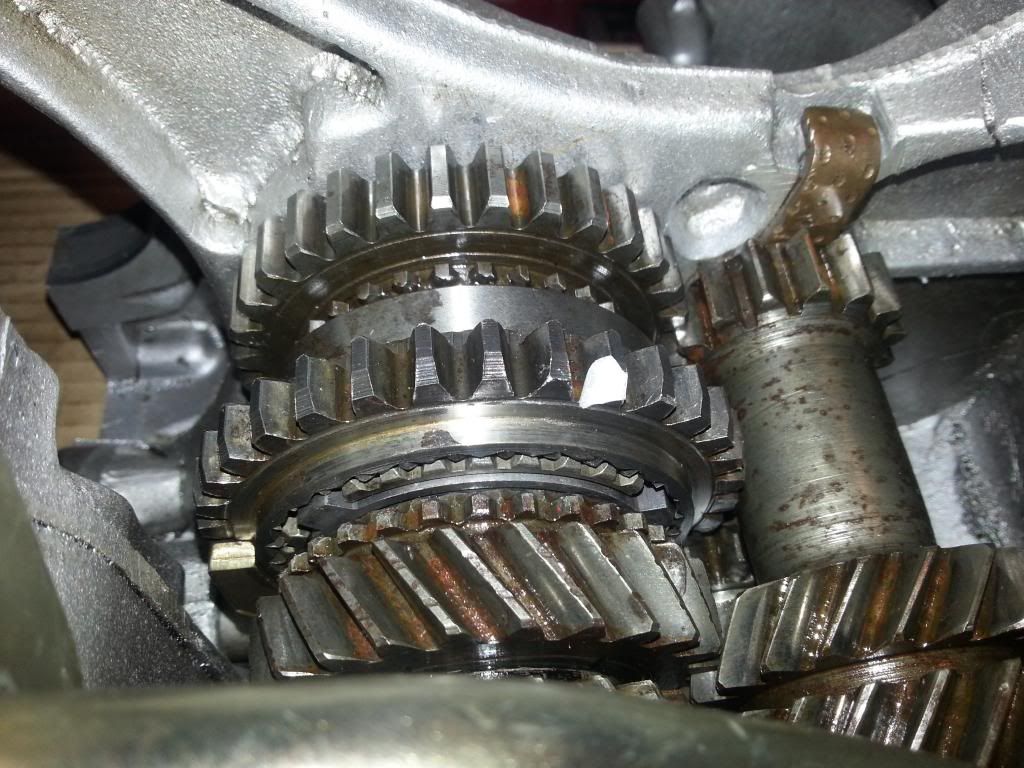

Just rebuilding my gearbox for the first time.
After many problems I had finally cracked it, then I actually cracked it.
Chipped a tooth off the 1st 2nd Syncro housing reverse thingy whilst tightening up the mainshaft.
AAArrrrrrrrrrrrrrrrrrrrr *angry**angry**angry**angry*
Picture and part number of what broke. I probably have a box full in the shed.
How are you locking the box to tighten stuff up?
Was locking the box in first and third. Loosly bolted the block to the casing for support whilst tightening.
PM me your address and I'll dig one out and drop it in the post over the next few days.
Lock it in first and fourth next time.

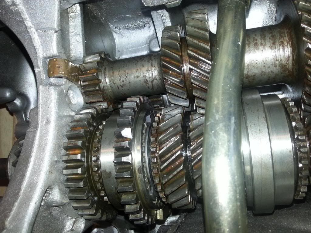

well, although ypu had it in 1st and 3rd, thaat wouldnt have damaged this, you must have had it in reverse as well.
4310 Posts
Is something not quite right there, 2nd and 3rd appear to be barely meshing.
He's right you know...
I bet the main bearing is not seated far enough

The meshing from input/first motion shaft to the layshaft seems to be inline though, so whats causing the rest to be out? somink not right

I see what you mean. Probably the main bearing not seated right. I wouldn't have seen it slip with the block attached. Definitely something to look out for when I put it back together.

Whilst undoing a gearbox i've had teeth shear off and come at me like bullets due to a knackered bearing. Top tip cover the box with a blanket when undoing the mainshaft bolts
