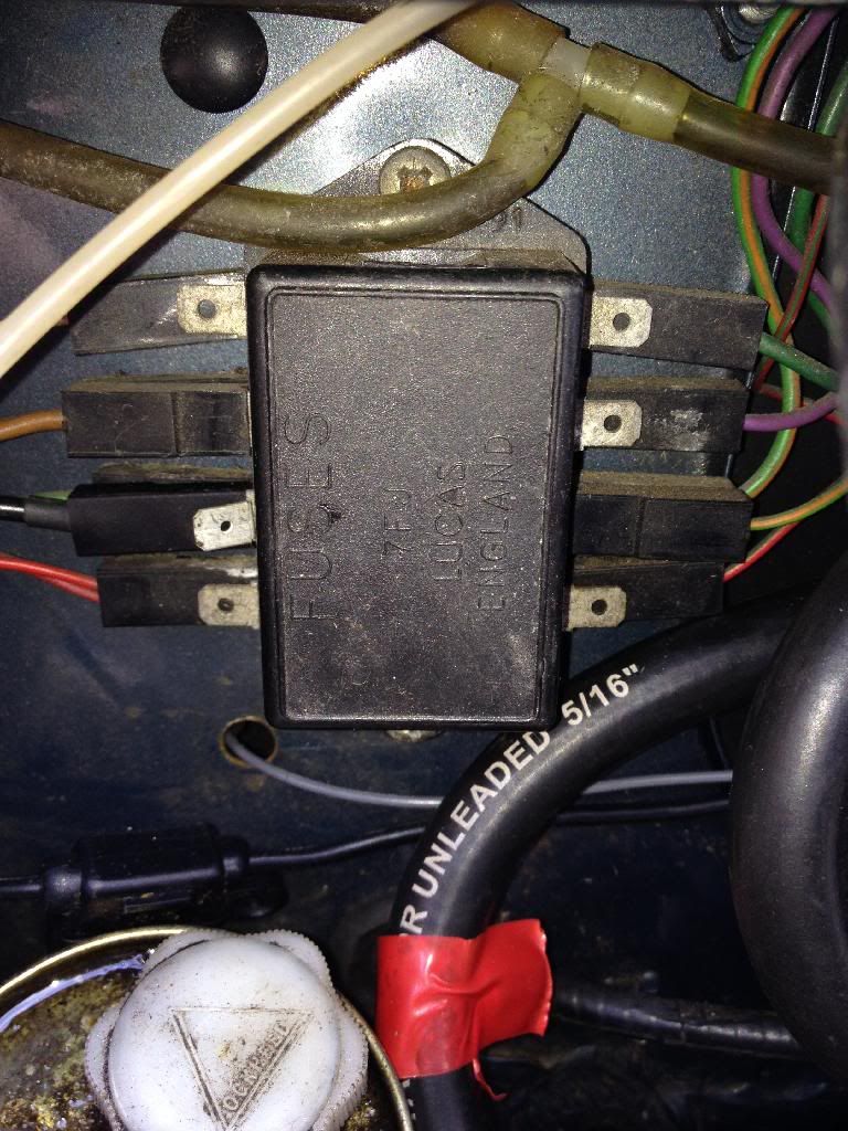

12th Apr, 2014 at 12:10:53pm
sounds like you have the MJ on a circuit that gets cut when cranking On 11th Feb, 2015 robert said:
![]() 1425 Posts Member #: 9199 Post Whore Lancashire |
12th Apr, 2014 at 12:16:01pm
You need a live that doesn't drop out on cranking but you already know this.
![]() 537 Posts Member #: 8926 Post Whore Sheffield |
12th Apr, 2014 at 02:36:48pm
![]() 3673 Posts Member #: 9300 Post Whore Quarry Bonk |
12th Apr, 2014 at 02:47:50pm
You should be taking feed from second ignition click, thick white wire coming from the ignition barrel. On 26th Jan, 2012 Tom Fenton said:
ring problems are down to wear or abuse but although annoying it isn't a show stopper On 5th Aug, 2014 madmk1 said:
Shit the bed! I had snapped the end of my shaft off!! 17.213 @ 71mph, 64bhp n/a (Old Engine) |
12th Apr, 2014 at 03:13:09pm
On 12th Apr, 2014 Carlzilla said:
You should be taking feed from second ignition click, thick white wire coming from the ignition barrel. But not directly from the ignition switch and it's wiring. 2 minutes with the multimeter will tell you which fuse will do what you need. On 11th Feb, 2015 robert said:
12th Apr, 2014 at 03:15:50pm
I don't have a multi meter guys |
