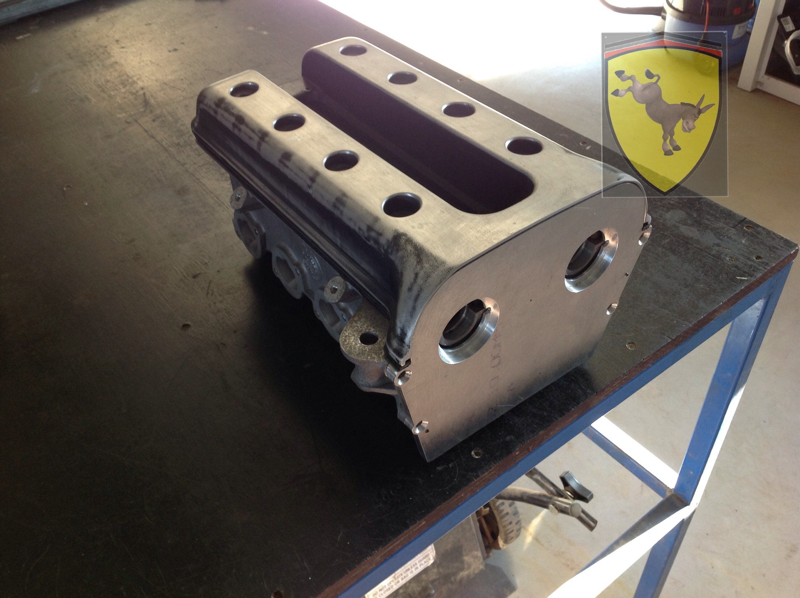

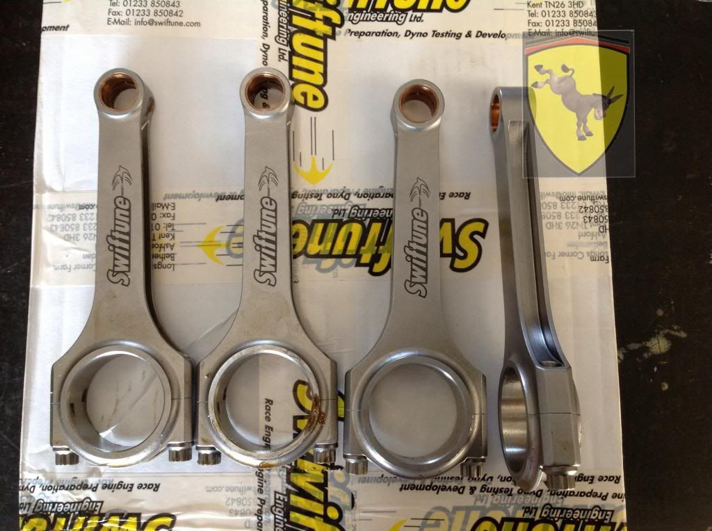

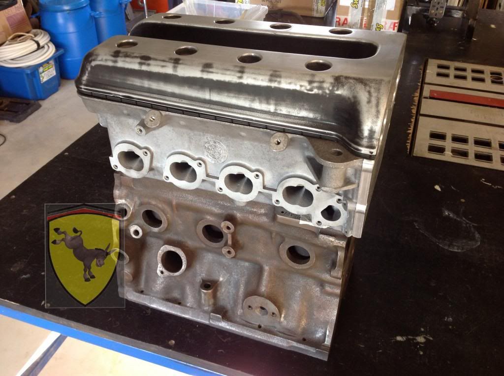

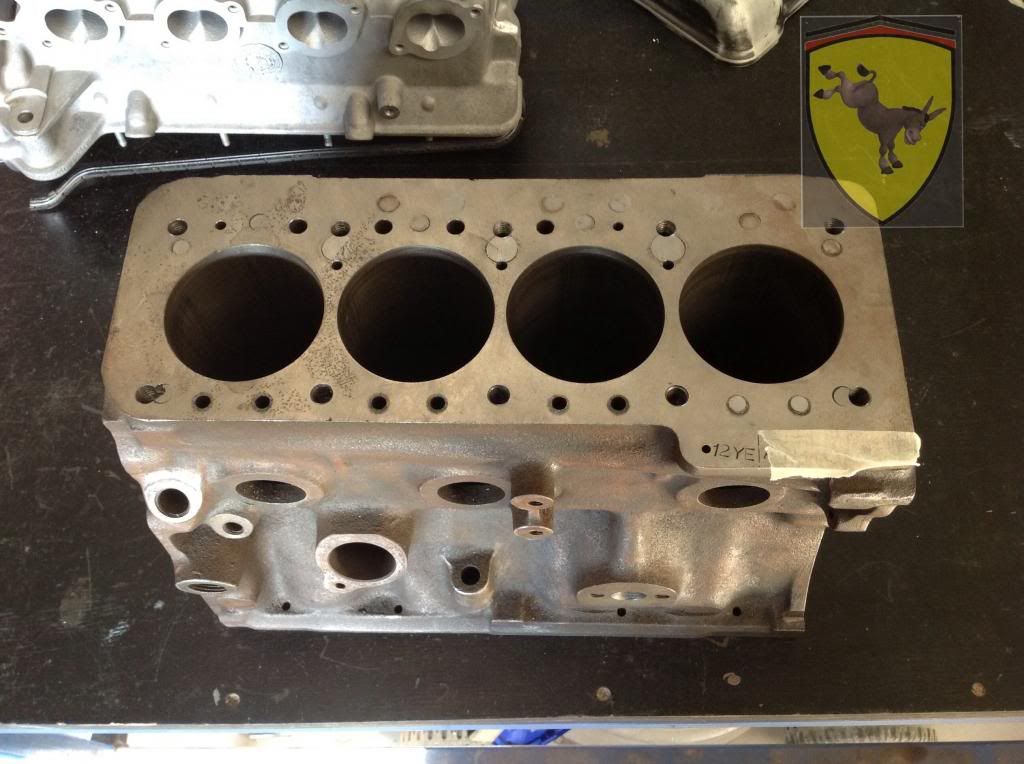

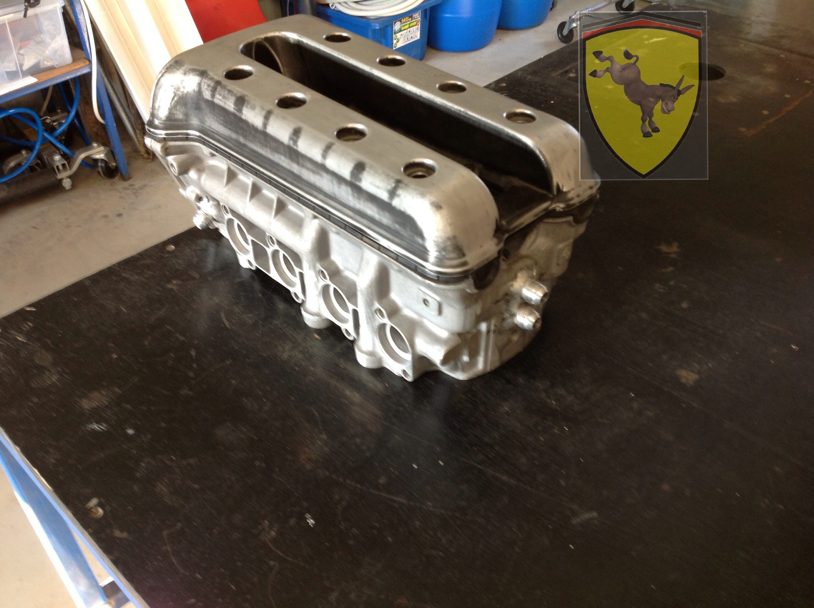

Hi guys, I have been an avid reader for a long time grabbing pointers and learning as I read. I have been also learning and getting help from Matt Read over here in Aus. So this is taking me friggin ages to get to this point and I will take a couple of years more to finish. Engines going into an 80 Moke, fuel injected and turbo'd. A few foto's of the stuff I have collected for the build.

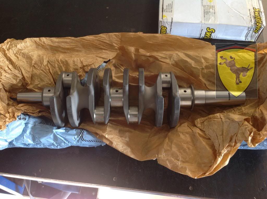

nice crank...

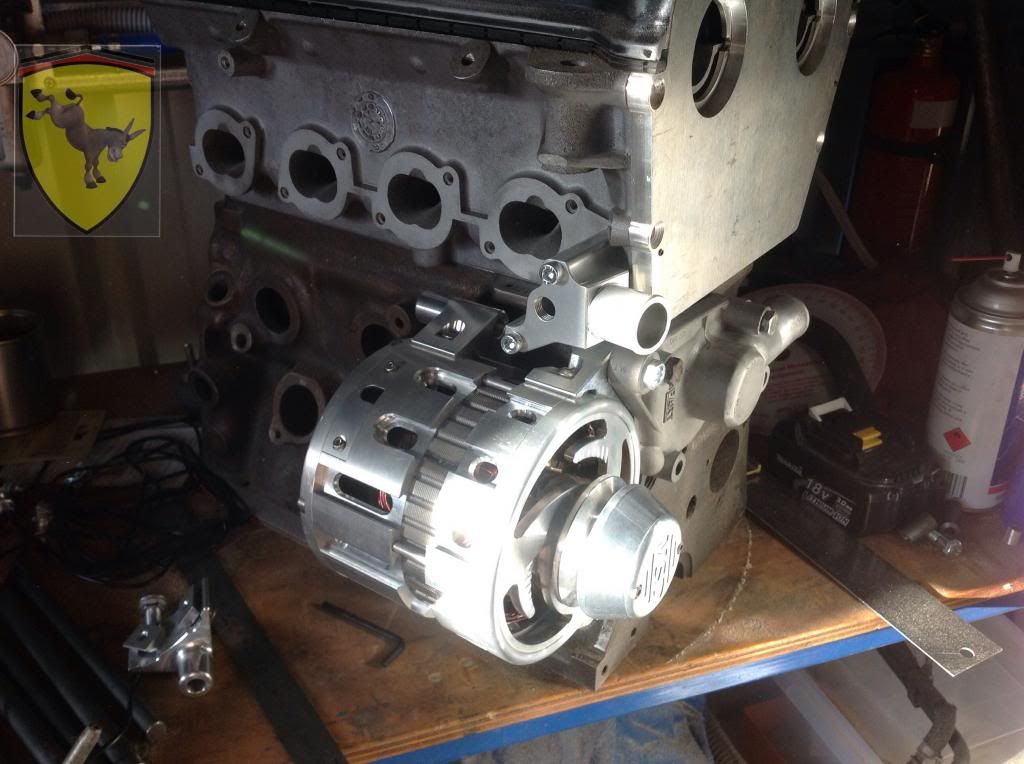

That alternator looks huge.

Interesting crank!
Thats the swift 5 bearing imitation crank isnt it?

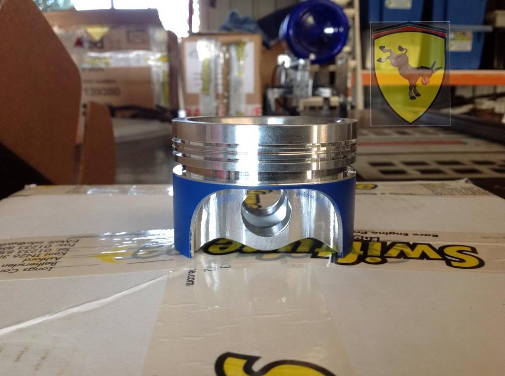

Look at those pistons... have you had those machined or are they made like that/ if so what make.. they look very much like a set of machines
d omegas to me

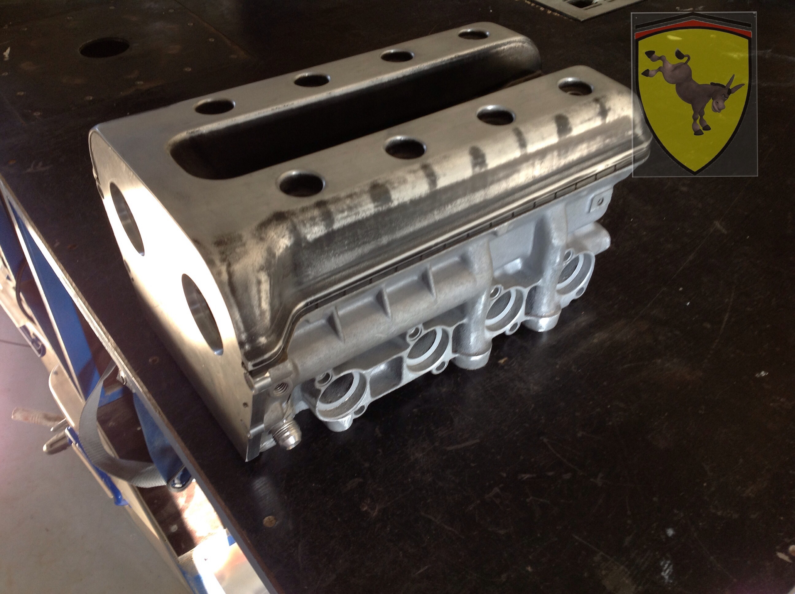

Thanks, yeah the crank is nice eh, hopefully it will perform when called upon. We're at the stage of trying to get a centre main cap made, I haven't really got too far with it yet, trying to do a 4 bolt design but with splayed bolts on the outer instead of having the two outside bolts parallel to the originals. Just before anyone pings me it is a k1200 LT head with an 1100 rocker cover .
Thanks for the welcome. The alternator is a bit big but I have space for it and it's billet, so I have soft spot for it.

Yeah Brett your right it is the DC5 set up. The pistons are a billet piston and one of Nick's design. They are nice and light and I had to wait two months to get them made. They're 40 thou over with a 15cc dish to get the compression ratio down. Hopefully they will go ok.

they are nice pistons indeed

I will second Brett, Nice pistons!

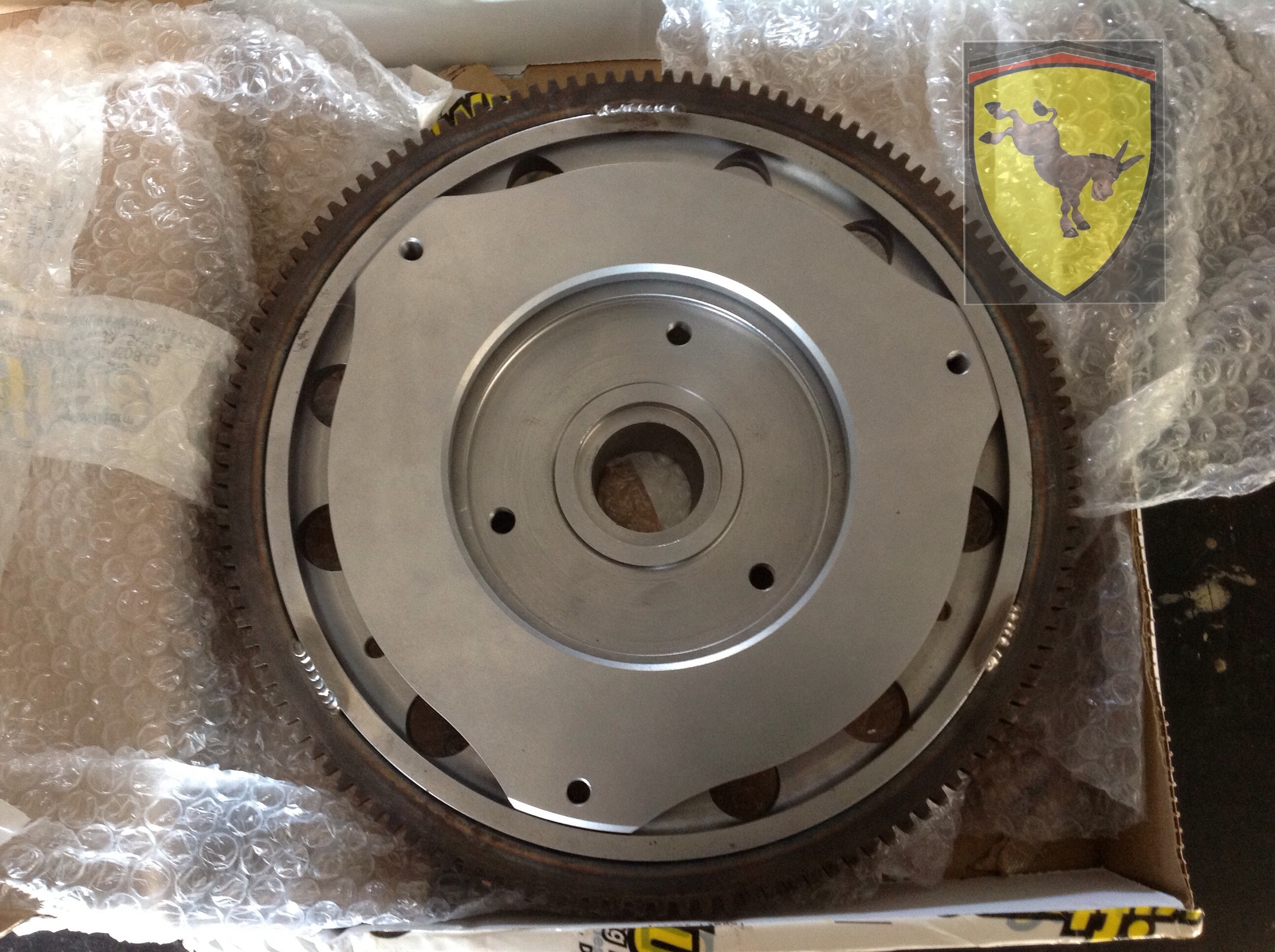

Nice. Thats not a Swifty flywheel is it?

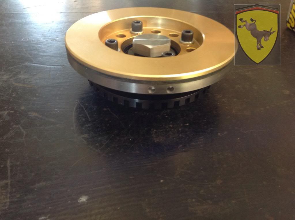

Yes it is a Swiftune lightened flywheel and backing plate, I think it's made to the same spec as the works rally flywheel? In fact the only things that aren't from Swiftune so far are the MED balancer and Matt Read's kit. I trust people who race.

ah, I see. Why did you not go for his Super lightweight flywheel?
Well I am by no means a competent engine designer or builder, so I try and listen to those with more experience but I do think though that the lighter pistons and rods with the albeit lighter flywheel will be enough. I have heard a few stories of ultra light flywheels stalling easily, having to rev it hard to take off. Swiftune suggested this would be a good match for what I want. But I will add that I have never driven a car with a super light flywheel so I can't speak from experience.
