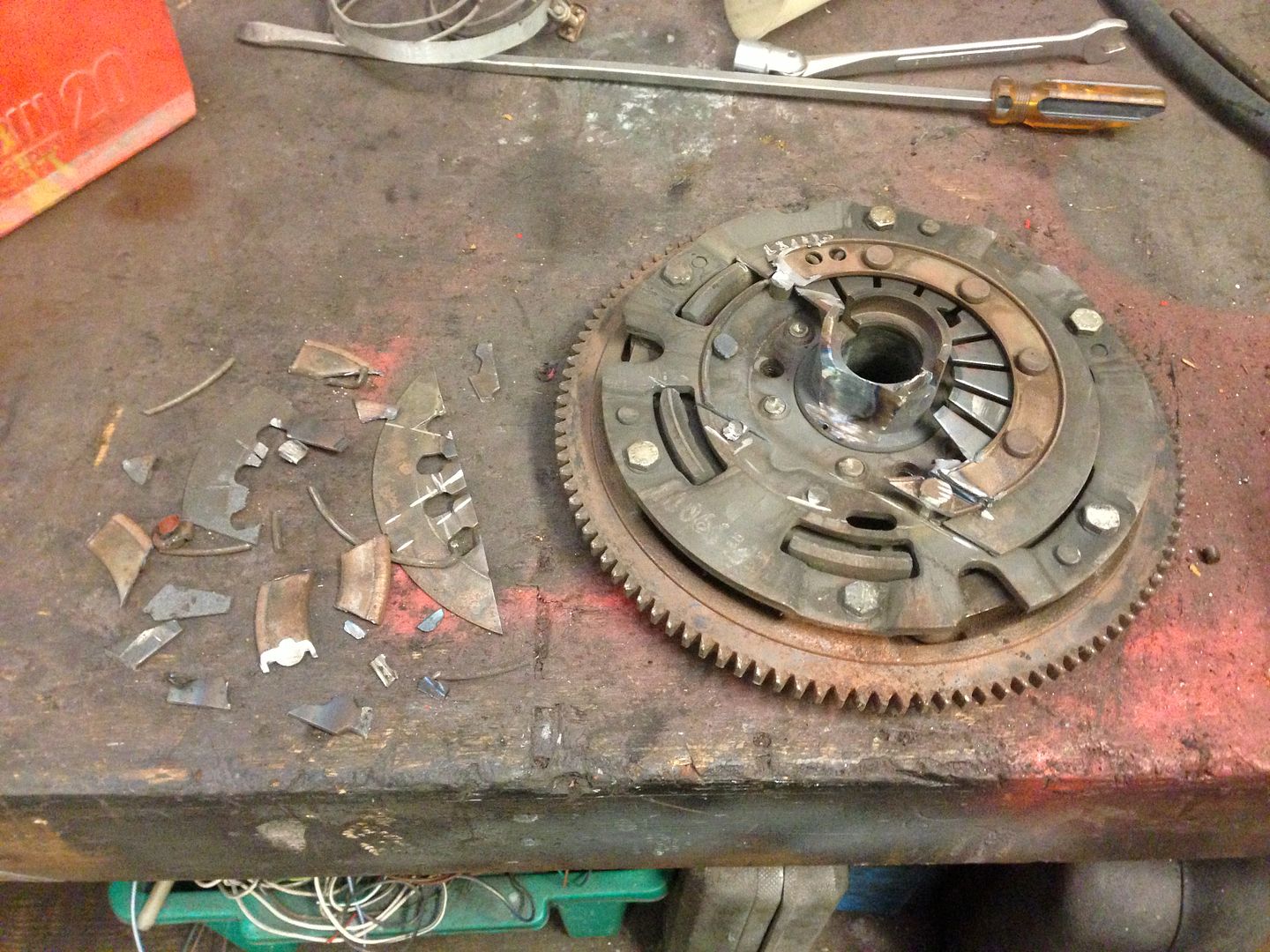

324 Posts Member #: 9441 Senior Member South Devon |
22nd Apr, 2014 at 08:35:36pm
This is what remains of the last flywheel I removed. After multiple attempts to heat it, pull it and hit it it was going no where so it had to sacrificed.
2406 Posts Member #: 341 aka T2clubby South Staffs |
22nd Apr, 2014 at 08:35:48pm
This shows how far they can jump

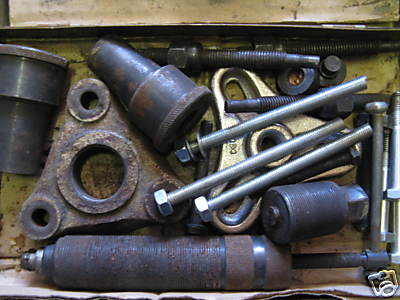

166 Posts Member #: 9128 Advanced Member |
22nd Apr, 2014 at 11:25:40pm
This is the set you want Edited by DILLIGAF on 22nd Apr, 2014. |
