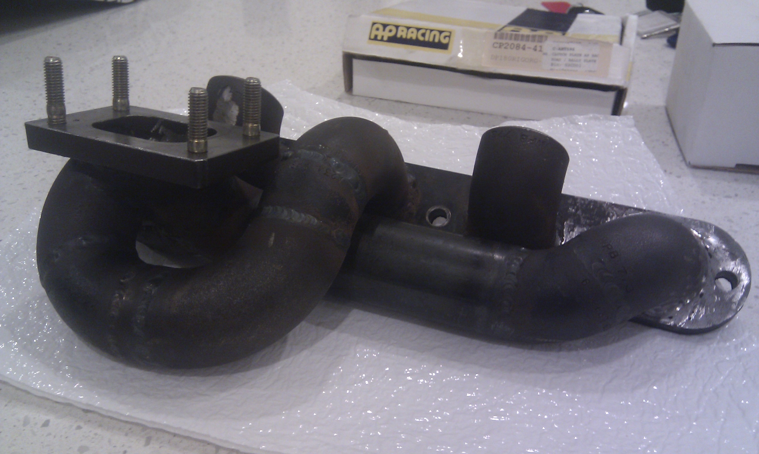

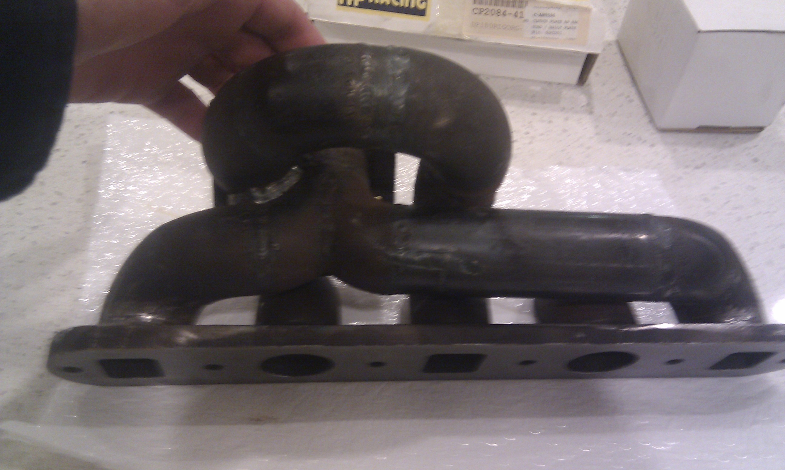

Here are some pictures of the engine and gearbox build to date.

The exhaust side of the manifold is built. I have separated runners 1 and 4 form the runers for 2 and 3 so I can check EGT or AFR for fuel distribution.
