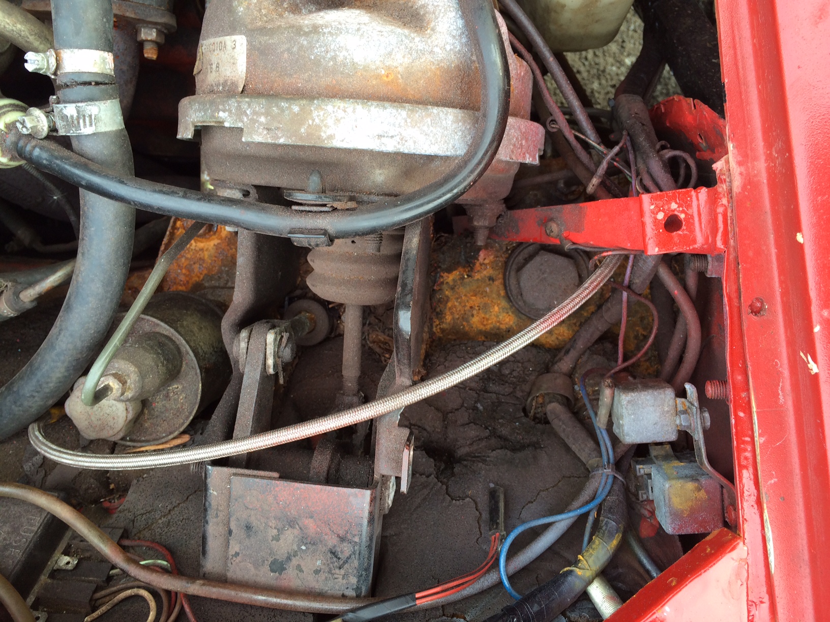

Pulled the mini out of the garage for the first time in howeverlong and noticed the bulkhead has got super rusty.
What should I do to sort, and/or how much am I looking at for someone clever to sort it?
bleh.
Clean it back, ku rust, then epoxy primer and paint.
