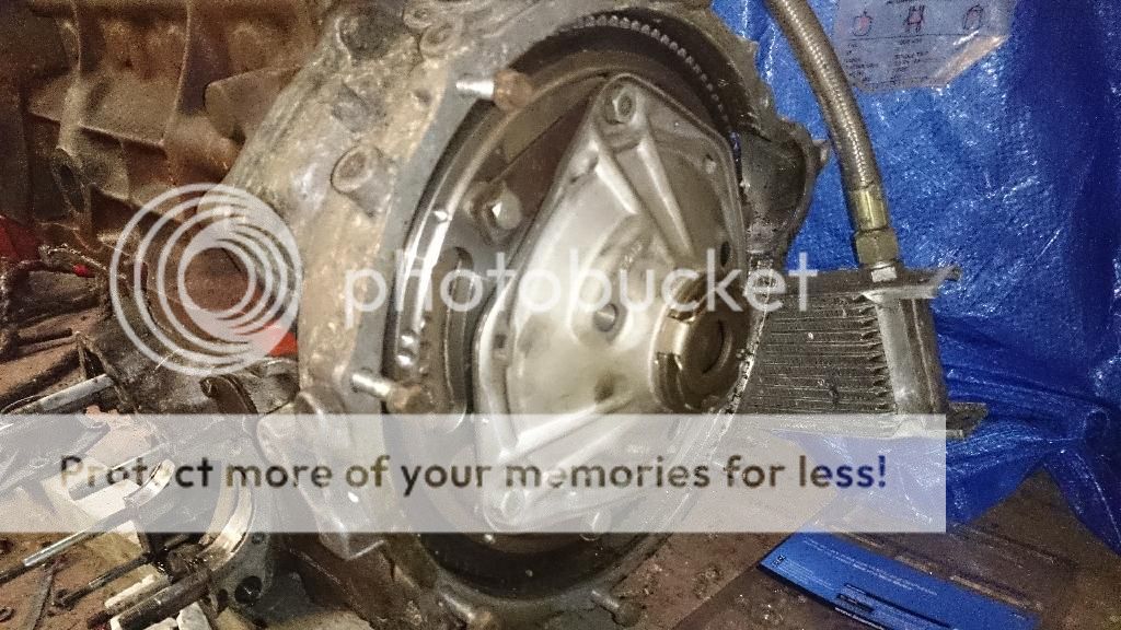

Just had a thought I took the wok cover off when I was checking to see if it had a lightened flywheel:
Does that help answer any questions? Only picture I have with the wok cover off
That part looks okay to me, but you can't really see if something behind it is wrong.
