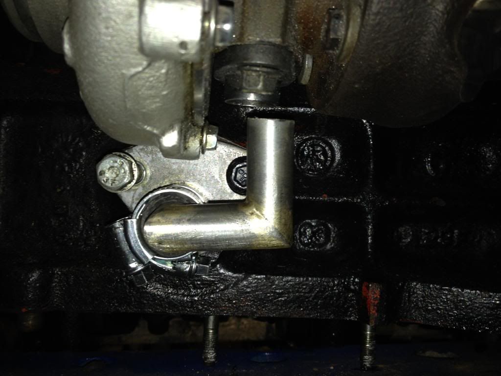

Drain is 16mm

16 is small, stock is 3/4 so nearer 22mm
Have you got a picture of how it's plumbed?

Hummm that's a tough one if say, it's a nice simple shape but it is 16 mm.
Wait for some other options on that one

Yeah it's the same diameter as the pipe coming out of the turbo which is why i thought it would be ok.

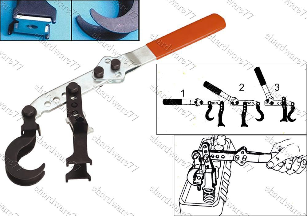

Can they be replaced without taking the head off? make some sort of compressor that comes off the head studs?

id think if the piston was tdc and you could push the top hat down to relese the collets your away depends how far the valve moves till its held up maby not enugh to get the collets out?

http://img.diytrade.com/cdimg/925697/10203..._Compressor.jpg
http://76.my/Malaysia/rocker-arm-stud-ohv-...aronngu77@1.jpg
Both of these could work i think
