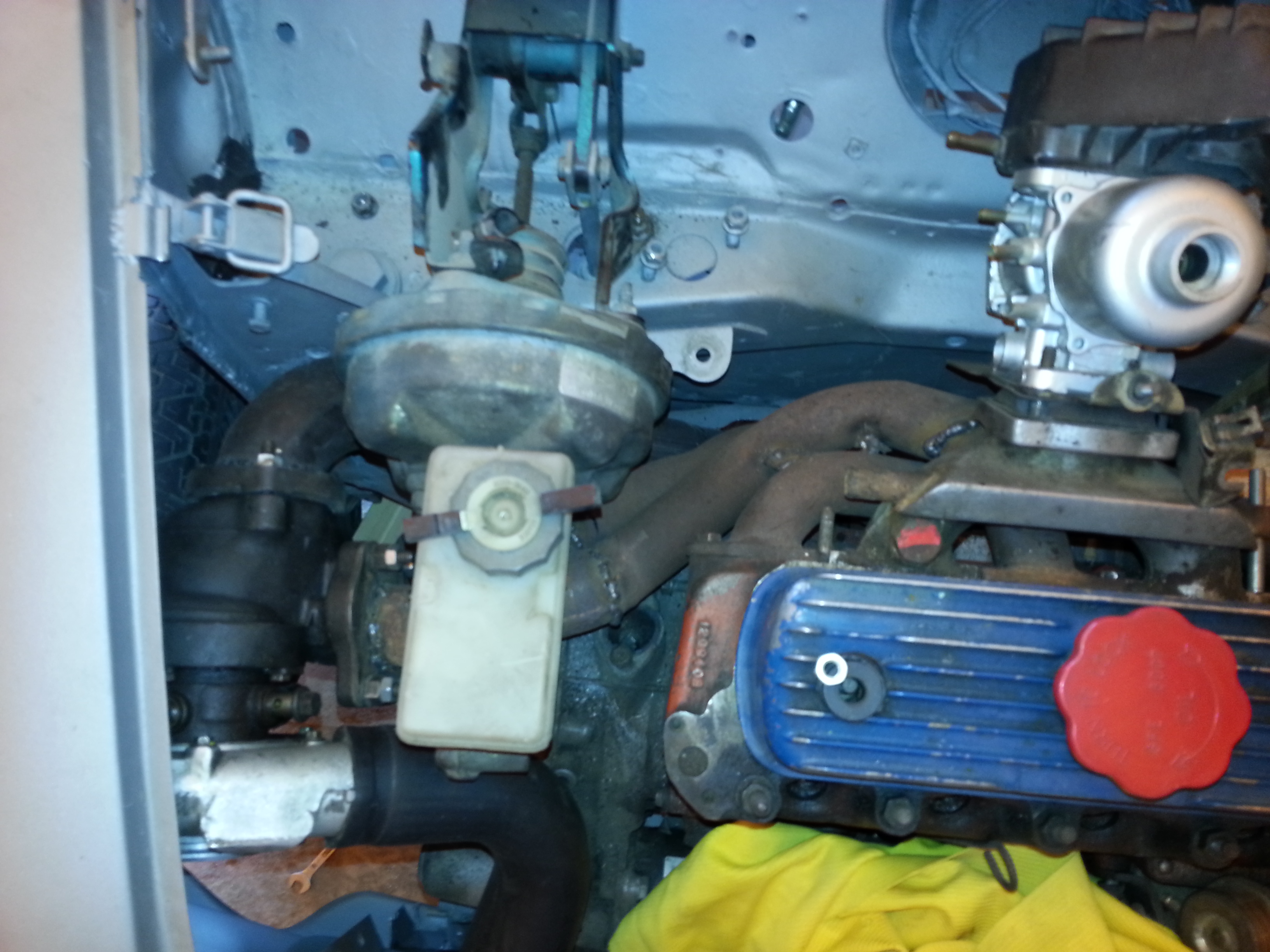

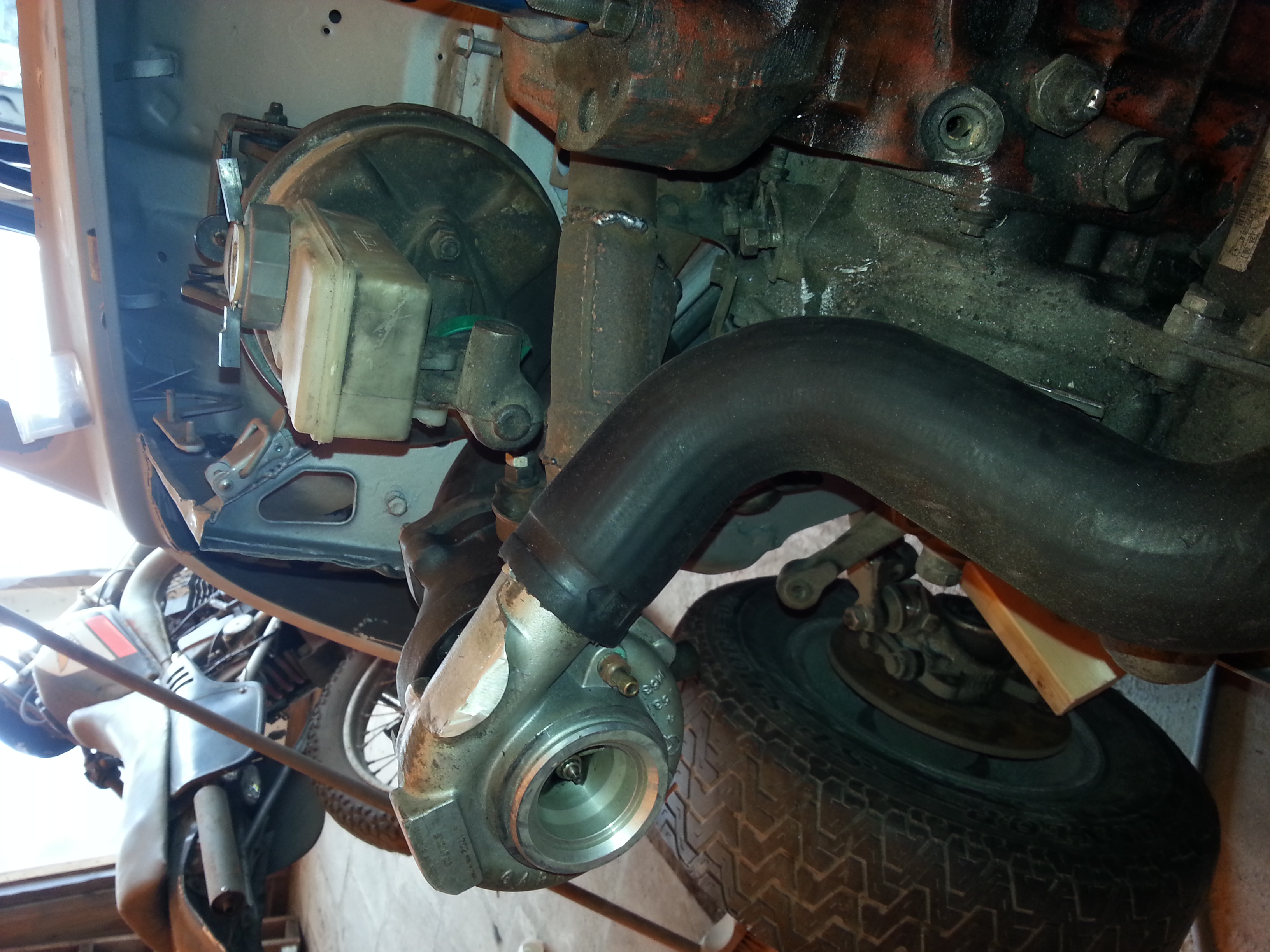

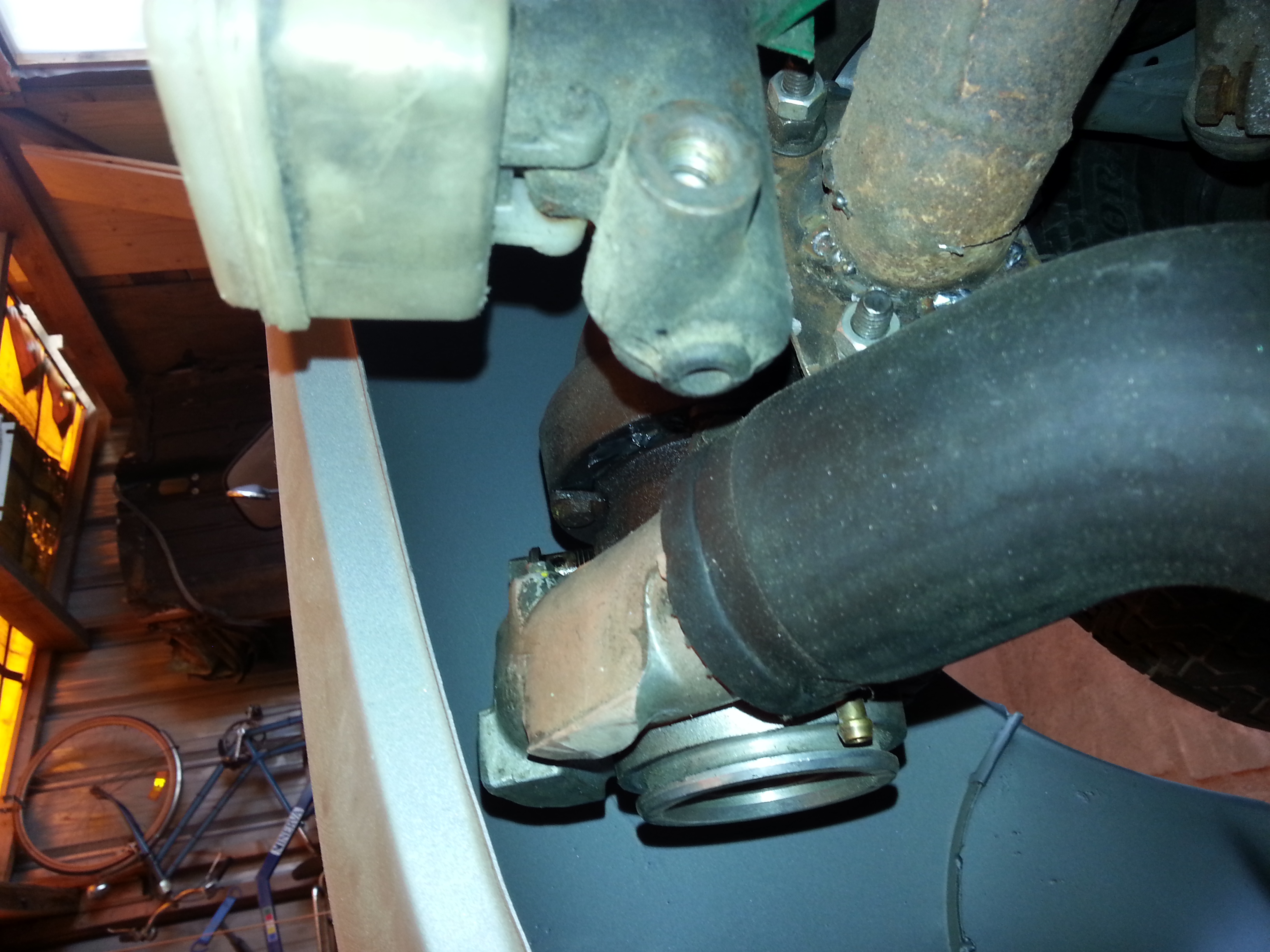

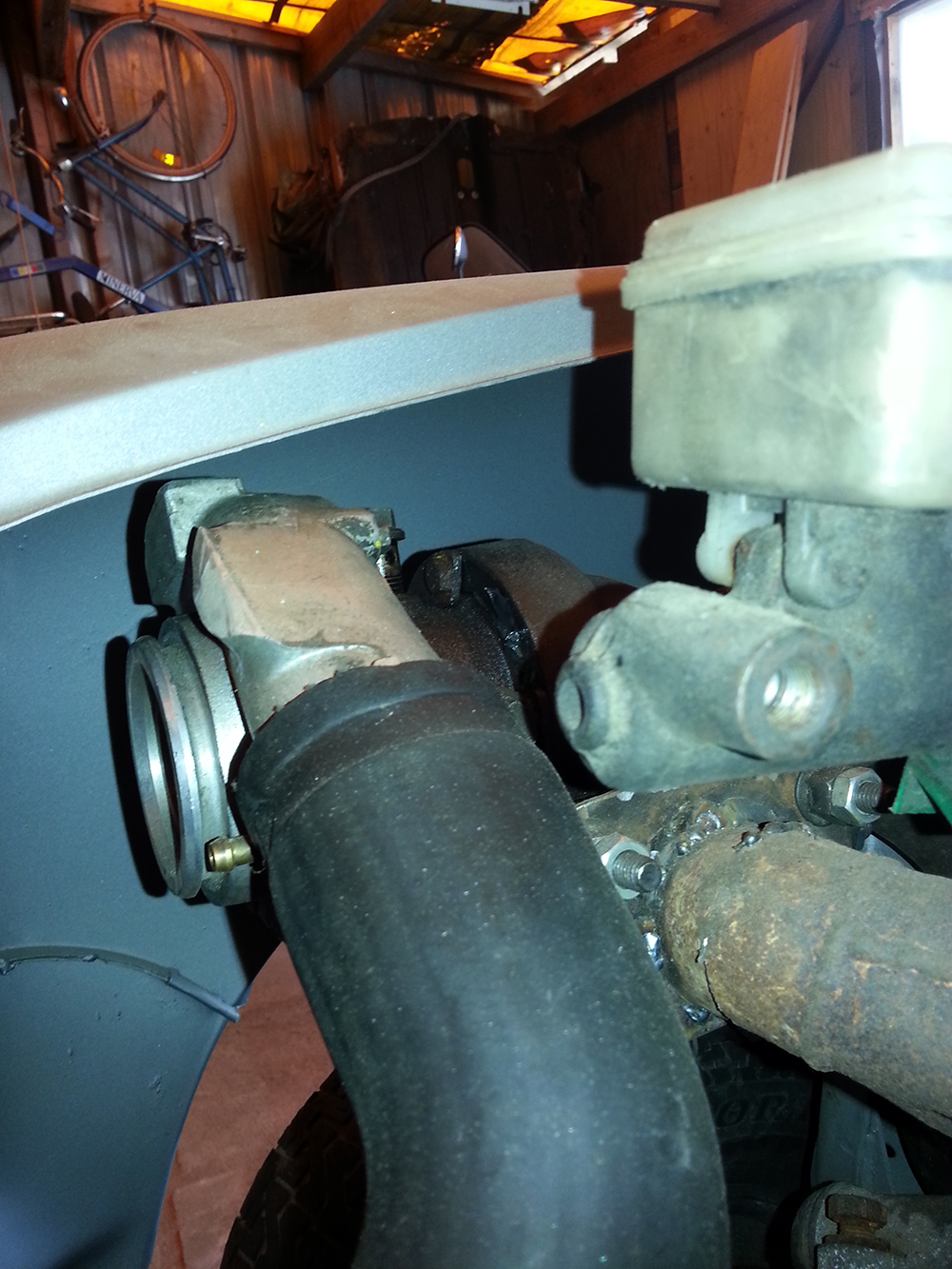

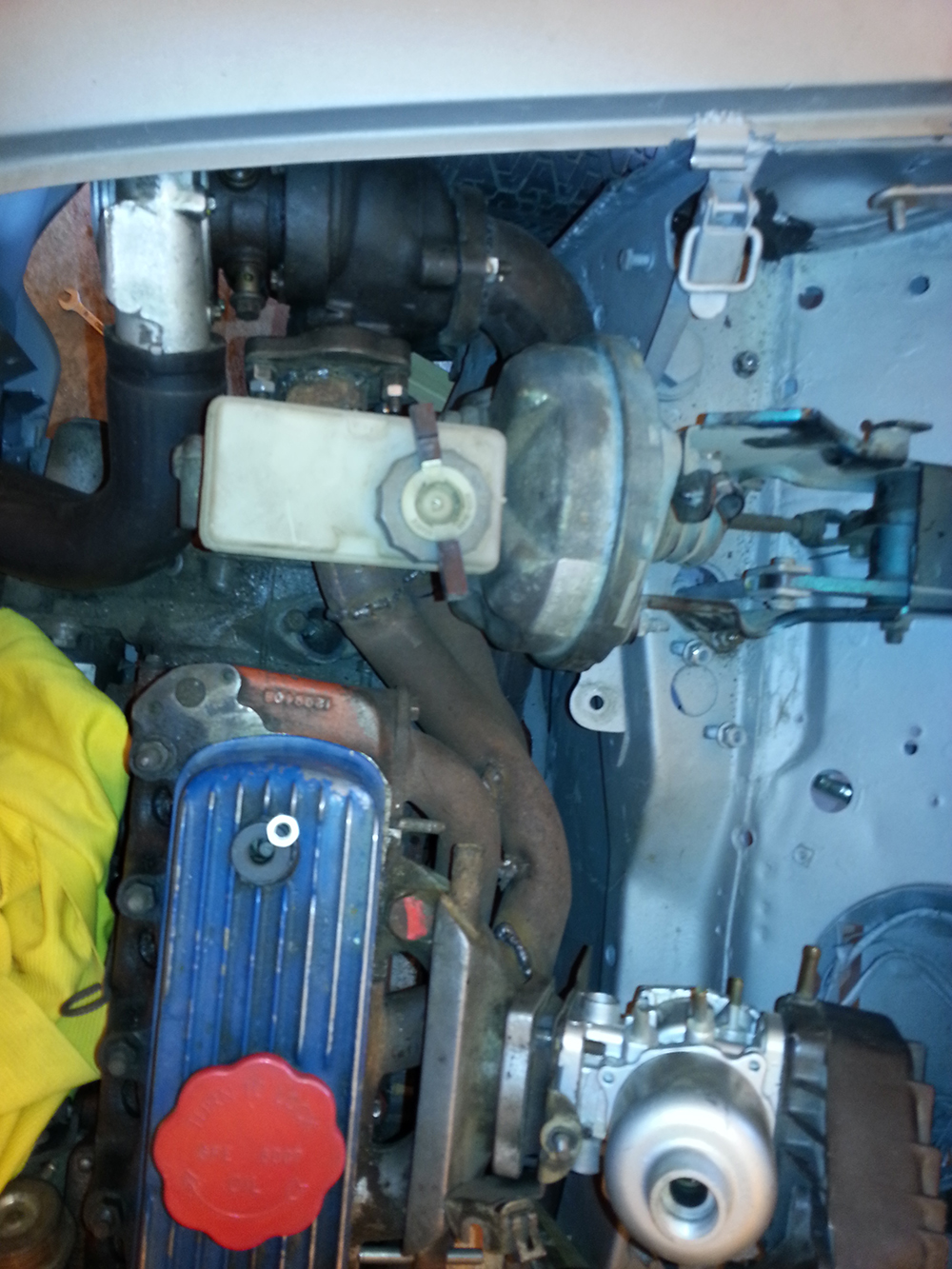

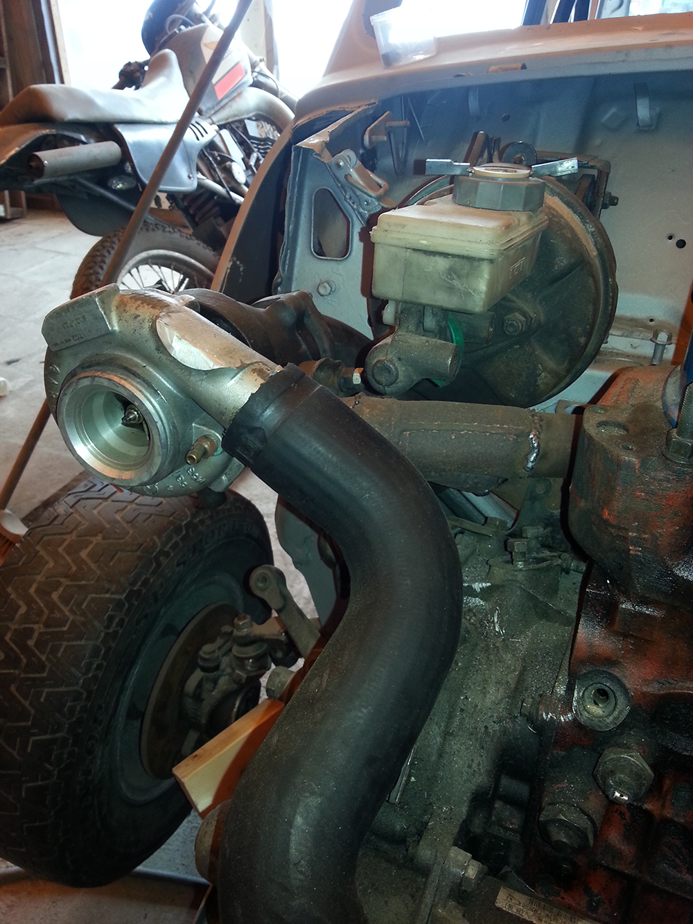

If i put on a heat sheald on can i get away with this or should i remove the servo and relocate the turbo?
Would like to keep it because its left hand drive and its quit some work to get it out ( bar acros to operate the servo)

Couple of good heatshields and some wrap around the manifolds and you'd be fine I'd say. Or see if you can reroute the pipes a little further away from everything.

The exhaust pipes ? Maybe i can make them bit longer so the turbo sits more in the wing
is stainless steel a good heatshield? .
Edited by Rammie2000 on 14th May, 2014.
Yeah, just try and move the turbo away from the master cylinder a little bit more, and stainless is pretty good as a heatshield. I Think it was wintersurfer who used an old stainless saucepan as a heatshield for his turbo to good effect.

i looked at it an can move it away for another 4 cm easy.
i seen gold heat shield foils to... its stuf that works or just some bulsh....t ?
