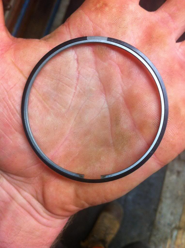

for anyone interested thought id post a pic of the top ring
seam to be doing well gone from 180psi cranking at time time of assembly (engine just built not fired) to 220psi after being run for about 750-1000 kms
