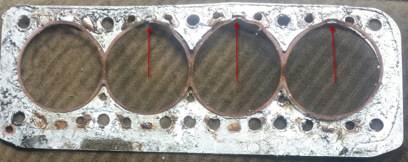

This is the state of the gasket:
Was only cylinder 2 that was blowing, although plenty damage to 1 and 3 also...
I'm wondering in the fire ring went slightly out of alignment when i torqued down the head and that could explain the damage to all 3 cylinders? Or its seen way too much boost somehow?!
I wasnt data logging at the time so couldnt tell you AFR's or boost levelsbut the timing is fine. I'm going to buy the MED gasket and do some runs with the laptop scope / data logging to check everything is as it should be.
Holy smoke...
When I said I experienced a failure of one of those gaskets, it certainly never looked like that.
At first glance I am thinking of two possible issues. Firstly, poor cylinder head clamping and second, Detonation.
What sort of ignition advance do you have when on boost?
What head studs are you using and what do you torque them too? Do you use the correct torquing sequence?
Edited by Sprocket on 18th May, 2014.

Did you drive over that repeatedly before taking a picture?
I'm seriously wondering whaaaaat the fuuuuuuuuck....
Holy shit, what's happend there!
I never had a problem with my SC gasket. Did you anneal it before installing it, and each time it was fitted?

Wow. I've had a few head gaskets go, but that is on a whole new level.
