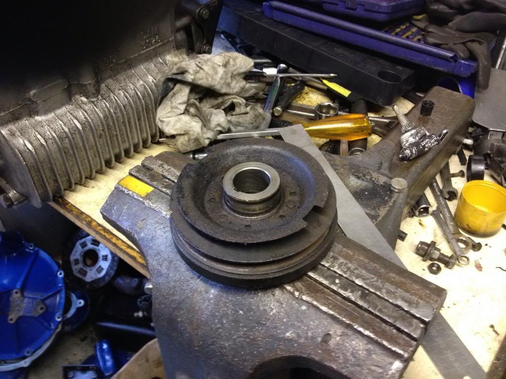

A mates just built an engine and he's got a problem with the pully.
When he tightens the nut it stops the engine turning over.
But We carnt really understand how it's possible. Any ideas?

Try another timing cover or try to remove the plate in the back of the pulley...

Thanks for the help all sorted now. I had to hammer the pins out the pulley to get the inner flange off. So thanks again.
