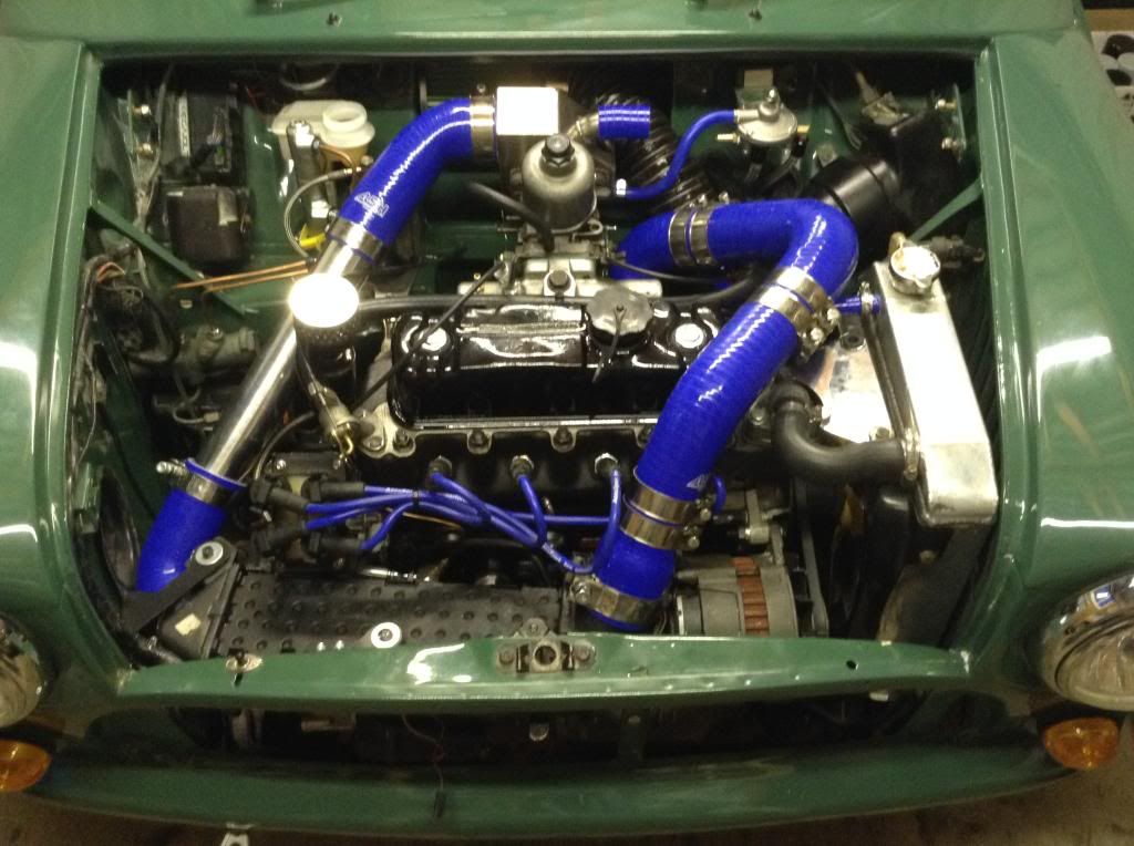

Personally, i'm running a seat ibiza cooler sitting above the starter. Only fits though as i'm using megajolt. Plenty of guys are using cosworth coolers as well

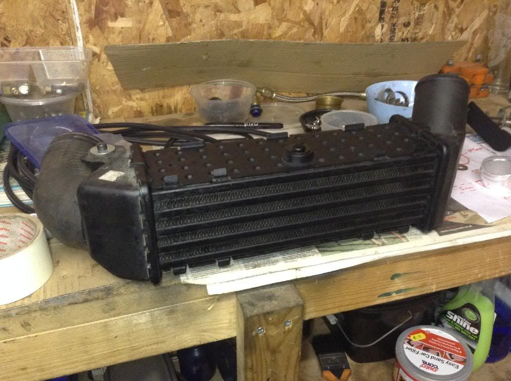

I second the Seat intercooler.
Its a tight fit but will go in, thanks again to Rob Gavin for the advice.
Hope the pictures help with your choice.
