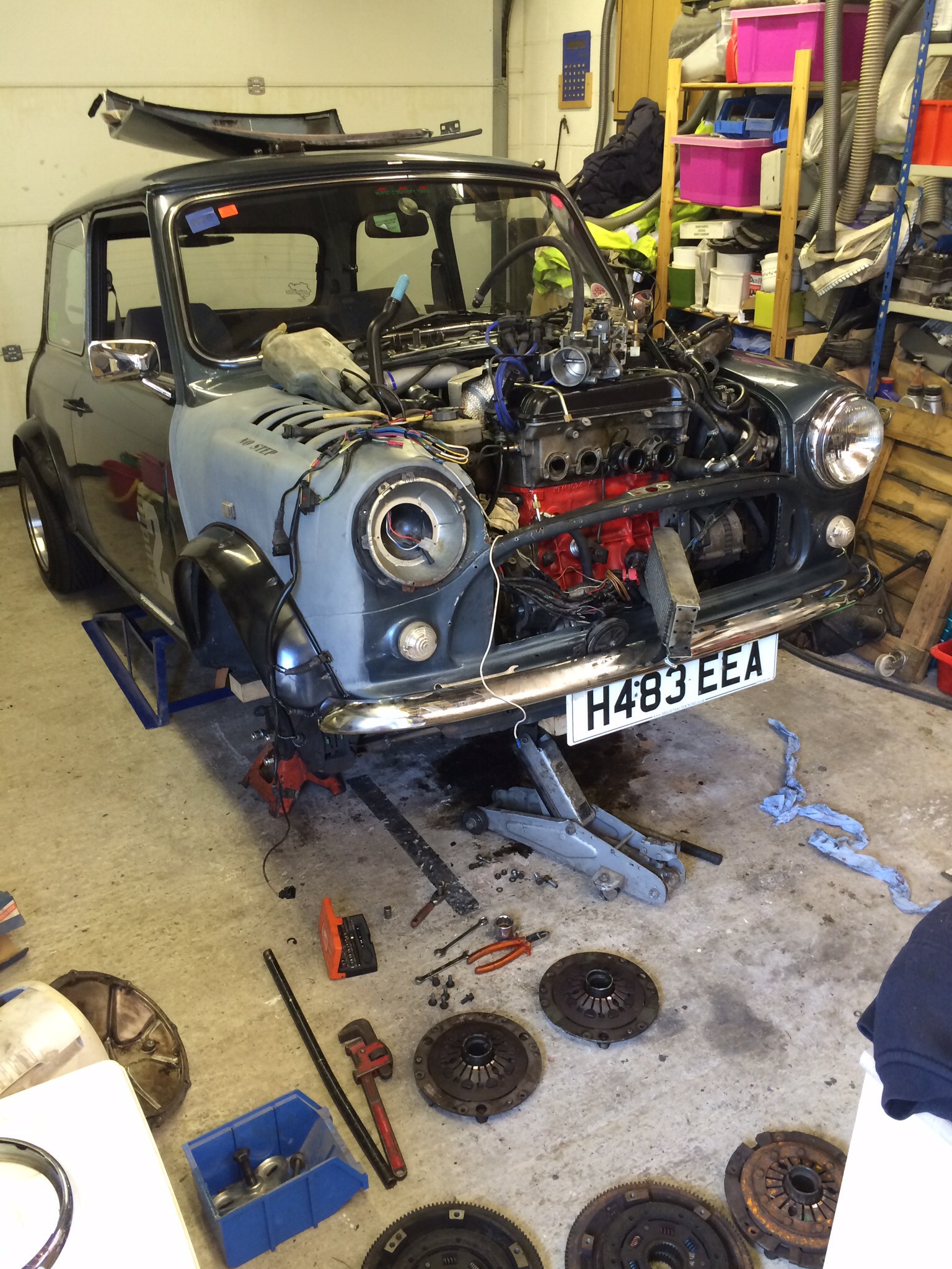

Still in DIY development, recent adjustments and tuning pushed it past the ability of the standard verto clutch, currently working on the rts twin spring set up.

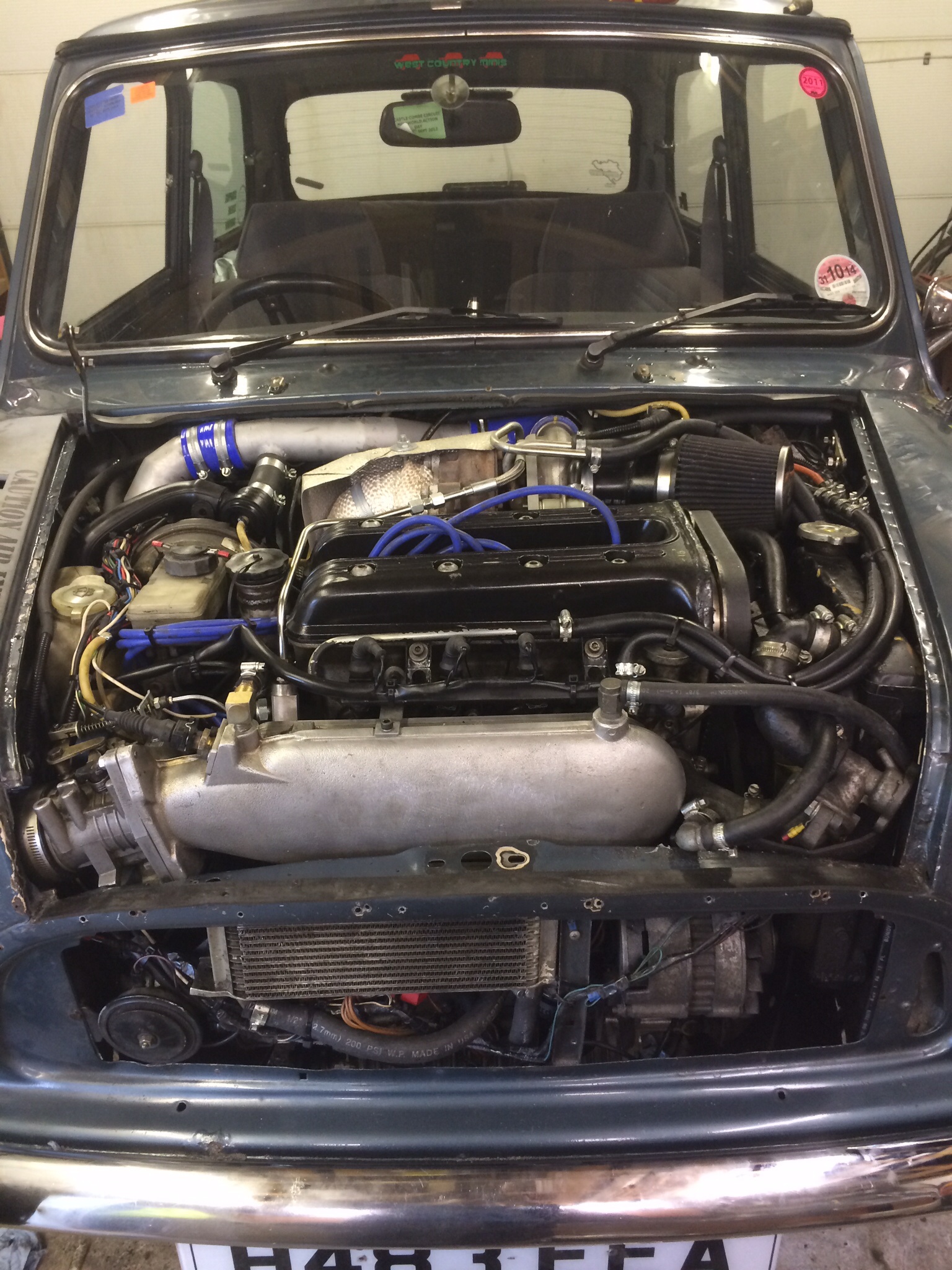

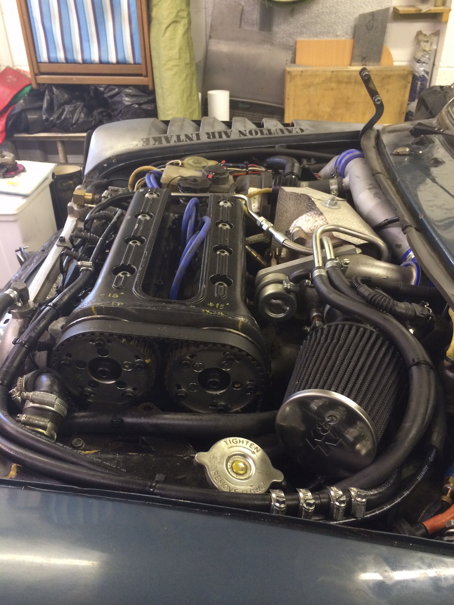

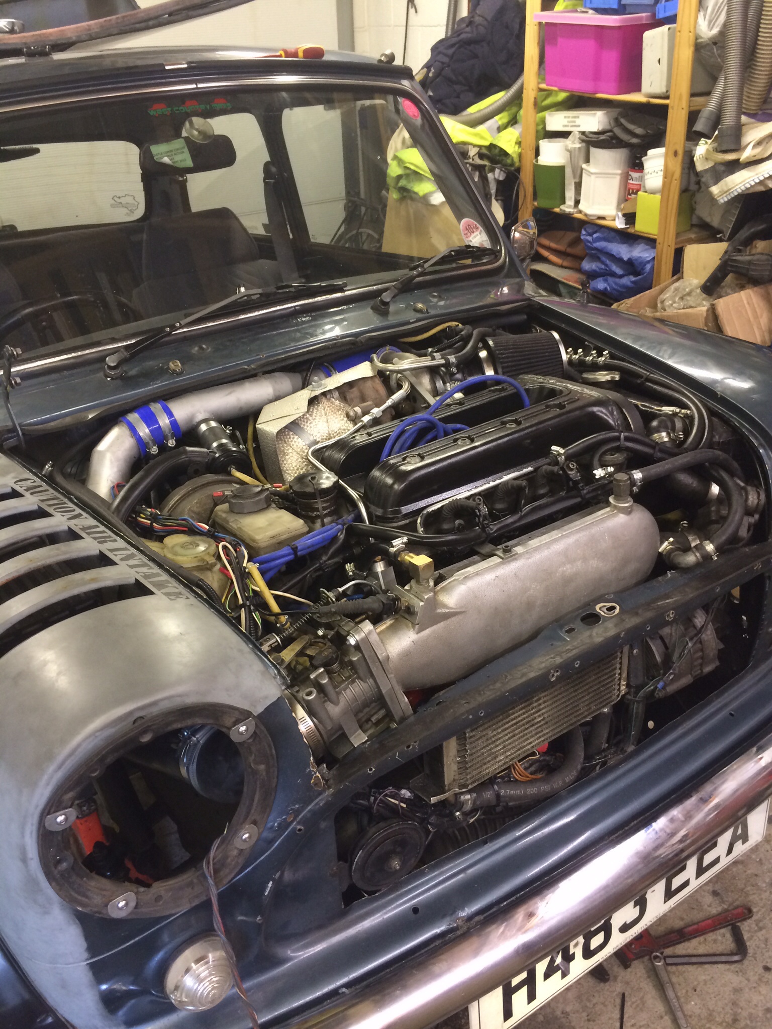

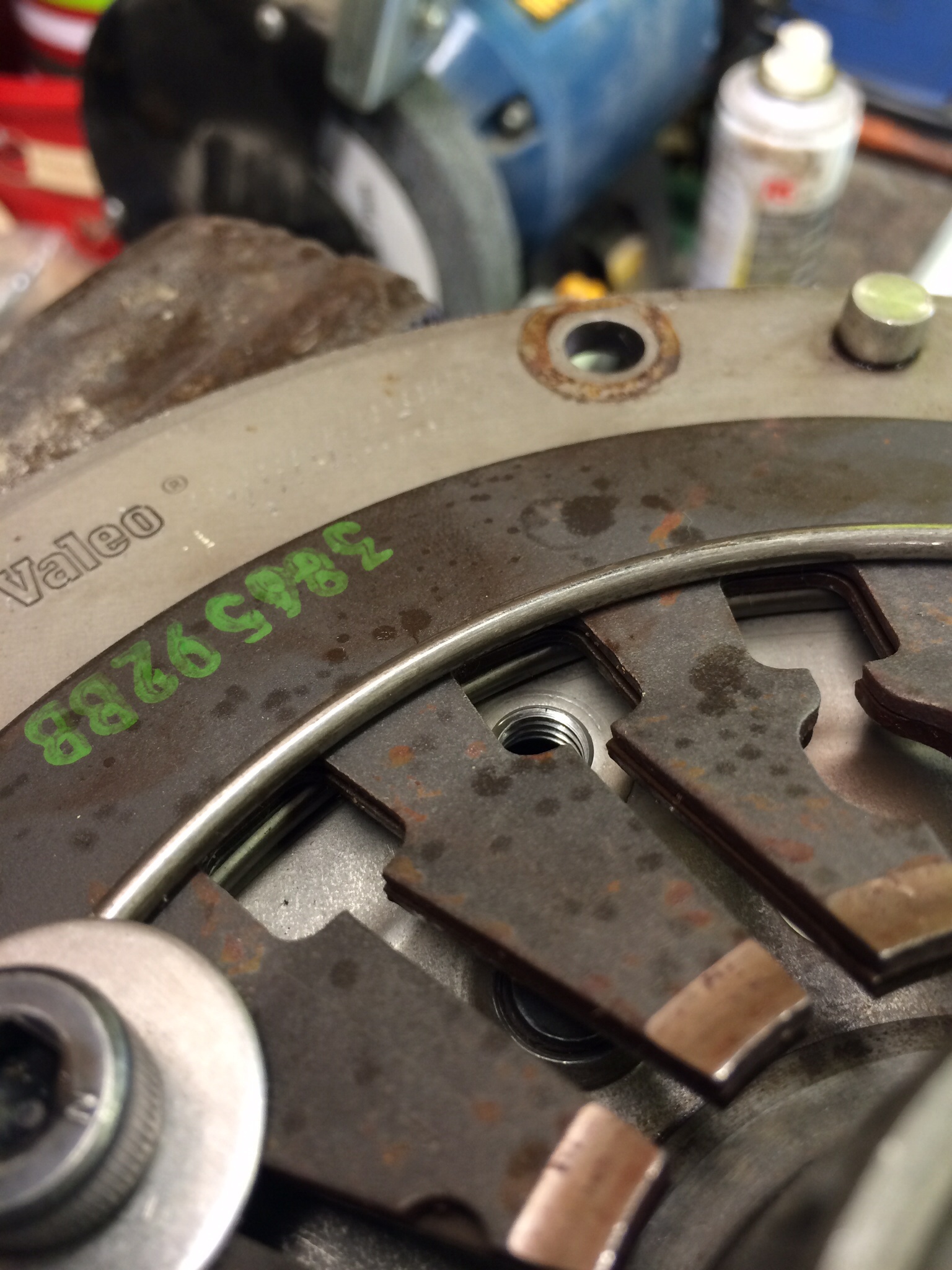

All back together, road tested, rts clutch feels like a normal clutch just with a heavier pedal. Brilliant.
Here's the engine bay, you can see why the intercooler wouldn't fit.
4310 Posts
Nice, whats the spec?
looking good ............... you have a few clutches there, hope your not going to burn all those out .....lol
I hope this wasn't the final sprint position. You will struggle to get it off the flywheel if it is...

Hmmm, what have I done wrong?*surprised*
It went together nicely and it's in and working. *oh well*
Edited by Nick king on 22nd May, 2014.
Nick king
65 Posts
Member #: 9646
Bristol England
I've just realised what you were getting at, the puller holes are in the right place when I finally assembled it. Thanks. *smiley*

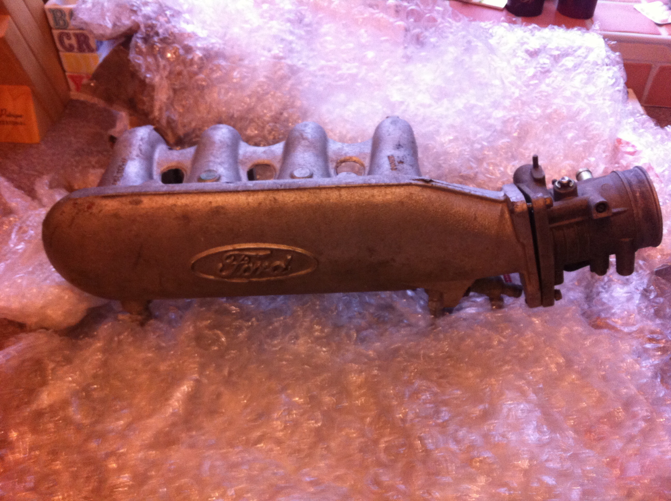

I think I saw this a Combe? Did that plenum chamber fit straight on?
Nicely done. I'd have ditched that servo though *wink*
Interesting plendinulum. What is it off?

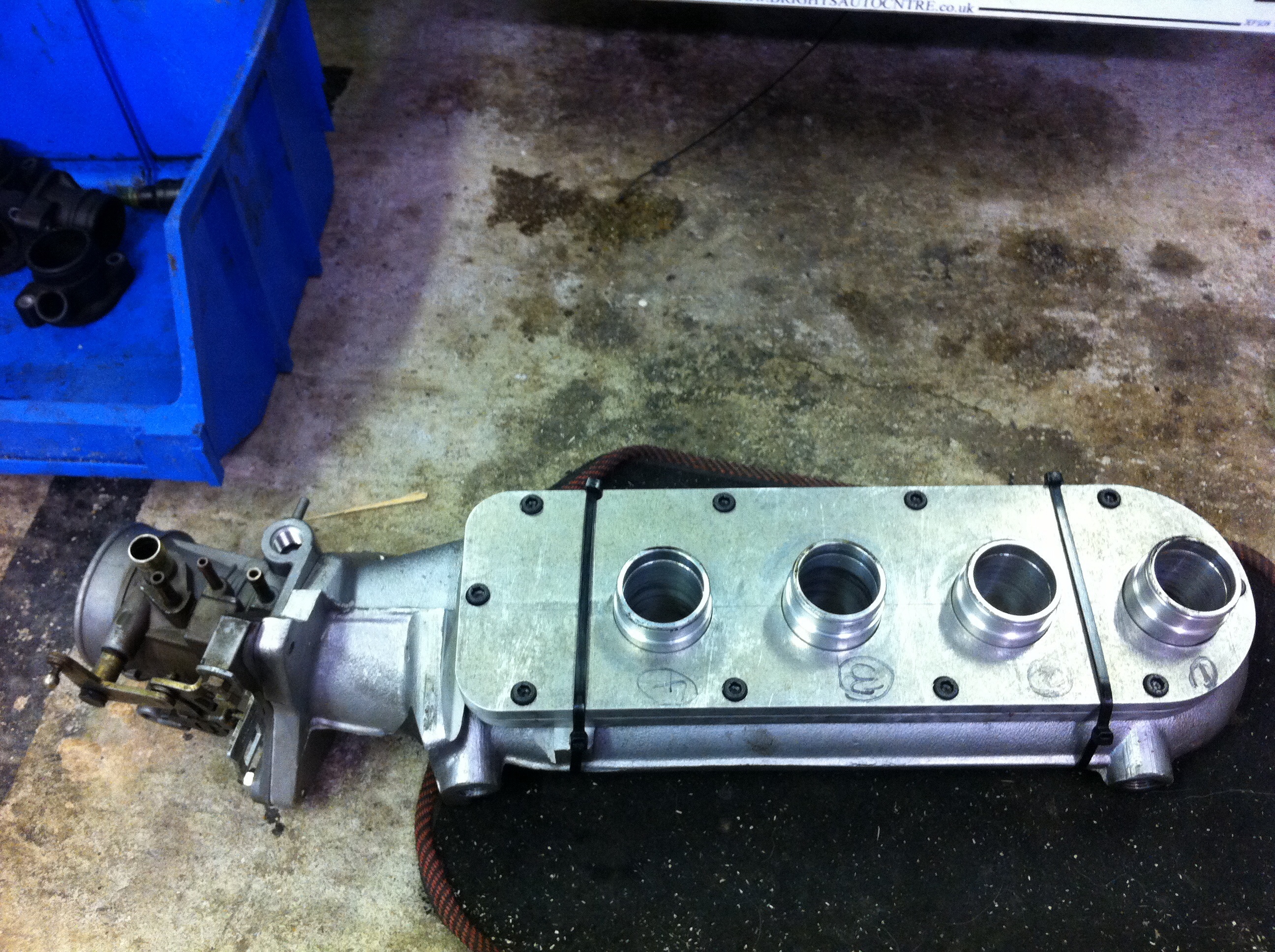

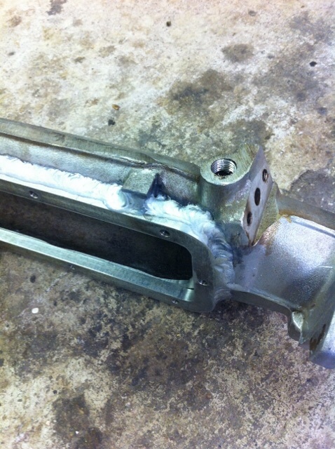

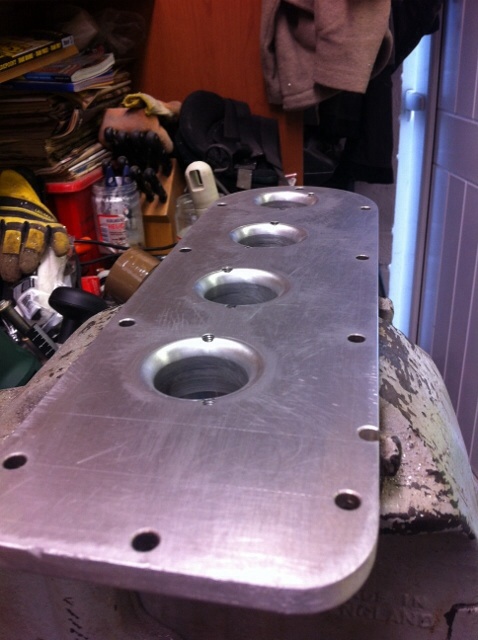

The plenum is from an old escort xr3i, modified to fit, I'll put build pics up later.

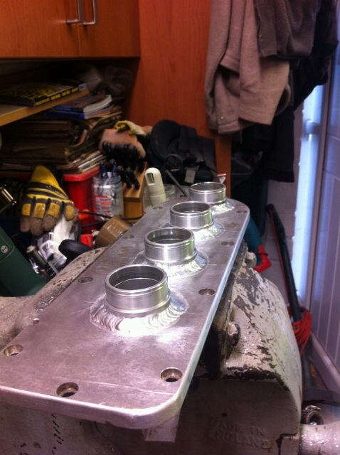

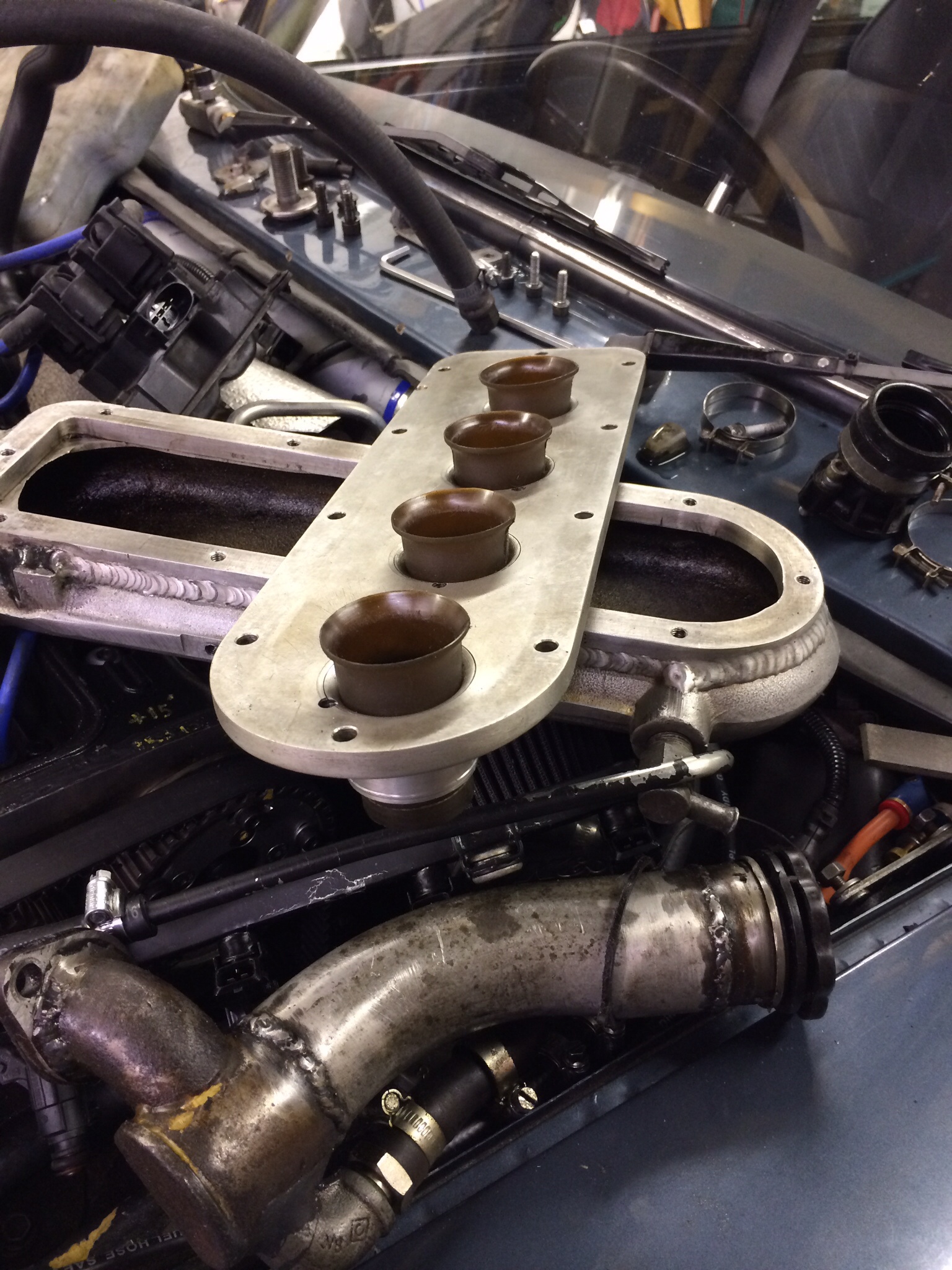

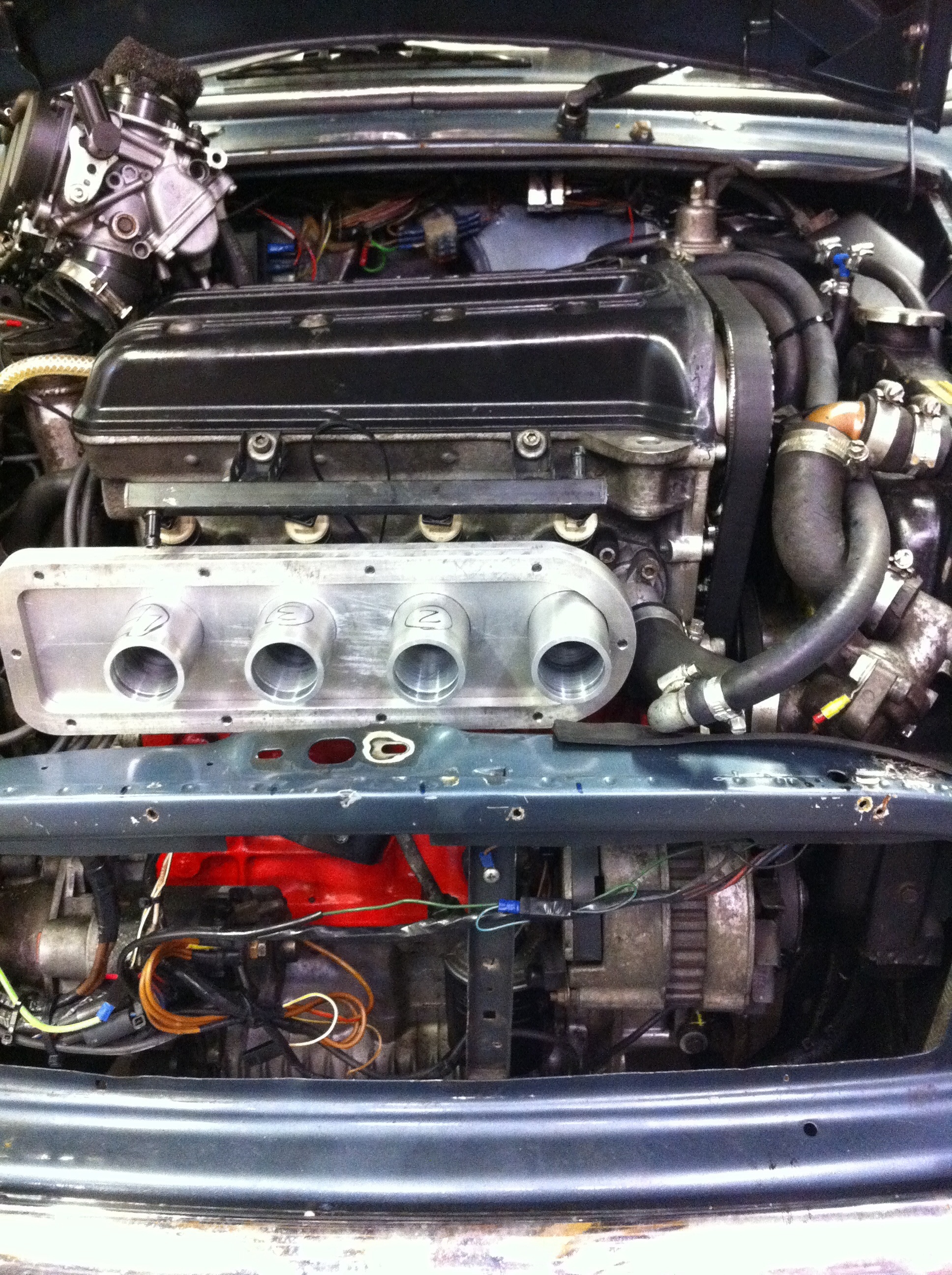

Pics of plenum for you jimster
Nick king
65 Posts
Member #: 9646
Bristol England

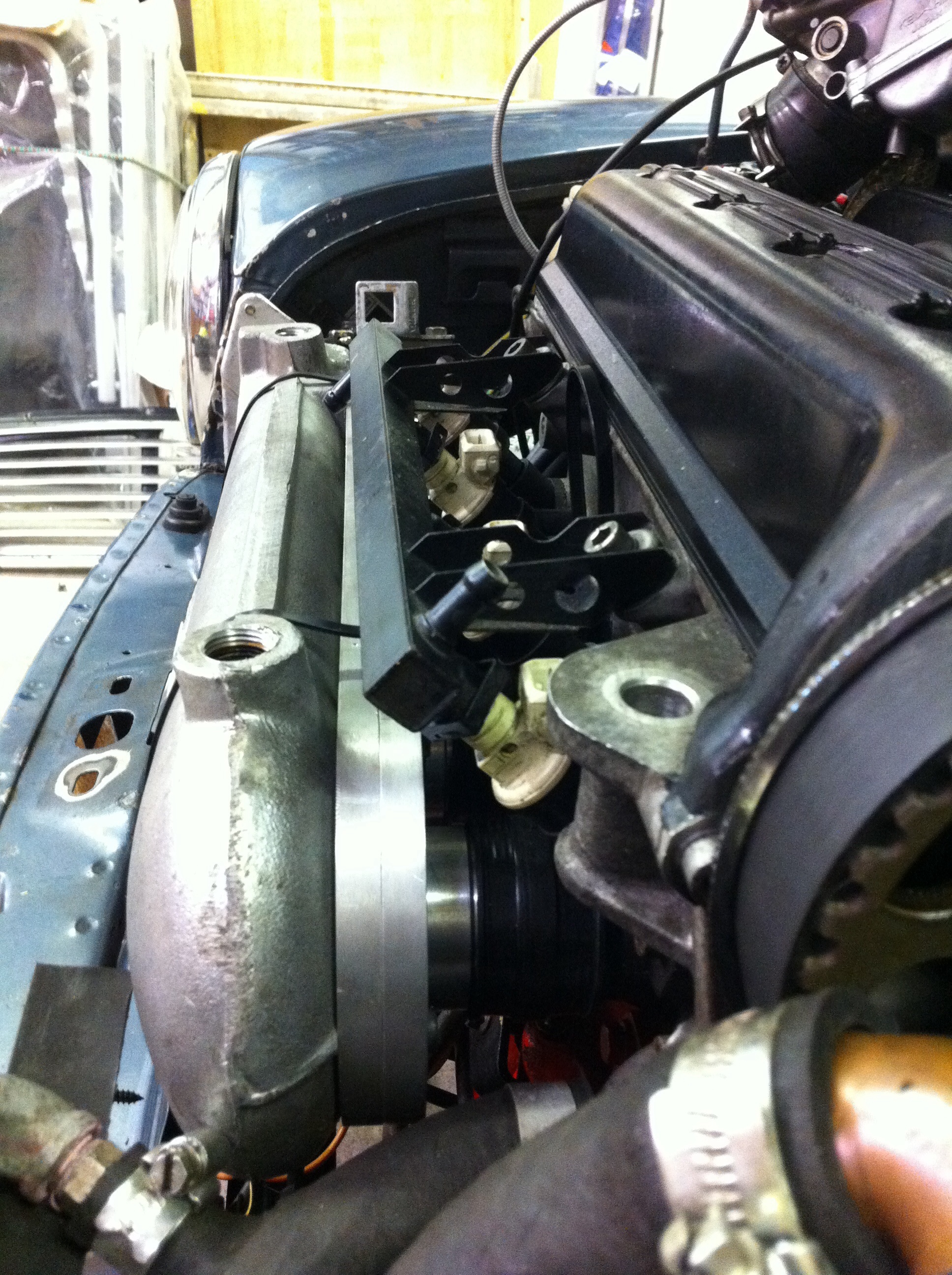

And there's more
The last pic is from this week when I had it apart fitting the clutch. I've added trumpets to see what difference it makes, it seems to be running richer at idle ,although I've not done any real testing yet.
You could add a pc fan or two to that IC to aid low speed/high rpm driving *wink*
I'm also loving the 'If it works it doesn't have to be pretty' attitude you got going on there!
